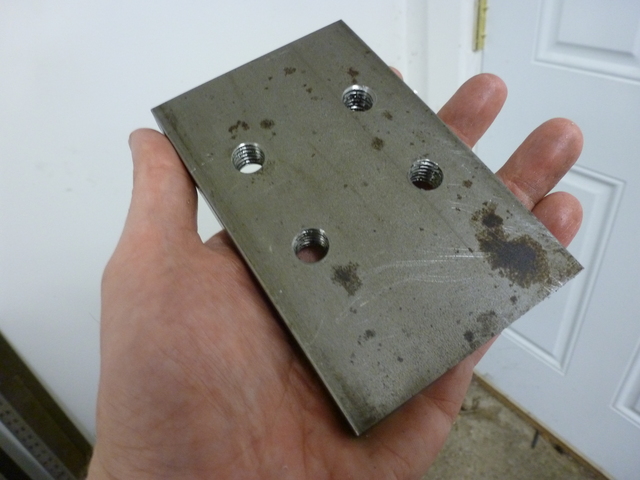

A lot of us here probably have the inexpensive 4x6 bandsaws that are so
readily available. As has recently been pointed out by another poster here,
one of the drawbacks of these machines is the limited utility of the vise,
especially when attempting to cut small or irregularly-shaped stock.
I subscribe to various mailing lists related to my machines, but often find
myself deleting most of the mail without looking at it. Recently I saw a
subject line from a mailing on the 4x6 bandsaw list that caught my attention.
When I read the mail, it was a real head-slapping moment (i.e. "why didn't I
think of that?"). I took what I read and ran with it, and shown here is my
take on the idea. Not a lot of words are necessary.

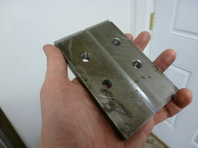

1/2-13 tapped holes for Bridgeport-style clamping hardware.
Both sides are usable.

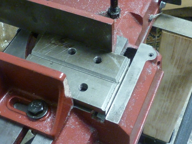

In the saw's vise.

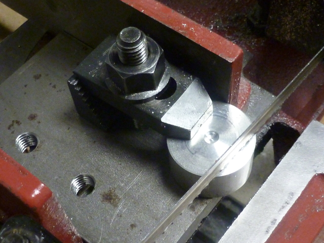

A contrived situation staged for the camera, but illustrative of the concept.

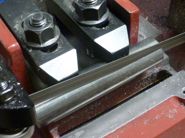

I wanted to thin down a round piece of 1144 stressproof for a crankshaft, yet
save endmill life, and save a little 1144 stock for other purposes.

Very good. And with a V block it will hold round shorts the other way too.  Must get at that for the
school shop soon. Often have shorts of brass that can be used for even "shorter" things. :-)

...And I just used mine again today. It's probably not worth mentioning among this crowd, but each individual will find his own best arrangement of holes, and it might be best to start with a minimum and add holes as needed. I make no claim to the idea, but I think I came up with the idea of adding some v-grooves on my own. I'm glad I was able to spread it around.

« Reply #14 on: September 09, 2012, 07:00:26 PM »
Tim, I meant to ask how you got the bandsaw blade to cut into the side of the round bar as in the last photo you posted.  Given half a chance my saw blade would want to slide down the side of the bar rather than cutting where it should.
