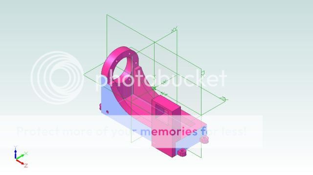

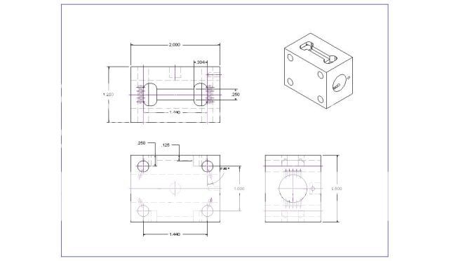

Yes, Jo. That is a cylinder drawing under the pieces.  I have not posted drawings in the past for two reasons.  I have no training in proper drawing and dimension positioning.  I tend to produce working drawings from the 3D model with detail limited to the procedure at hand rather than a complete drawing with all detail and dimensions.  Here is an example of what I took to the shop for the general development of the cylinder.  Note that there are no bolt patterns and that some useful dimensions may need to be derived.
If I don't get to many complaints about this style, I will try to provide more examples.
If this drawing does not display, it may be a problem with Photobucket.  I have been fooling with it for over an hour with unreliable results. I will work on it tonight
If anyone wants more specific information that is shown, just ask.

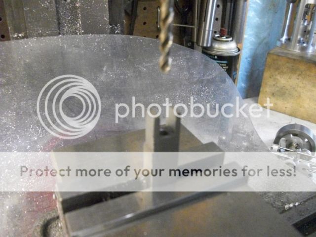

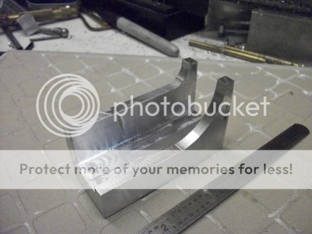

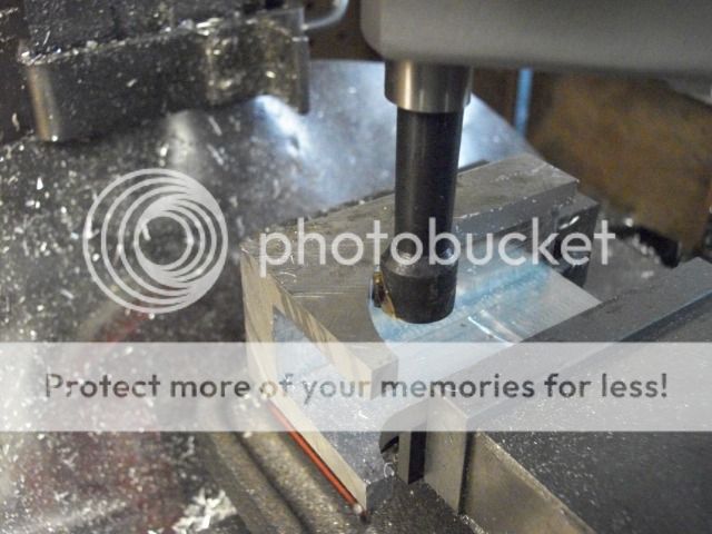

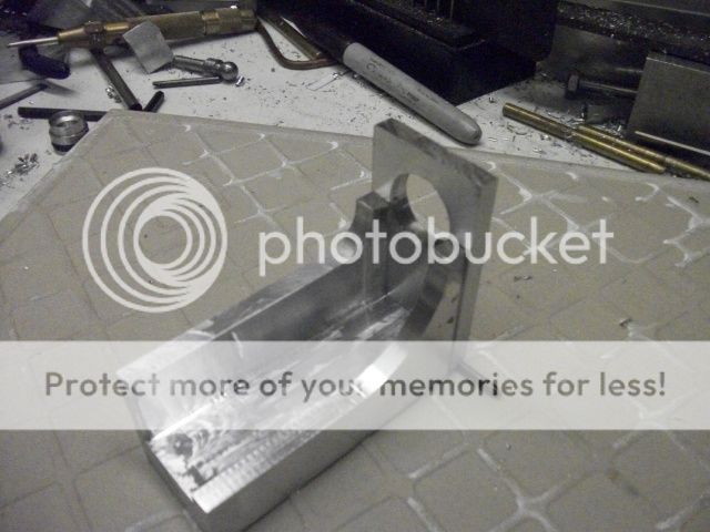

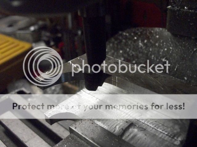

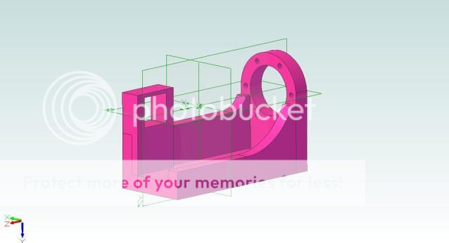

I set out today to make this:
I was not sure how I was going to go about it.  I had already decided to make it in three pieces, front plate, bearing support, and base channel, and JB them together as one.  Milling the deep wide slot it the base channel was just a lot of heavy milling with a 3/8" end mill.  The question was how I would go about the large radius.  While I was thinking about it, I decided to change the design.  The Tangye style has two different radii.  This provides more support for the bearing support with a higher wall section on the bearing side and good access to the crank with an open side, so this is what it wound up with:
The sweeping curve was no problem at all.  I used a boring head in the X2 mill.  I set the radius of the cutter by eye.  The dimension is not critical.  With the part clamped in the vise, the spindle was centered appropriate bore center and the X an Y indicators zeroed.  Then I backed of in the Y axis until the boring too just touched the edge of the part.  I then made repeated cuts, rasing and lowering in the Z axis, moving the table in the Y in increments of about .030" per cut.  When the Y indicator reached Zero again, the boring head was replaced with an endmill and the long edge milled tangent to the curve.  The small radius was done in much the same way except that I used a 3/4" S&D drill bit instead of the boring head.
I still need to profile the top edge of the front plate and work out the details of the bearing support.

Hey Jerry, I appreciate your drawings, they show what's going on just fine and really help with following what you're up to. I hope you keep posting them!

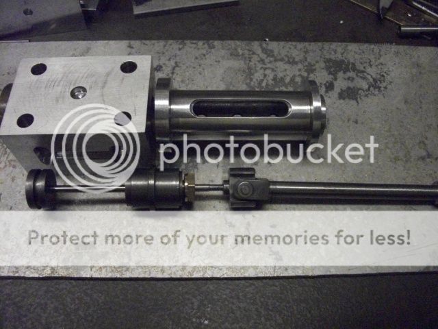

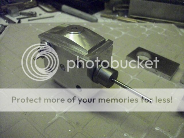

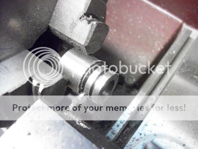

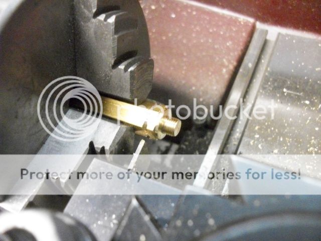

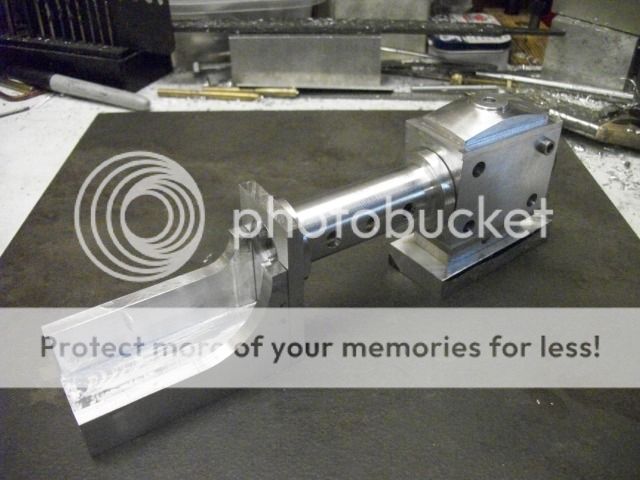

I took a few days off to do some other stuff but I got back to it yesterday.  I didn't have time to post anything last night but this is what I got done.
The bearing stand is worked out along with the cap.  I decided to go with a cast iron bushing instead of oilite or split brass.  It may not be proper but I have found that it gives very good performance and wear.  I have not bonded the three pieces of the crankcase together yet.  They will be screwed and glued as per George's suggestion above, thanks George.  I decided not to fix the position of the bearing stand on the base until I had worked out the lengths of the piston rod/conrod combination and I think I will make the crankshaft first as well.
Yesterday, I also worked out the piston, rod, and crosshead.
Piston - Cast iron:
Head - Rod end - Cast iron
Packing gland nut - Brass
Con Rod Fork End - Cast Iron
Everything except the crank end:
That's it for today, more tomorrow.

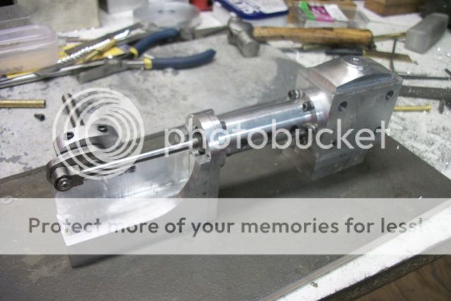

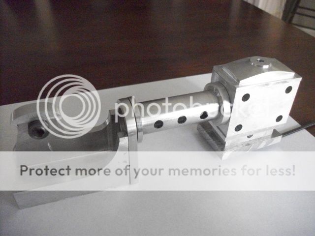

« Reply #29 on: September 14, 2012, 01:29:02 AM »
Chuck
Thanks for tuning in.  I understand that you have a few things going on in your shop as well.   This engine style has always appealed to me because it is so clearly obvious what it is to anyone who has an interest in steam engines.  BUT!! there is a lot of it that is not really very different from any other steam engine.  It has a piston moving in a cylinder, guided by a cross head in a guide with connecting rod turning a crank and a flywheel.   The only thing that is really different is the valve mechanism, and there is a whole lot of difference there.  I am going to take the simplest possible approach to this, hoping to create a working 4-valve mechanism driven by a single eccentric through a wrist plate mechanism.
If it works out, and if I learn anything useful, this will be the first of a series.  There are many refinements that could be added but first, the basics.  Cylinder, piston, cross head, con rod, crank, flywheel.  I am almost there, but not quite yet.  Here the frame is bolted together and I am about ready to decide on a base plate so that I can setup the outboard bearing stand.  After that, I will get the pieces working smoothly before tackling the valves.
For those that see the Socket Head Cap Screws and cringe,  they are only a convenience for the anticipated assemble/tear down/assemble cycle to follow.  I intend to go to studs and nuts on final ( :Lol: ) assembly.
