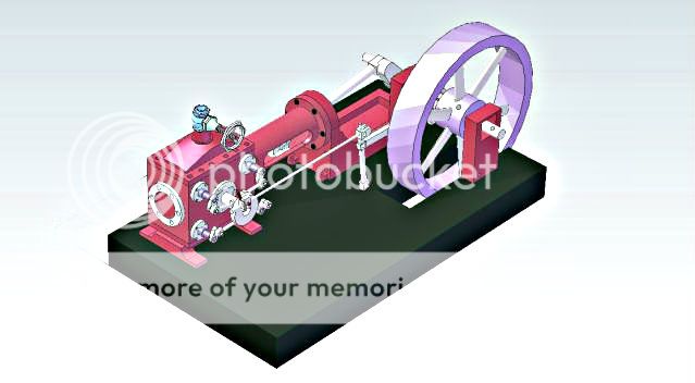

This is what my design looks like at this point.
I am using Alibre' 2011 for all 3D modeling and 2D drawings.  The details of the design may change as the build progresses but I will
try to post updated details as they occur.

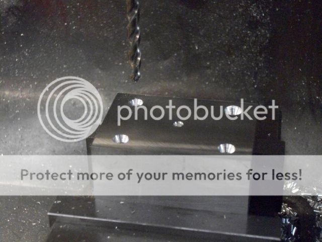

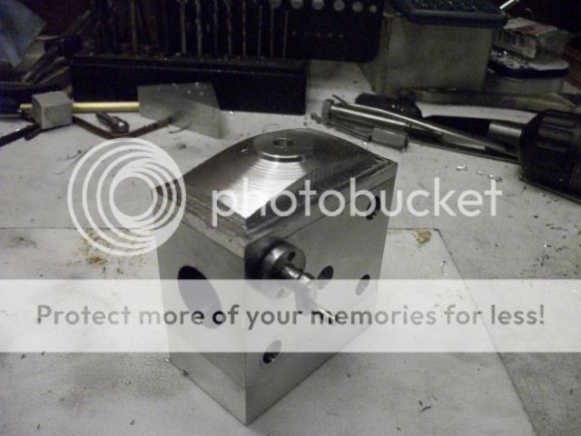

I actually got some work done today.  I started with the cylinder because it offers the most new challenges. The first thing is to get the stock to size.  The finished size if the cylinder block is 2" long by 1.5" high and 1.25 wide.  I used my table saw to get the stock to rough oversize:
And then brought it square and to dimension with a flycutter. I then used my edge finder to locate the center of the face to drill for the wrist plate pivot and the four valve bores.
The valve bores are .25" diameter finished.  I located them from the center point and and then drilled 3/16", 7/32" and 1/4".  I know from previous use that this 1/4" bit produces undersized holes which will be reamed to size in a later step.  The last operation in this setup is to return to the center and drill a flatbottomed hole with a 1/4" end mill for use as a locator for the wrist plate pivot.

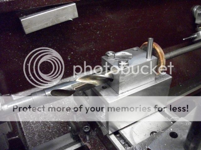

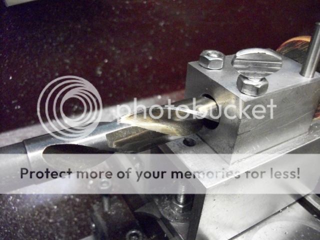

The next step is to bore the 5/8" cylinder bore, centered in the end face.  I do not have a lot of confidence in ability of the X2 mill column and dovetail slide to stay vertical for this operation.  The bore is 2" deep and there is enough flex in the column to give problems, even with a boring head so I decided to do this job in the lathe.
That is a piece of 2" square aluminum tube bolted to the lathe cross slide.  The cylinder block is bolted to the square tube with shims to bring it up to height.  It was set parallel to the lathe ways using a dial test indicator swept against the far edge.
The part was centered horizontally using a center finder to locate frond and back faces and the dimension divided by two, just as you would do on a mill table.  Sorry, I forgot to photograph this operation.
The hole was pierced with a 3/16" drill bit and the progressively opened with 1/4", 5/16", 3/8", 1/2" and 5/8" drill bits.  For each of these operations, the tailstock feed was used to  drive the part into the drill bit to avoid any off center forces that would cause the part to lift or twist.
The final passes of the 5/8" bit were driven by the carriage feed lead screw with the bit rotating at 2000 RPM and well lubricated.  The end is as good as or better than I have ever been able to achieve with a boring bar.  Honing with abrasive will be done later.
The final job before leaving the shop for the day was to put a tapered top face and spigot on the top plate and to mill a rebate on the edges for hold down bolts.

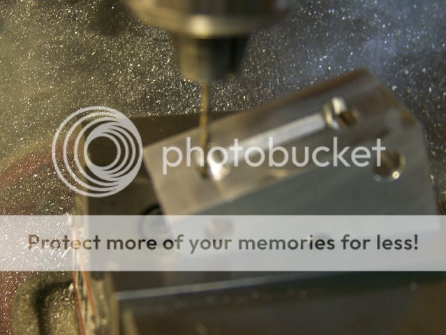

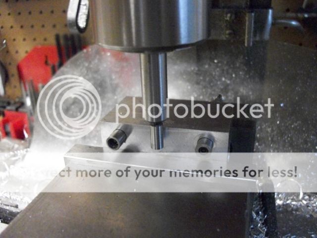

Yesterday, I got the cylinder and the valve bores located and drilled.  Todays big job is to mill the steam and exhaust passages and drill the passages from the valve bore to the cylinder.
In this picture, the cylinder block is set up in the mill vice and the edge finder is touched to the front and back faces to locate the longitudinal axis.  Two steel shafts are inserted in the valve bores and located with the edge finder to get to the center of the top face, where the X and Y readouts are zeroed.  I find it much easier to work from a center reference than from an edge when working with a symetrical layout.  All offsets are identical left/right and fore/aft with just a +/- sign change.
I used a 1/4" end mill to mill a longitudinal slot from one valve bore to the other.  I had set the depth by touching the end of the cutter to the top of one of the rods and setting a depth stop on the mill column.  The slot is milled from the midline of one valve to the midline of the other.  I took three passes, increasing the depth until I hit the preset stop.  I then milled a cross slot at each end after increasing the depth of cut by .125" so that it bisects the valve bore.
The block was flipped over and the process repeated on the bottom.  This is way easier than I thought it would be.  Now it is time for the passages from valve bore to cylinder.
The cylinder block is tilted 17.5 ? using a protractor.  Close enough is good enough for this angle.  In order to be sure that the passages are on center with the valve, an edge of the rod is located and then the table offset to the center of the bar.  The parts are drilled 5/64" to intersect the cylinder bore.  I drilled 5 holes, one on center and then two more offset .080" and .160" to the rear and two more offset to the front.  This process was the repeated for each of the valve bores and my mother's brother preferred to be called "Robert" but you get the idea.

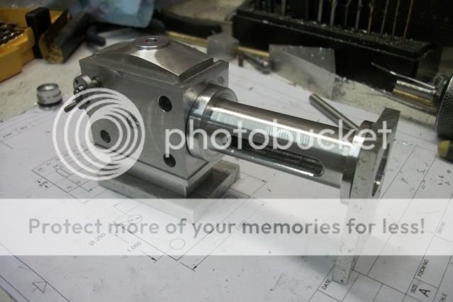

So I did something else.  The trunk guide has been rattling around in the back of my head, trying to get comfortable.  I have never made a trunk guide before and had only a general plan of operation, but today, I had no fear.  I was so jazzed on coffee that I was almost finished before I realized that I hadn't taken pictures.  I'll try to describe the steps.
I used my table saw to get aluminum stock to rough size.  1.25+" x 1.25+" x 2.125+".   A 4 jaw lathe chuck might have been usefull now but I don't have one so I set it up between centers to turn it into a cylinder 1.25"diameter x 2.125" long.  Now, I could hold it in the 3-jaw and using a progression of bits, open the bore to .625".  Then I had to deal with the details of each end.  The crankcase end has a spigot that joins it to the crankcase that is .750" diameter, and the cylinder end has a .750" diameter recess that joins with the rod end head/piston rod guide.  These must be turned while the part is 1.25" diameter, so it can be held in the 3-jaw, without tailstock support.
With these two features done, the part was put back between centers and the body turned to .825" diameter, leaving flanges at either end.
The final operation was to cut the slot on the front side and the maintenance holes on the backside.  On to the mill, centered and located.  The slot is cut with a .25" end mill and is 1.5" long ( 1.25" center to center) and the the edges beveled using a .375" round nose end mill.
That all. Nothing really spectacular or unusual.  This is what It looks like:
The disk in the last picture is from the scrap box. It is 3" diameter.  It looks to small.  I think it needs to be at least 5" diameter.  Opinions Please!

I agree about the flywheel, looks like it should be bigger say 4" dia, also most of them seemed to have a fairly large axial width and heavy rim relative to the diameter.
