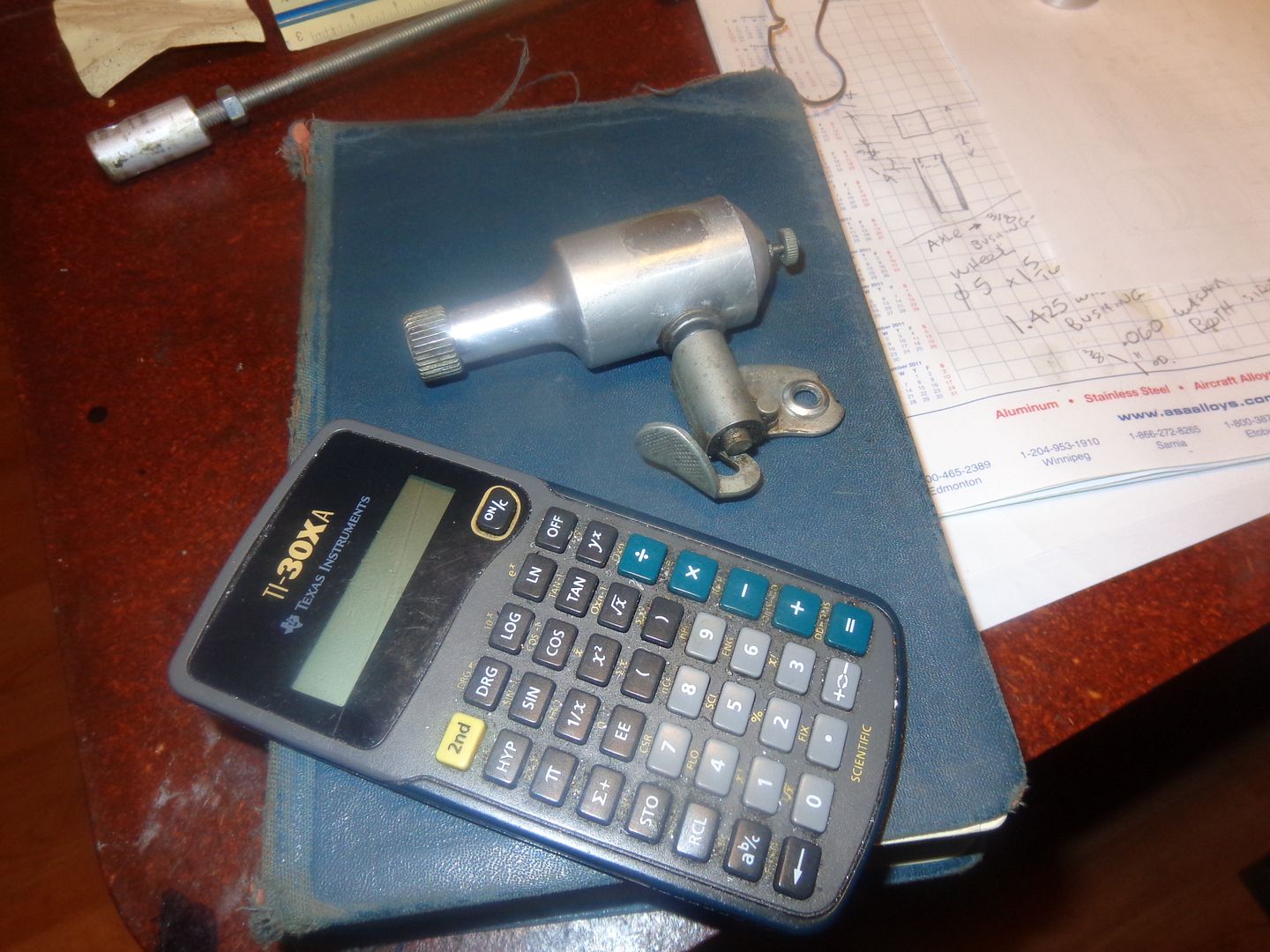

I think I'm going to try something different this time, rather than using my old tried and true early Chrysler ignition points. I've seen a couple of builds now where people have used Tecumseh ignition points which can be operated by a pushrod, rather than having to ride directly on the ignition cam. I can see where that would open up a world of choice in terms of where the points could be positioned on the engine. If anybody knows the model number or part number for these Tecumseh points please let me know.

Hey, Brian, how about considering a hall sensor ignition.  That also gives you a lot more options on where to mount stuff.  Hall sensors are very small and cheap and can be triggered by a 1/8" diameter, 1/16" thick neodymium magnet.  The circuit can be powered by 3, AA cells which will last a very long time.  Since they don't require much power, you can trigger them from a crankshaft mounted magnet instead of the cam if it's more convenient.  This makes them fire every revolution, but doesn't cause any problem.

Chuck--For me to buy all of the components from Roy Scholl or a similar supplier, ends up costing me about $100 for all of the components, batteries, switches, etcetera, when I go the magnet/hall effect sensor route. If I just buy points and condenser and a switch, it costs me about $20.00. I have my "coil in a box" that readily transfers from one engine to another, and a small wet cell 12 volt garden tractor battery that does the same. It's just a matter of economics.---Brian
