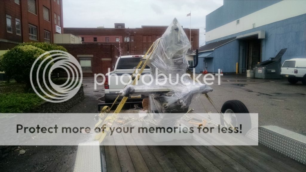

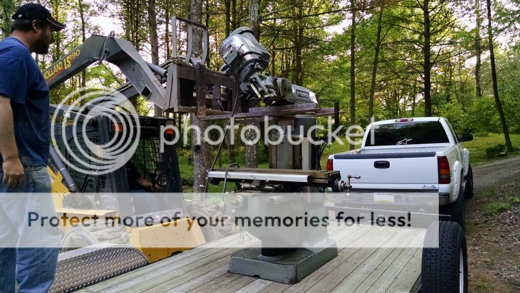

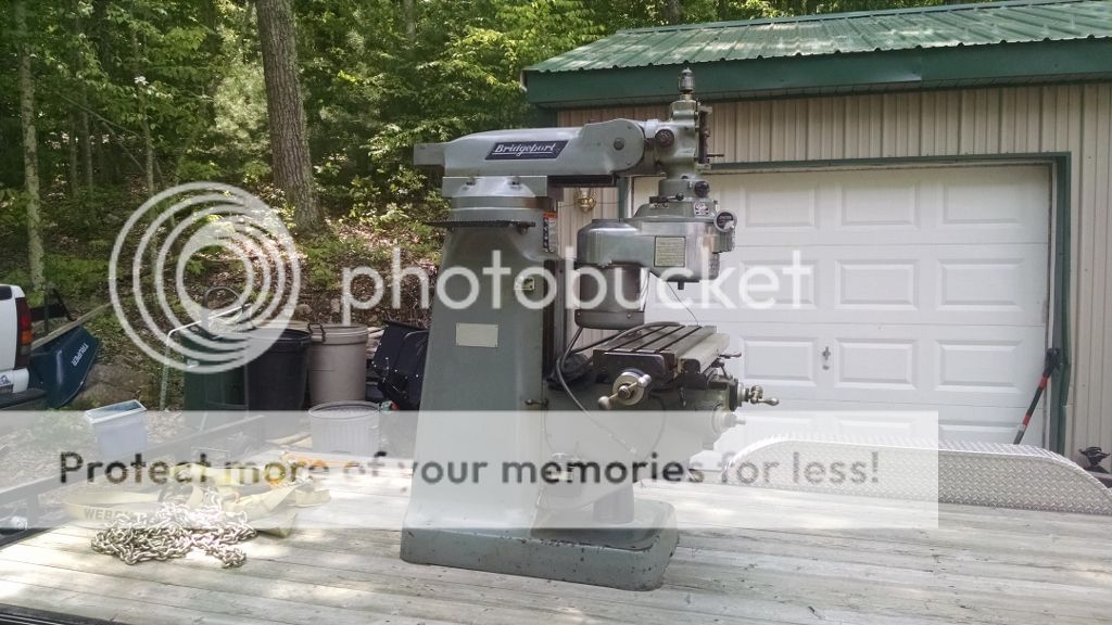

To lower the center of gravity of the top heavy machine, I lowered the knee all the way down and turned the head upside down. The machine loaded on my trailer, it got a generous treatment with a roll of shrink wrap. This will keep the road dirt and grime off the machine.
To tie the machine down, I used a set of chains around the bottom of the column. In addition, I put ratchet straps over the top of the machine. None of the chains or straps are putting any load on any of the lead screw or ways.

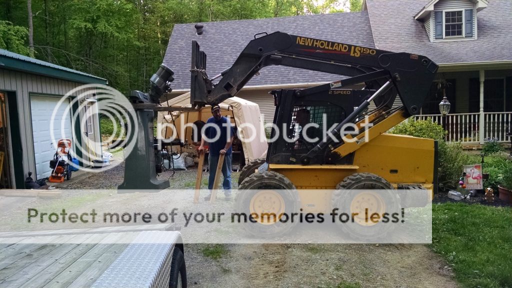

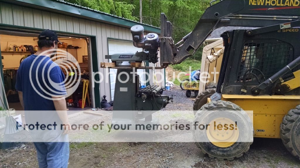

To offload the machine off the trailer, I got some help from my friend with his skid steer loader.
Bridgeport style machines can be easily lifted with the forks under the ram. First, we grabbed it from the side, to get it off the trailer. A second setting from the front, with a couple of 4x4's across the forks, to move the machine into the shop. Once the machine was inside, I used a set of machinery skates to move it to the back of the shop.

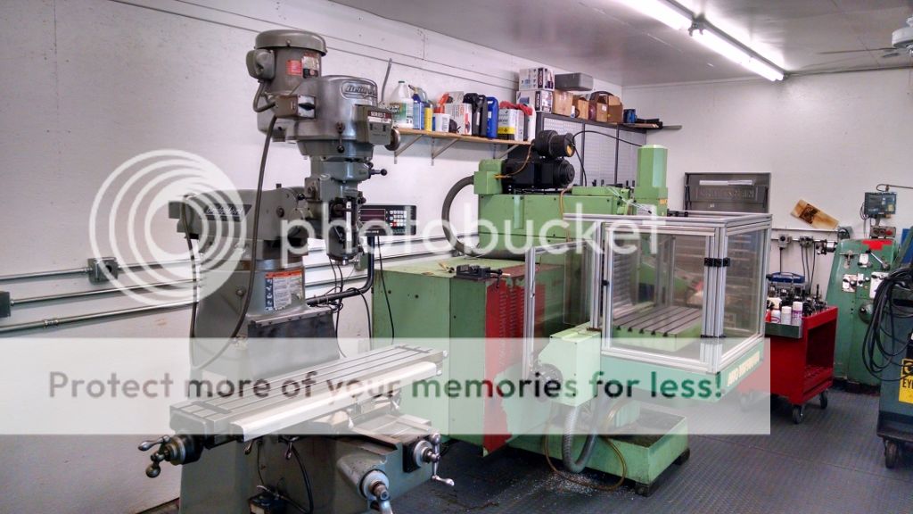

The machine in its place, next to the Maho mill.  :cartwheel:

Nice job and pictures ! Smart rigging for the move.  Wish I was there to share in the excitement.  :cheers:
Glad they mounted the readout scale on the front of the table. No lost "y " movement and no crushed scale.  :o
