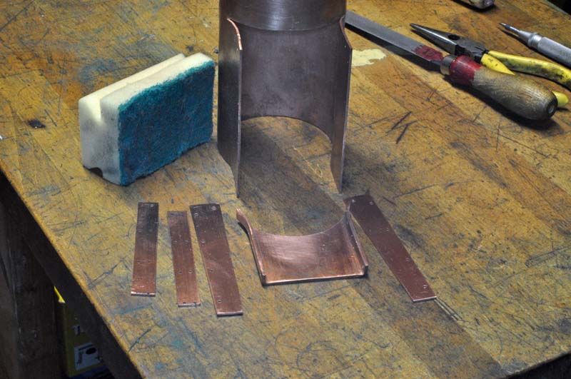

Hello again folks.  Mrs T and I seem to have had rather a lot of holidays this year  8).  However, some boiler making has taken place so here is the progress to date:
You'll remember that I bought a boiler kit that included the main tube, all the necessary ready flanged plates, the boiler tubes, various bits of copper plate and bronze for the bushes.  The main tube needs trimming to length and the ends squaring so the first job was to make a pair of good fitting plugs from some scrap beech.  Roughed out on the bandsaw.
The bolt is used as a centre for trimming the plug to a good fit
I took the opportunity to scribe 4 lines at 90 degrees to each other to act guides for the various bushes that will be brazed in (note:  for the purposes of this thread, "brazing" means using silver solders with melting points of 600C plus.)
One end of the tube needs to be opened up to provide the vertical sides of the wrapper.  The plugs were pushed into the tube to provide support to stop the tube being distorted by the vice.  I made the 2 saw cuts with a nice new 32 tpi blade in a hacksaw.  I wa quite surprised how much the residual stresses in the tube have opened out the saw cut on their own.
This is my brazing hearth.  I've got a Sievert propane torch with various nozzles, you can just see the one I used in the bottom of the picture - plenty of heat available from that one  :o.  The first annealing heated the tube to dull red.  I'd forgotten how malleable it becomes once annealed.
The wrapper cheeks were opened out with the aid of this pistol action clamp - very useful
Then tweaked a bit by hand
I used one of the firebox flanged plates as a former
The bottom ends of the wrapper need extending by adding a piece of plate which is brazed to a butt strap.  The assembly will be held together for brazing by a few 1/16" copper rivets so holes need to be drilled for these.  As I mentioned, the copper is now very soft so good support was needed to drill the holes.
These show the assembly, temporarily held together with 10BA nuts and bolts.
More to come  :)

The throat plate needs fitting to the barrel.
So after scribing a line from the barrel
I clamped the plate to the drill table which I was able to adjust to give me a good working height and used a piercing saw to cut out the profile
After some work with a file, the throat plate protrudes just enough to give a good butt join for the braze to penetrate
The sides of the throat plate were then joined to the wrapper sides with some more 10 BA screws
I used the backhead to guide various bits of trimming and folding to get everything close to the correct shape
These are all the bits ready for the first braze.
I've purchased 2 grades of Silver Solder:  38% Ag which melts between 650 and 720C and 55% Ag which melts at 630 - 660C (we're cadmium free here in the EU).  The idea is to use the higher melting point solder for the initial steps and the lower one when joining the various assemblies together.  I replaced the bolts with copper rivets and just bent the rivets over rather than forming proper heads - the idea was to just keep the assembly together rather than squeeze everything tight.  I applied high temperature (HT5) flux to all the joints and brazed away. (sorry, no pics - too much juggling of hot stuff)
Looks a mess but penetration of the braze looks good so I'm quite pleased.
