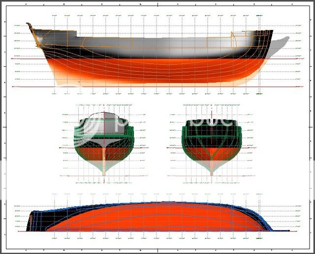

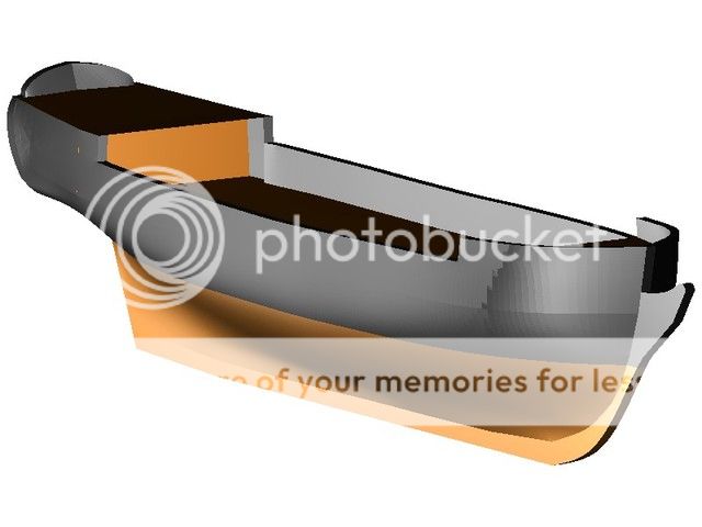

« Reply #21 on: May 11, 2016, 02:37:33 AM »
Hi Zee,
Yes it's doable.
1st up you need a program such as Delfship which has a free version and you also need a reasonable lines plan, (Hull Profile midships, Hull Plan at main deck level and Body Plan or end on view of the hull)
You use these in Delftship to produce a 3D model of the hull.
This hull can then be run through a subroutine to produce developed plates as well as stations on which to mount the plates.
If you want to proceed let me know and I will help where I can.

« Reply #25 on: May 11, 2016, 03:19:55 AM »
Thanks Paul. That means a lot.
Jerry...good to have heart.
Bob...thanks! Don't be surprised if I call on you. I did play with Delfship. Given what you said...I'll have to have another go at it.
Chris...I'll stick with Beagle. I may get a twofer.  :lolb:
It'll take some time. Things are getting in the way of machining...but I have drawing time.
Wild hairs have a tendency to fall out on their own...but this one sure seems to be tenacious. Like I said...I can't stop thinking about it. The definition of passion. A vital ingredient.

Hi Zee,
Thanks to a German colleague on another forum I have managed to find what is best termed as a set of generic plans for a Cherokee Class Brig!!
I am now processing this and previous information through Delftship, taking quite a while but at the end I hope to have sniffed out a Beagle.
Will post more when I have a result.
Regards

Wow. Very cool Bob.
I didn't know this would be catching.  ;D

Hi Zee,
Well I've beagled away for a couple of hours or so and come up with a shape that I'm reasonably happy with!
The attached are for your comment.
The fbm file is the Delfship file.

Thanks Bob!
I took a quick view. I'll spend more time on them this weekend.

Well, that's better
Attached are some files I hope you find useful.

The attachments look awesome Bob.
I can't wait to study and play with them this weekend.
