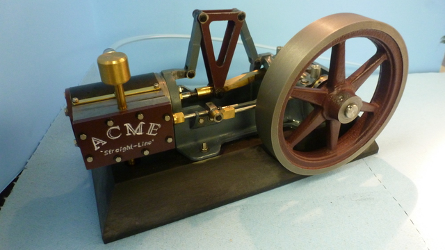

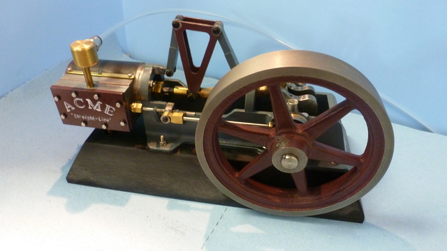

While the build log for Robby, my Roberts Straight-Line Mechanism engine, is in a somewhat unfinished state,, the engine is essentially finished. I showed it at NAMES last weekend.
Here are some shots of the engine.
And video:
<a href="https://www.youtube.com/watch?v=x3nB2itmFlo" target="_blank">http://www.youtube.com/watch?v=x3nB2itmFlo</a>
I'm painfully aware of every little (and big) flaw in the engine , but I'm overall pretty happy. I hope you like it.
Thanks for watching,

Very neat Tim!  That motion is interesting, different than the usual steam engine.
Thanks for sharing the video.  Not as good as seeing it in person at NAMES of course, but since most of us couldn't see it there, the video is great!

it's an interesting varient of the Watt parallel linkage for the piston rod guide.

Thanks for sharing your work.  As I said to Art K on his recent visit, this is a unusual mechanism which appeals to me.  Should you ever decide to make plans available for it count me in.  You did a great job finishing this engine. :ThumbsUp:  I apologize if I missed it somewhere but how did you accomplish that neat lettering?

That is beautiful Tim. If there are any flaws the are well hidden. The finish looks lovely and it runs very smoothly. Nicely done!!!

Phil, the lettering on the steam chest cover was engraved using the CNC mill. I used open source software called f-engrave to generate the g-code.
