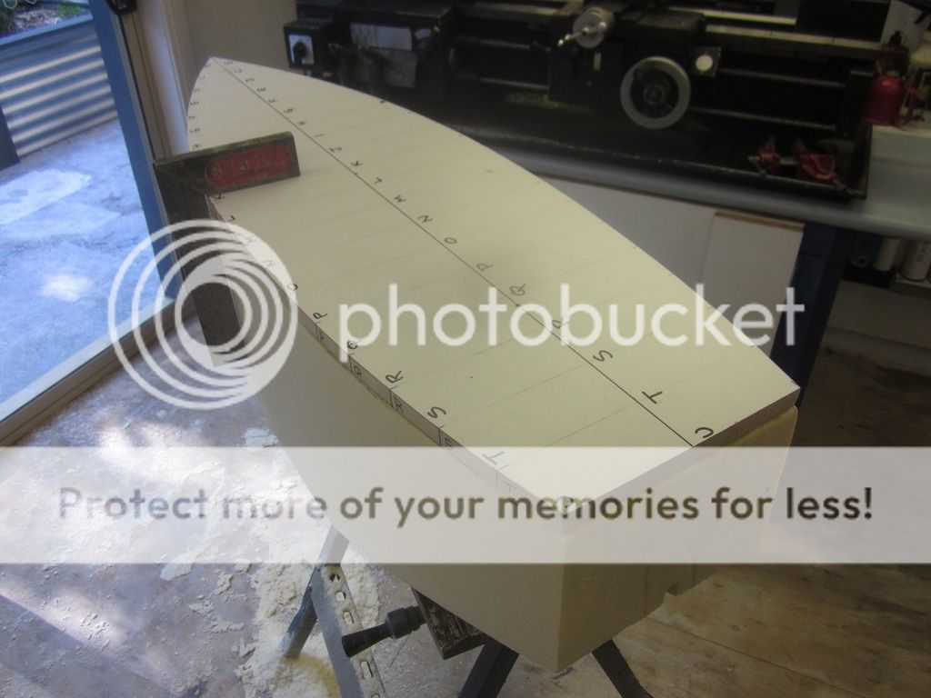

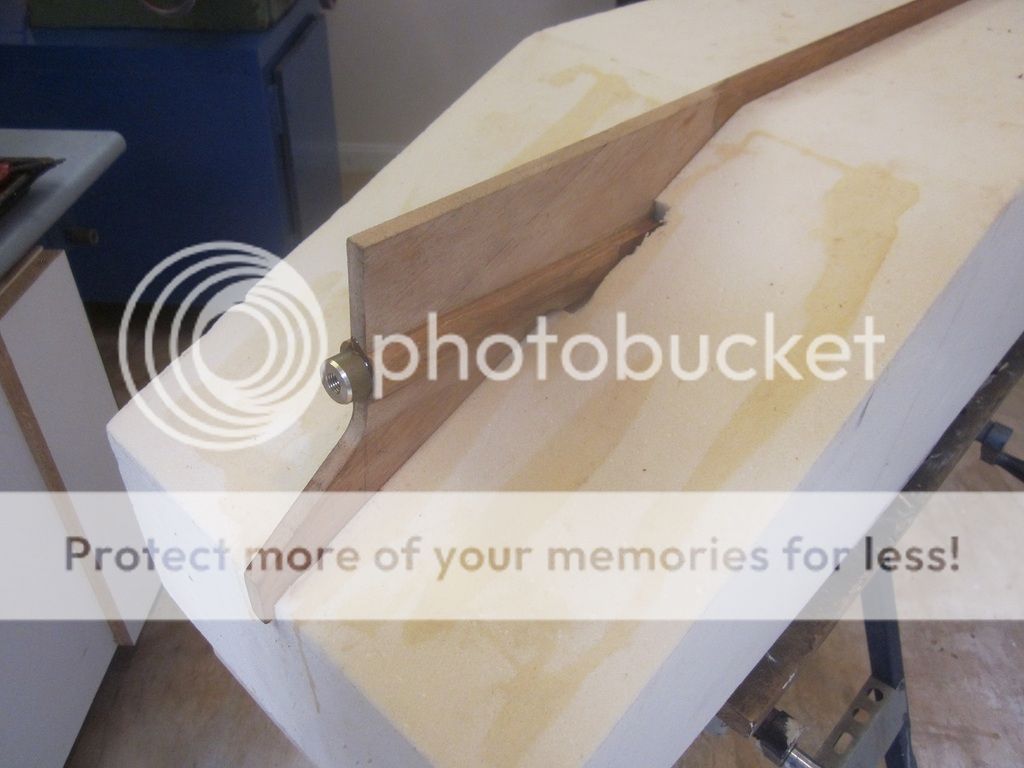

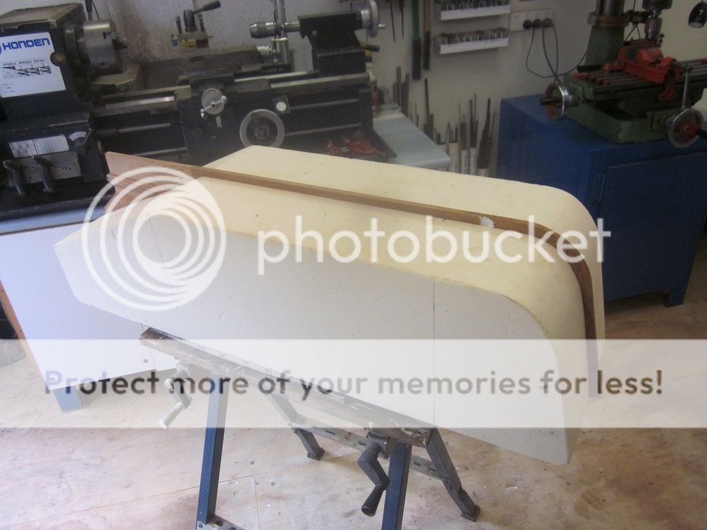

Gluing the final joint of the keel last evening.
The finished keel, apart from some sanding. Part of the keel will be visible on the interior of the boat so that will be finished in lacquer as will be the rest of the timber work. The outer part will be fibre glassed along with the hull.
The next part will be to continue with the profiling starting with the plan view shape. I propose to print out full size end view profiles then cut each one (at 50mm intervals) out of stiff cardboard and use them as templates.
Robert

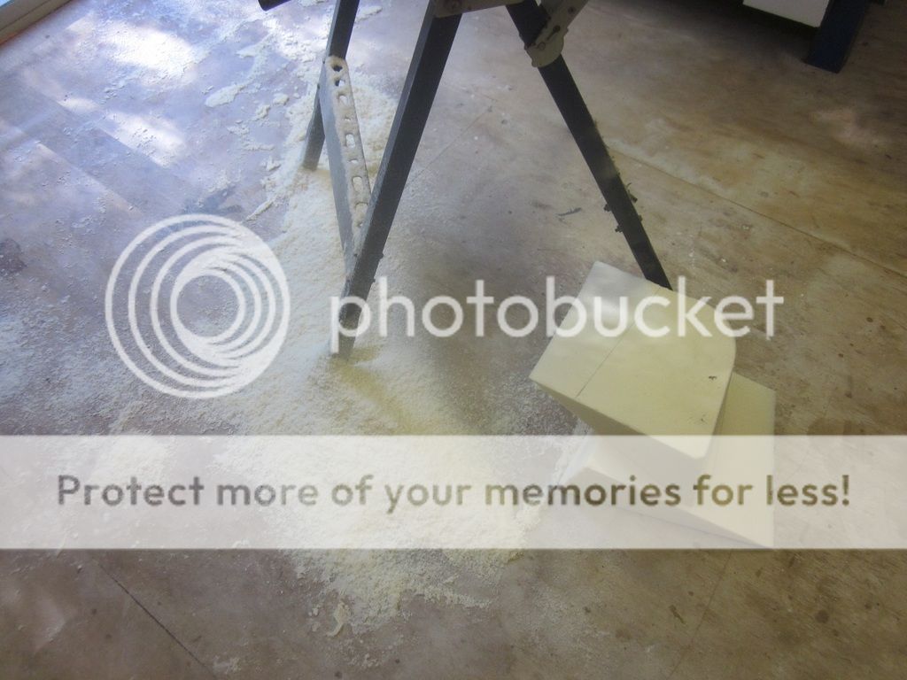

Quite right Bill  -  here's the dust
The foam cuts very easily with a saw

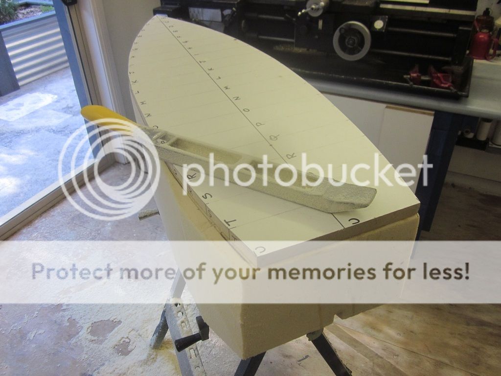

And the surform tool makes light work of the shaping.
Next is the printing of the for/aft profiles and cutting out of the cardboard templates. I will have to take things very carefully with the next operation to avoid any removal of the foam as I imagine it will be tricky to fix up a stuff up.
