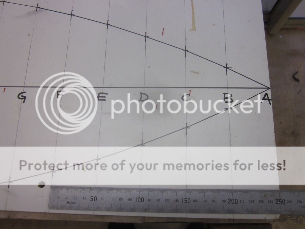

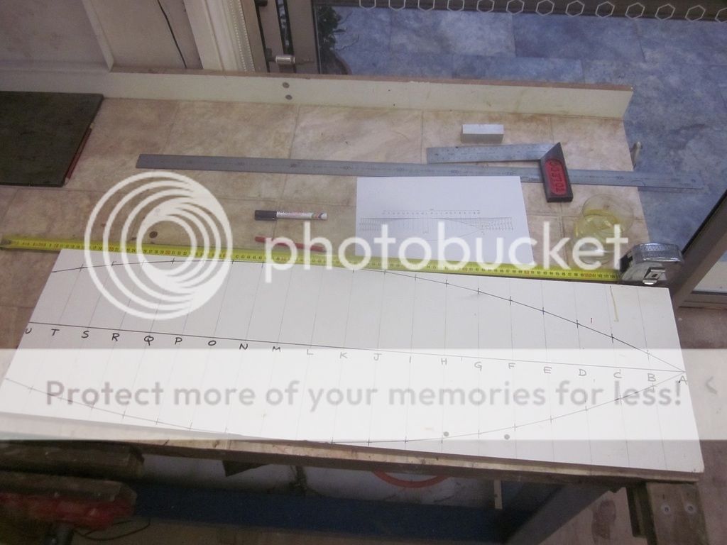

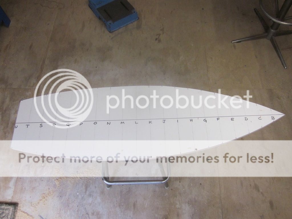

Procrastination over. I have commenced finally on the boat hull. A left over kitchen cupboard door was brought into service a base for the Urethane foam block. I will glue the foam to the base with contact adhesive, this is to provide some substantial support whilst I shape the foam. I will make cardboard profiles for each section at 50mm intervals. I have ordered the urethane which will take 10 to 12 days as it has to be specially made to the size I need - 1000mm x 290mm x 270mm.

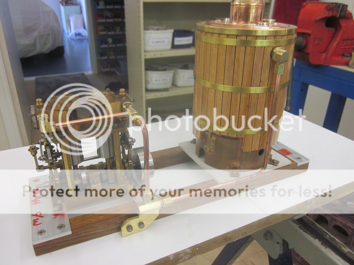

Looking forward to following the build process. Have you decided on the steam plant/engine?
Ian
Offline Robert Hornby
  • Posts: 456
  • Terrigal NSW Australia
Re: COLUMBINE - The Boat
« Reply #6 on: April 10, 2016, 12:24:38 AM »
Ian
Very much so, if you check out the engine and boiler builds in the other categories you will see them.

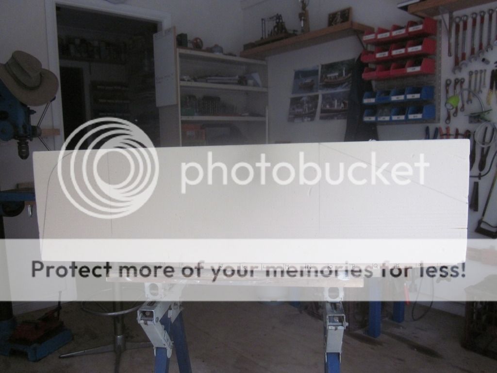

The urethane foam has finally arrived and now I am able to proceed.

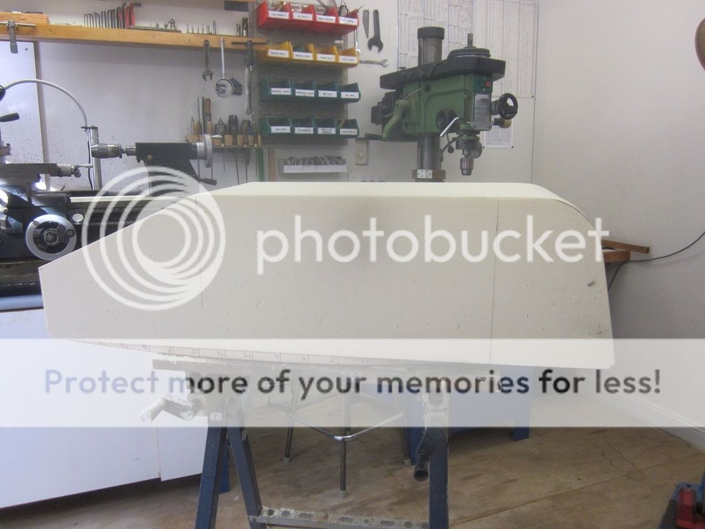

The block is 1000mm x 290mm x 270mm, the material is very soft and even looking at it too hard will cause it to dint. I glued the block to the wood pattern and screwed a 3"x 2" timber to enable me to hold it all in my work horse.
Next was the shaping the for and aft profile prior to making the groove for the keel.

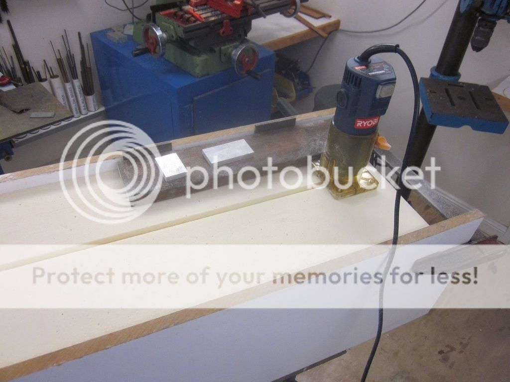

The router came out to cut the 10mm wide x 15mm deep groove.

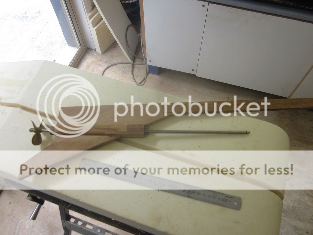

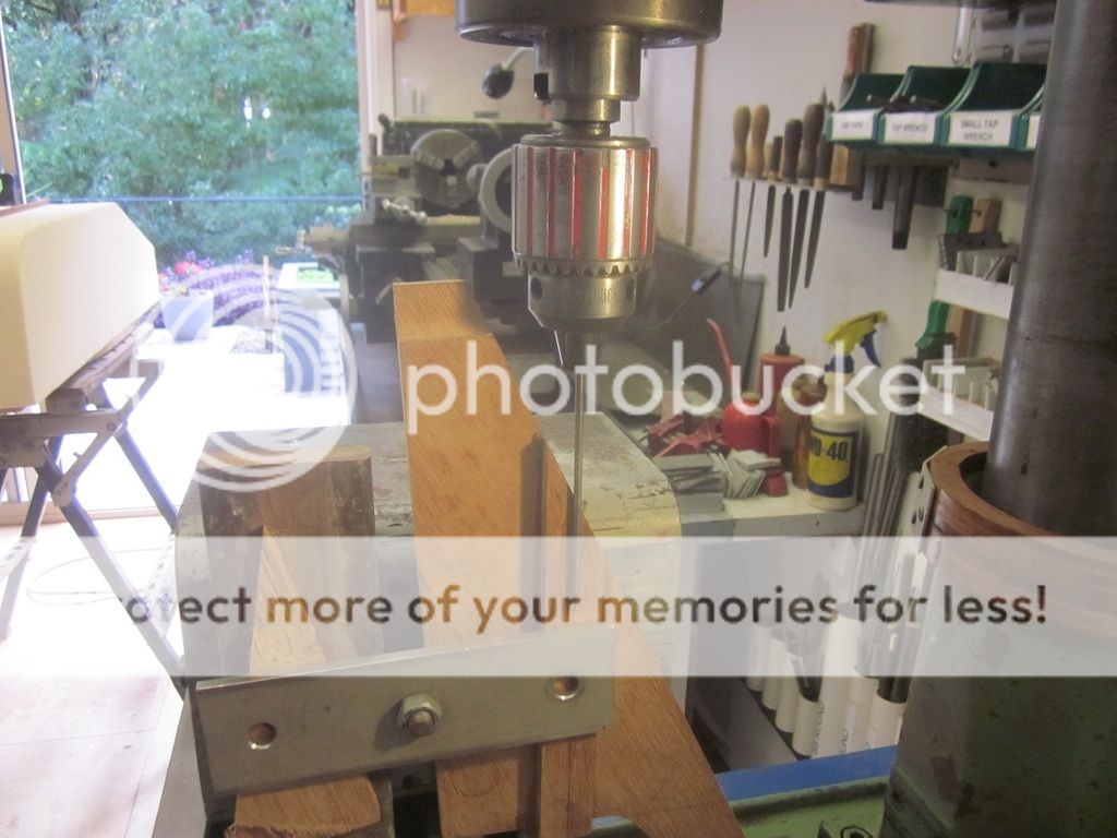

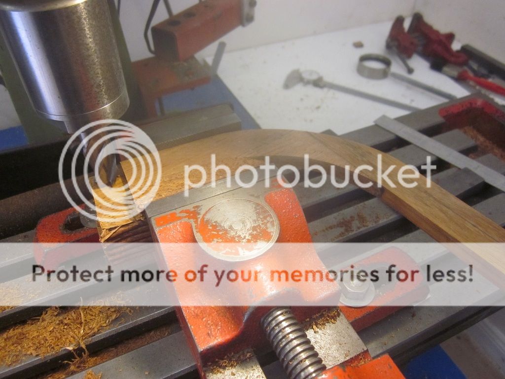

The wood keel is made up of about 10 pieces of Merbau (left over off cuts from a new deck) I took quite some time to align the aft part of the keel to drill the prop shaft hole at the required 3 degrees from horizontal, I had to drill from each end and there was only a 1mm miss alignment, which I am able to accommodate and adjust with the gland bushes.
I glued the gland bushes into the timber with 2 pack Araldite (I have used this previously with success) The forward part of the keel will be attached next then more profiling of the foam.

Robert, anxiously following along still. How did you cut the foam aside from the router groove I mean. Bandsaw? Hot knife?  Just curious given the size of that chunk of foam  :o
  • Posts: 456
« Reply #14 on: June 06, 2016, 01:15:49 PM »
Bill, I cut the triangle section from the stern with a cross cut wood saw, and then finished it off with a "surform" tool. It is like a long cheese graterer. The forward end was just with the surform tool.
It removes the foam very quickly, indeed I have to be carful not to take too much off.
