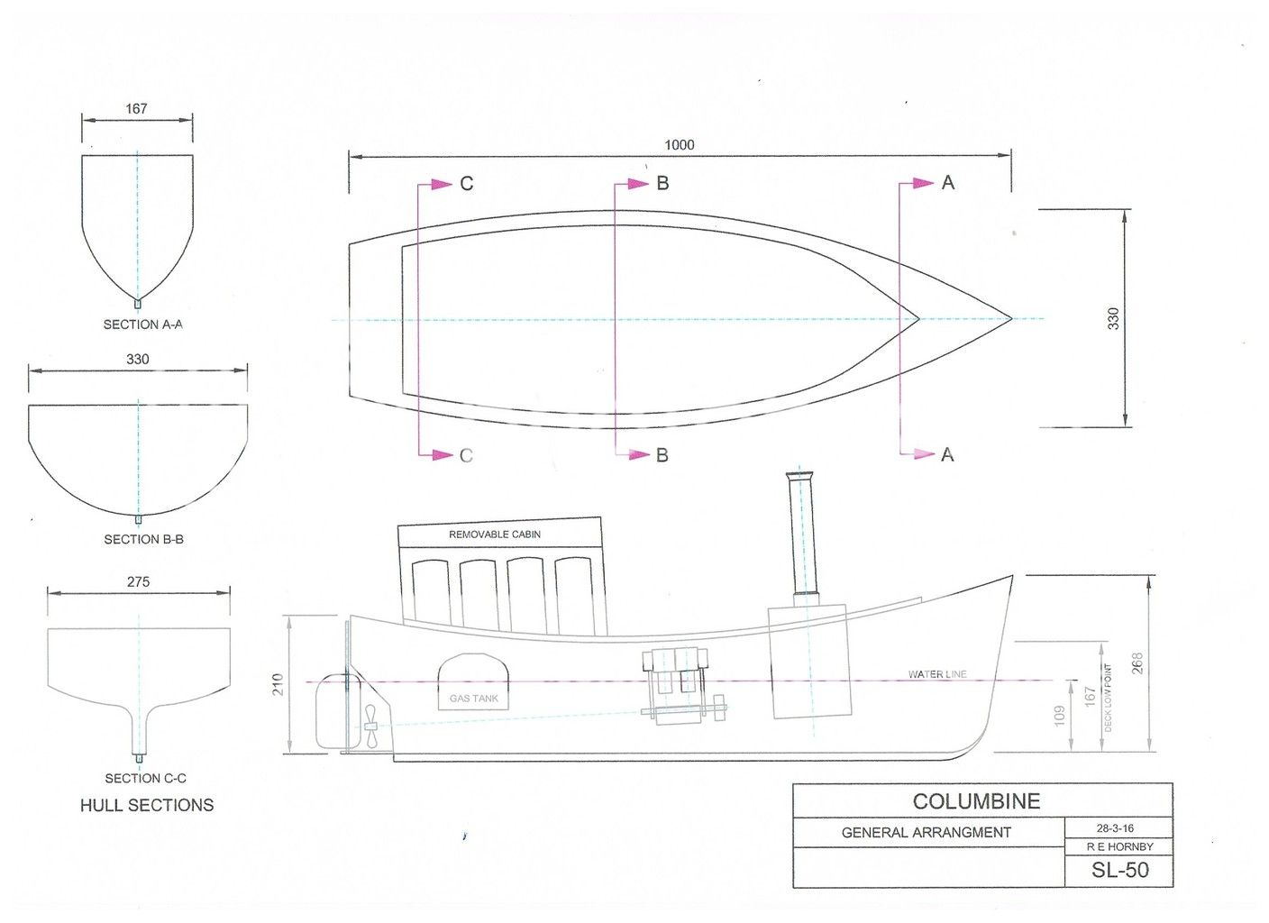

I am getting close to commencing work on Columbines hull which will be fibreglass with timber interior and decking. I have sketched up my thoughts on the hull design below the water line but I stress I have no sensible knowledge of this and am requesting some guidance on this aspect. If there is anyone out there who has experience/knowledge of hulls (the prototype was built in 1890) I would be forever grateful.

Generally Robert, a length to beam ratio of 5/1 or 6/1 is a good start with a low powered steam boat.   4/1 will work as well.
As a old very experienced boat building once told me.....with small boats...if it looks right...it probably is!
The test tank model built half that size will tell you everything you need to know...on a numeric level...not just opinion.   Check out the book....a good read!    The guy is really funny too!....

My real question was more about the general shape of the hull i.e. basically curved as I have drawn it or more of an angular design with chines? I will draw up many more sections when I get the general profile sorted.

Rough calculations so far indicate the volume of the hull under the water line is around 25 litres (give or take a few), so if the total weight of the boat is 25 kg then it should sit at the correct depth. The engine /boiler assembly weighs 7.5 kg so I have plenty of capacity in the build weight and should be able to add some extra mass at the appropriate place to get the hull to sit level.
Robert

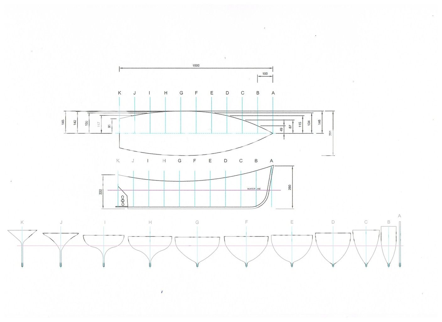

« Reply #22 on: March 30, 2016, 04:10:35 AM »
I have sketched up some hull profiles, any comments on this?
Robert
  • Posts: 1606
Re: Help required on hulls
« Reply #23 on: March 30, 2016, 04:22:55 AM »
Robert,
Honest comments from my own tastes and experience, OK? Please don't take this otherwise.
Too much shear; looks very toy-like.
Way too deep in the mid sections. It's going to take a lot to push that water.
Way too much reversal between I & J sections, will look very lumpy.
Too much rise in the buttock lines aft.
Some rocker in the keel will give better lines in the dead rise.
Rise should be flatter and the bilge firmer.
Again, just my opinions, nothing else.
« Reply #24 on: March 30, 2016, 04:39:15 AM »
Robert.....
1. from your original dimensions we see 1000*330*109 = ~~ 36 litre volume
2. your nominated displacement estimation of ~~ 25 kg would equate to a block coefficient of ~~ 0.75
Considering the fairness of your original sketches would suggest a block coefficient more to be ~~ 0.55 to 0.6
From this and you latter sketch profiles we would expect a displacement nearer ~~20 kg....
A 25% variance in vessel displacement is a large number in hull design considering the fixed values
Derek

« Reply #25 on: March 30, 2016, 06:49:14 AM »
Thank you very much for the inputs.
Pete first. The rise profile is very high on the prototype and the second photo at the start of this post is pretty much full side on and I scaled the deck line from this. I agree it does look a bit ‘toy like’ but then I would like it to be as close as possible to the original.
I do not know how to reduce the depth in the mid-section
The reversal between I and J, I will have a rethink on that one, I agree.
The rise in the aft section is pretty much as the prototype. See photo
I will change the keel to give some rocker.
Derek. Thanks for the calcs, I have reduced the beam a bit to about 190mm from the original 330mm so that will account for some of the volume reduction.
Robert
« Reply #26 on: March 30, 2016, 07:24:21 AM »
Robert...I am still unsure here
1. from your original dimensions we see 1000*330 beam*109 = ~~ 36 litre volume
2. your nominated displacement estimation of ~~ 25 kg would suggest a block coefficient of ~~ 0.75
3. revising the beam we see 1000*190 beam*109 ~~20 litre volume
4. maintaining your block coefficient [constant here] of 0.75 we see ~~ 15 kg
The confusing point is you nominate the new beam as 'reduced the beam a bit to about 190mm from the original 330mm' , however is shown in the latest plan view as  [2*144] = 288 .....
Derek

« Reply #27 on: March 30, 2016, 07:53:15 AM »
Sorry Derek, Finger trouble I meant to say 290mm not 190mm

I must apologise, Robert. I missed the fact that you had a prototype you were working from. :embarassed:
So ignore my comments as I was shaping to a more traditional hull. That said, the picture you just posted shows a very
attractive boat and I think it would make an excellent model!
I'd like to have the full size boat here!

Pete I value your input very much, is this a bit closer to what you think might work?
Robert
  • Posts: 1606
« Reply #30 on: March 31, 2016, 04:02:50 AM »
Hello Robert,
Thank you for the compliment!
Each of those sections is nice and should work, until you come aft to 'I'. It's way too cheeky to make a smooth transition to 'J' which is very hollow, then the lines come back out to the transom section.
I think what you need to do now is draw the waterlines and buttock lines. Waterlines are the lines parallel to the water and represent
where the water would touch the hull if the water were at that level. The butt lines are longitudinal sections perpendicular to the
waterlines.
You should be able to Google all that up or get a book at the library on boat design.
When all the lines are drawn you will have the ability to 'fair' all of them to make a smooth, nice, hull by adjusting the lines, a
process called 'fairing'. Anyway, it will show up the humps and hollows so they can be smoothed out.
Way more than you probably wanted to know!! It would be impossible for me to give a tutorial on laying down lines so finding a
reference book would be the best way. Is this getting too deep??
Look at the lines drawings in the link I gave you to Paul Gartside for an example.
