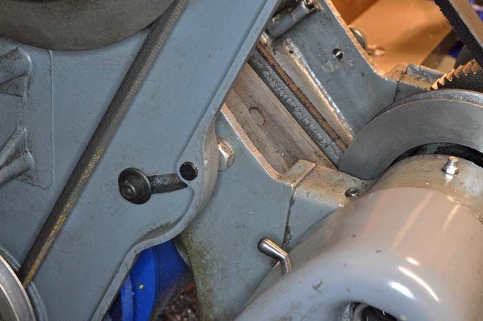

So I have a 75% complete GH Thomas Headstock Divider for my Super7B, and I have the book and magazine articles which describe how to make and use it. I'm at the stage where I need to drill the two holes in the pulley/belt housing that mount it. GHT provides a template, some measurements and a couple of sentences on how to find the positions for these holes, but I guess I'm being thick because just can't grasp what he's on about. I can't see where/how the template is used, and what the datums are referenced to!

No, it's the more basic bit of how to find the position for the two holes in the Myford's pulley casing that take the pointed bolts which engage in the square bar that the whole thing is mounted on.
Looking at your thread you obviously felt this was a simple thing because you didn't mention anything about doing it (like I said - I'm thick!). But looking at your photos can you remember how you found the positions of the holes you drilled as in the attachment?

Allen I just used GHT'S dimensions and made a template to position the holes. I did miss drill one hole on the left back side and had to redo it. The front hole is quiet simple also just follow the directions. The back holes should position the attachment below the belt and you can get an idea by placing the attachment on the bull gear just to see how it fits, this will give you a in site of what you need to do. You pretty much have to play it.

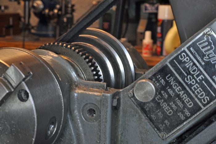

It must be pushing 30years since I made my HDA.  I got the castings (3 lumps of CI) with the lathe but I'm pretty certain that the holes were already drilled in the countershaft casting.  I really can't see how the template helps. Here are some pics of mine.
My HDA  would appear to be mounted somewhat higher than Don's since my right hand hole is through the speed plate!
The only reference we have is the machined countershaft mount on the back of the headstock.  Everything else around there is a as-cast and somewhat variable.  The 1 1/2" dimension is horizontally rearward from this machined face on the back of the headstock (look at the side view on the GA drawing).  Height needs to be the same for both screws in relation to the line of the lathe spindle axis.  I'd be inclined to drill the left hand side so that the HDA cross bar avoids the belt and then mount the device on this end and with the worm engaged in the bull wheel, then let the spindle rotate until the HDA cross bar is horizontal - you can use a spirit level to get the bubble in the same position as it is when laid along the length of the lathe bed.  Then mark the position for the right hand screw.
