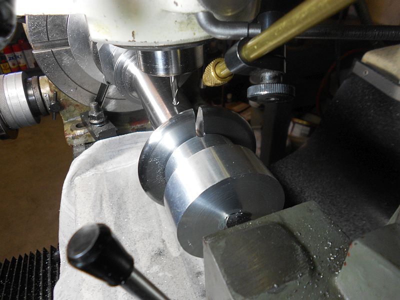

Hi everyone,
The new Y axis power feed has been installed and is working great. The column/cylinder has been picked up from the automotive machine shop and some fixturing made.
Here is the cylinder sitting on my mill table; check out the finish in the bore! The taper has been removed and a very nice finish for the ringless piston to run in; has been created by a guy with many years experience running a hone. The reflection is from my 5C collet fixture sitting behind the cylinder.
Using his shop made tool Max made sure the mill was properly tramed.
And then the rotary table hoisted onto the mill table.
Here is the indexing setup; a small 3 jaw chuck mounted onto the rotary table which grips the counter bore in the end of the cylinder. A spud was turned for a nice fit in the top end of the cylinder with a center for the tail stock. A piece of all thread screwed into the spud and passed through the cylinder and the rotary table holds it all tight. An Idea pinched from Phil_L; thanks Phil
The first (easy) octagon is machined for a reality check; all seems good!
The next octagon is machined where eventually the raised panels will be added. Starting out with a 1” end mill and then finishing up with a fly cutter for a nice surface finish.
Jim you had asked about Max’s machinery; he has an import 12”x36” Tida lathe and a Birmingham clone mill which is also an import. Then the various assorted other tools; band saw, grinders, sanders, etc.
More to follow.
Thanks for checking in,
Dave and Max

Hi Guys
As promised here are some update shots of the O&L cylinder.
All the raised panels have been machined; Max said that it wasn’t as much of a pain that he thought it would be.
An operation to finish out the day; was to machine the clearance for the slide valve rod in the top flange of the cylinder.
Today was spent cutting the octagons and details just above the raised panels. Max says that he is getting tired of cutting octagons and there still is more to go! The slide valve rod clearance was also machined in the area.
The next operation will most likely be, to machine the seat for the fixed valve plate. Then onto the fluting and then finish up the octagons on the lower end. The mill head will need to be rotated and he wants to finish as much work as possible before doing this.
Dave & Max

« Reply #58 on: March 25, 2016, 12:21:27 AM »
Hi Guys
Eric, Don, Bill & Achim, thanks again for the nice comments and the great support; Max said that he will try to do a better job cleaning up between cuts.  :lolb:
Work has been continuing on the cylinder and good progress is being made.
The next task was to machine the cavity where the slide valve body will be mounted; this took several cups of coffee and lengthy discussion at Saturday breakfast for Max to be able to wrap his head around what was needed here. The Lenaz prints aren’t always easy to understand; but as usual this part of the cylinder turned out great.
With all the work being completed with the head tramed; it was time to tilt it over and cut the angles.
After the angles were finished the head was tramed back in and the rotary table and its tailstock were shimmed to allow the flutes in the tapered column to be machined. Max said the print called for .04” deep but he stopped at .03” because the lands between them were starting to look pretty narrow.
I’m not sure what’s for dinner but here is a shot of the completed cylinder/column. I’m thinking that the slide valve body may be next we will have to wait and see.
Thanks for checking in and the continued support; I think Max is breathing a huge sigh of relief about now, having all this behind him.
