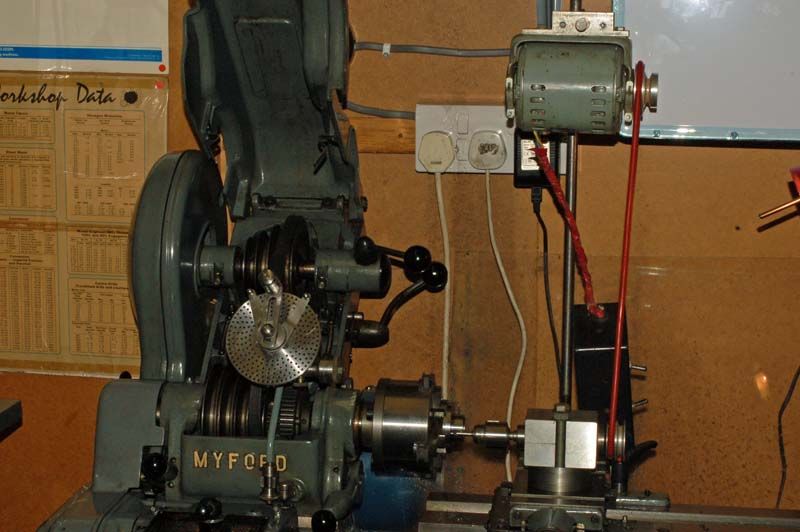

My milling spindle arrangements have evolved somewhat over time.
This mounting block uses a locating wedge cone similar to the topslide.  It is sized to mount the spindle exactly on centre height
But there isn't enough movement of the cross slide to get the spindle to the lathe centre so I added this extension.
That worked fine and it should be possible to permanently mount a motor to have a quickly mountable solution - almost as quick as changing a tool holder but probably more rigid.
I had bought the original milling spindle from Arrand many years ago.  When I saw the Myford fixed vertical slide and "home made" milling spindle advertised on ebay by Myford (the new people don't seem to know much about the model engineering world) I snapped the 2 up for £80 - I recognised the spindle as an Arrand.  The original spindle is still used for odd things like gear cutting, where I have to use a countershaft to bring the speed down in order not to destroy the cutters.
Some ideas for the mix.
