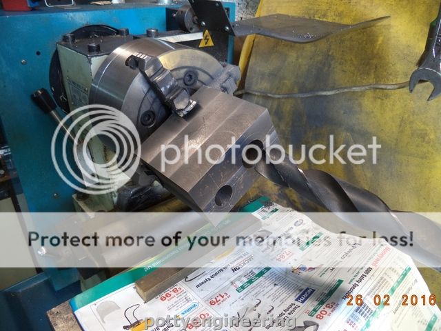

Every project has to start some ware so I decided to start with the cylinders as I thought this would be the most difficult part to make and if I couldn't make them there was no point in taking it any further. I didn't wont to use castings I wanted to make them from a billet of cast iron, this called for a redesign of Don Young's drawing. I kept all the main critical for function features:- over all length vavle ports cylinder piston valve relationship etc, but reduce the cylinder diameter to 1 3/4" 45mm and simplified other features so that it could be made from billet.
Progress to date:-
Cutting the meehanite cast iron billet to size.
I then roughed it out on the mill and finished square using an angle plate
spotted out the cylinder and valve position using the mills DRO and located in large four jaw using a wobble bar.
Roughed out the bores.
And then set up on the cross slide and using a between centre boring bar finished the bore.
First bore done only another three to go.

Well I've got the cylinders finished
And a few process shots

« Reply #8 on: March 21, 2016, 08:53:34 PM »
Hi Stew
Looking good - but a bit more info would be nice .... like - I'm guessing that the bigger bore at the bottom is the cylinder and the slightly smaller diameter is the "steam chest / valve housing" ...?
The two outer holes are most likely the "exhaust" but witch inside hole - the one by itself on one side or the oval one between the two "exhausts" ...?
Best wishes
  • Posts: 2317
Re: 2-6-0 Mixed Trafic Tender Locomotive
« Reply #9 on: March 21, 2016, 09:27:55 PM »
The smaller holes are for piston valves, shaped like barbells.  The oval center hole admits steam to the center portion of the valve bore, and the steam is admitted to the cylinders by the valve opening the passages inside the valve bore.  You can see where the drill for these passages made some marks in the first photo.
https://en.wikipedia.org/wiki/Piston_valve_(steam_engine)
Notice that there is a single hole on the outside of the piston chamber.  This is an inspection hole that allows the valve timing to be set.  In operation it will have a screw plug.  Most US locos with piston valves I've seen have two such ports.

  • Posts: 6790
« Reply #10 on: March 21, 2016, 09:48:58 PM »
I'm wondering about the 4-jaw. Is the 4th jaw inside that hole? Or something else?
They sure came out looking nice.

« Reply #11 on: March 21, 2016, 10:35:44 PM »
Thanks for your interest chaps, to answer your ?
Hi Stew
Best wishes
As Kvom said the smaller hole is for the piston valve the steam goes in the central horizontal oval hole and out the two outer vertical oval holes the centre hole actually joins up to the valve port as is for a snifter valve, you can't see in the photos but there are two holes at either end of the piston bore for drain coxs this is to release trapped moisture in the cylinders to stop the hydralic lock popping off the covers.
The fourth jaw is reversed you can see that better in this picture.
The valve ports are machined in a separate sleeve that is pressed into the valve bore, the valve itself is bobbin shaped I'm unsure at the moment whether to use o rings or piston rings on the bobbin I think I'm going to have a try at making piston rings this will enable a beter design of valve sleeve I'll post a progress report on this.
Thanks
Stew
