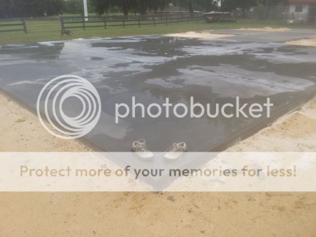

Pretty nice, huh? No not the little shack.  That is the chicken coop.  The pile of sand.  That will be the sub base of the concrete slab upon which I will build my shop.
A very skillful boxblade operator spread the sand to a level that I would not have thought possible.  Just watching gave me a stiff neck.
Before he left for the day forms were laid and reinforcing mesh was installed.
And the following day,  the slab was poured and finished.  The area of the slab is 64' x 36' and while that sounds like a great big shop,  It will also house 4 horse stalls, a dog suite, a tack storage room, hay and feed storage, a general maintenance area, and maintenance equipment and tool storage.  That still leaves a generous 12' x 16' room for my shop.
Some of you may have some engineering and construction experience and will be wondering about the lack footers and the relatively light reinforcing in the slab.   This is Florida and this is not your normal construction.  This will be a pole barn.  The slab plays no part in the support of the structure.  The roof (metal) will be supported by 28 square post (8" x 8") set 4' in the ground  in 16" diameter holes and filled with concrete that is independent of the slab.
Why?  Because this is a horse farm with agricultural exemptions, and because this structure replaces a cow barn in the same location (even though the cow barn was demolished about 6 years ago), and because the structure is not intended for human residency,  It requires no building permit.  Which means no engineering design cost.  All that is required by the county is a general description and statement of intended use.

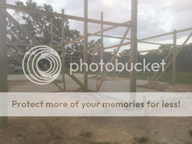

The shop is nearing completion but of course there have been delays.  The pictures above were taken last spring.  I just thought you guys would like to see it from the start.

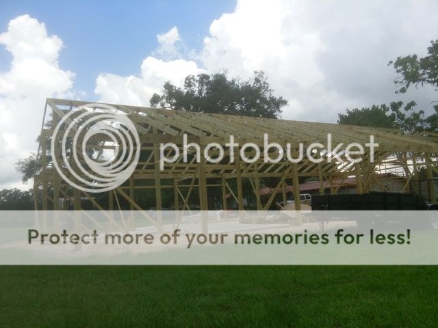

After the slab had cured and aged for a month or more, the poles went up.  Lined up and plumbed and braced with diagonals, each post got about a dozen bags of Sackcrete, poured dry and watered in place.  Then more time passed as the concrete set up.  This barn sits on the highest point of the property with good drainage and the soil here is sandy so no water problems are expected.
And then the rafters and ridge pole are added.

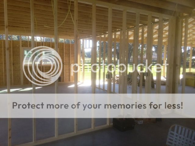

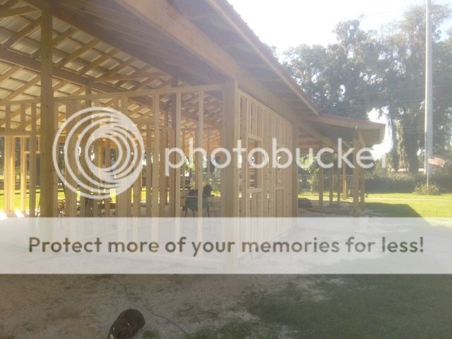

The metal roof went on quickly and I didn't get any pictures of the process.  This was a major step.  It marked the end of outside contractors.  From here on, with the exception of the electricians, It will be just me and my son-inlaw unless an unsuspecting friend or relative stops by.

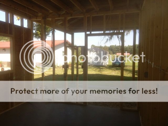

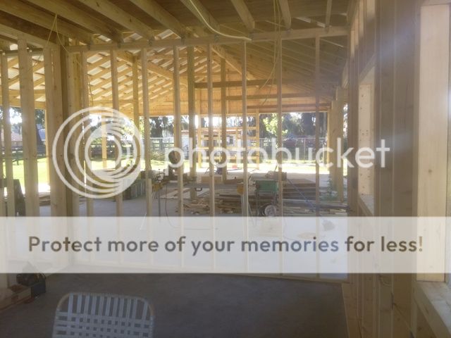

Framing begins with the important parts, my shop and the adjacent general maintenance shop and storage.  These area will occupy the north end of the slab and the roof extends an additional 16' to the north providing a 16' x 36' covered storage for equipment as well as a weather protected entry to the shops.  The framed partitions sit on the slab and are 118" high which will give me a 9' ceiling height.  The frames support 2x8 joist covered by 3/4" plywood sheet.  Stairs from inside the barn will give access to this area for light household storage like Christmas decorations and other seasonal stuff.  Six inches of insulation in the overhead and four inches in the walls will help with the temperature control.  Shops will be heated and air conditioned.

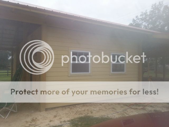

The exterior walls are sheathed with OSB and sided with HardyBoard.  My shop has two windows on the west side and the door on the north side will have a nine panel glass window.
South wall looking through to tack storage room and beyond.
East wall, looking through to maintenance storage.
North wall looking through the door.  That metal shed is where my machines are stored and will go away when this is completed.

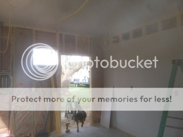

West wall, looking through the windows to the garage and driveway.  The electricians have come and roughed in the wiring.  All of the shop outlets are 48" from the floor to be above bench height.
I decided to install drywall or gypsum board on the walls and ceiling which will be painted white, semi-gloss.  My son-in-law wanted me to use a plywood bead board or vertical T-1-11 because he doesn't like doing the mud but I wanted the sound qualities of drywall so I have done all of the finishing.
He insists on plywood for the maintenence shop so he will do all of the sealing and painting of that area.

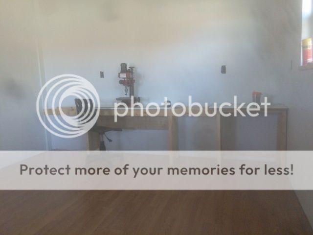

At last!  The floor  is in.  I had looked at as many of the epoxy products as I could and the one thing that they all have in common is a great emphasis on the necessity of extensive and labor intensive  preparation and after they are applied, they look great but are as hard as a rock and just as comfortable.  I couldn't justify spending a lot of time, energy and money and still have to spend more on mats.
I am not afraid of epoxy.  I ave refinished the hull of a sailboat and the inside of a swimming pool with good results but for my shop, I wanted something a little more comfortable.  My final choice was a low priced laminate floating on a 2 mm thick foam pad installed without glue or nails.  Installed cost (my labor is free but the cost of Tylenol is added in) about $1.50 a square foot .  The first half of the job was a real bear over a three day period and then I got the hang of it.  The second half of it took about four hours.  I got the vinyl baseboard down in a few more hours.
Laminate floating on a high density foam pad may not be the first thin you would think of for a machine shop my machines are small, bench top machines and a 9x20 lathe.  I have no plans to buy anything bigger.  Too late to change course now.  Its done.  But if anyone can foresee a problem, speak up.  There may be a way to head it off.
First machine moved in today.  My very small HF Micro Mill is the only thing I can carry by myself and there was no help available today.  I also have a slightly larger HF Mini Mill but I can't carry it.  That will have to wait for my grandson of the big muscles tomorrow.  The lathe will come too.
My second son-in-law is a mechanic/teacher.  For the last several years he has been a senior instructor at the BMW training center in Orlando has offered to give me some of his excess mechanics tool chests which I am going to pick up tomorrow.  I am not at all sure just what I will get but he told me to bring the big truck so there will be more than one.
Here is what it looks like now.  More pictures when I get it all in.

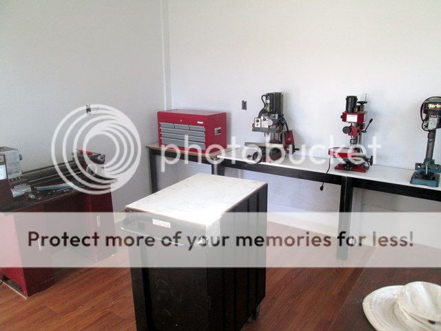

Here are the tool boxes given to me by my son-in-law.  On the left is actually a bench.  The top of the bench measures 27" x 52" and is 1.8" thick made from 19 layer plywood.  The base is heavy gauge welded steel.  BMW brought it from Germany and he got it when their shops in Orlando were renovated a few years ago.  The rolling cart is a later vintage Craftsman unit.  Nice stuff that I am glad to have.
My grandson came by and helped me move the rest of my machines in.  The 9x20 lathe is the one job that I really needed his help with. I probably could have handled the mill by myself with a lot of planning but he picked it up in the storage shed and walked the 100 feet to rhw shop and said "Where do yo want it?"  The lathe made the 100 foot trip in the bed of a truck.
This is the initial arrangement.  It may change slightly with use.  All of the bench tops are 29" high and I do all that I can while sitting on my rolling chair.  Any thing that requires standing such as soldering will be done on the 35" high BMW bench.
Most of my tooling is still boxed up in the shed.  Before I can do anything productive, each of the machines will have to be stripped, inspected and adjusted.  I see a little rust on some of the surfaces.  Oh! And there is no power yet except for a long extension cord run from the garage.
