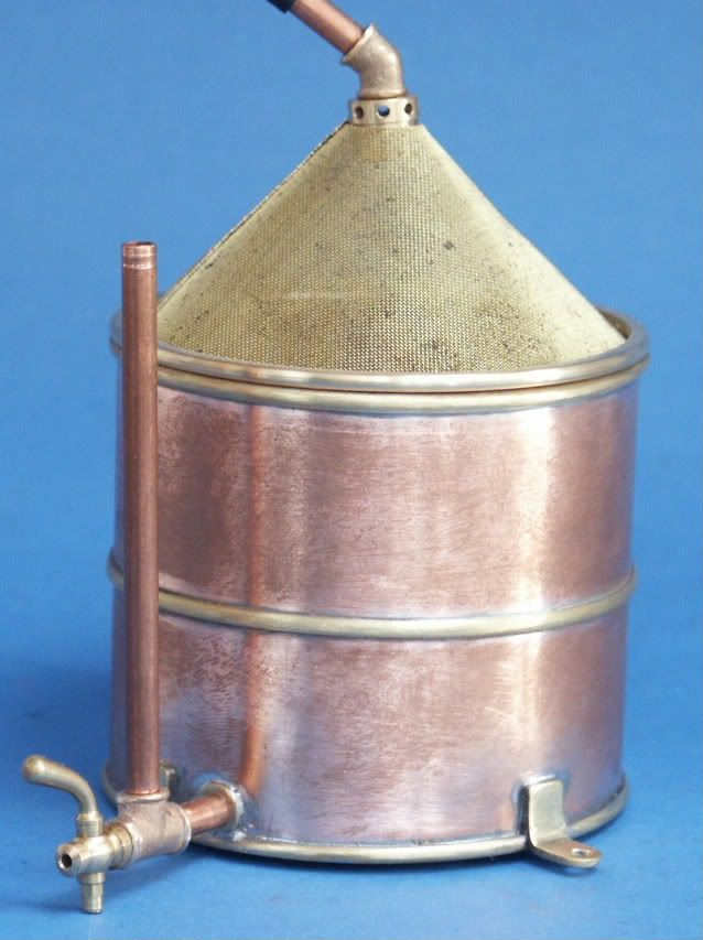

Jason - re. the Fowlers, I wish!  I reckon the pair would cost ten times what my old lady did though.  The nearest I have ever been is that my first moling tractor in 1989 was a Fowler Challenger 33 steel-tracked crawler, and since then we have used a succession of Cat D7Es and D8Hs.  The huge advantage of rubber tracks though is that you can lift up the mole and drive out of the gate to the next job at 15mph.  With steel tracks a low-loader is required with all the ensuing cost and delay.
I have considered the Lunkenheimer simply because I've made a couple that work well, and also because I'm not sure how to make a fuel tank with a flat top for Graham's design to sit on!  How would one bolt the casting down - solder the bolts/studs into the top before assembling the tank?  I'm comfortable with lathe and mill but tinwork terrifies me!
Graham - I'll take a photo in the morning.  One of the lugs is buried in a mess of not very solid-looking cast which when machined away won't leave a full-sized lug I'm sure.  Your design does sound a lot simpler than the Lunkenheimer though, which is why I thought I might fabricate one.  I'll still have the issue of making a tank though - I could probably buy a cylindrical one to use with a Lunk.!

Mike - thanks for that.  What a super looking engine.  The spring on the push rod is a good idea too - mind if I copy you?  I like the diamond-shaped name plates too - did they come with your kit?  I don't think I'll be able to highlight the cast-on writing on my hopper if/when I do the painting.  I'm no sign writer.  I'm happy enough to use spraygun or cans, but tiny brushes - I'm far too clumsy!
As you'll see above, part of my reluctance to use Graham's design of carb is my ignorance concerning making a suitable tank!  The Lunkenheimers are a bit fiddly though, so I'm open to suggestions!  I hold me breath when I look to see whether the little needle valve hole has emerged in the cone of the valve seat, but in the two I have made it has done.  Probably more by luck than judgement!  One thing about them - the slightly rude noise the little valve makes on the induction stroke never fails to raise a giggle from someone seeing the Red Wings for the first time!

Round tanks are not too hard to make, for that one I would face off a ring of suitable dia brass tube then rough cut  a couple of discs of brass, sit the ring on one and rest the other on top then soft solder. Once soldered file off the overhanging edge of the discs and you will be left with a nice neat tank, couple of tabs left on the bottom one will allow for screwing it down and silver solder any fittings to the top before soft soldering the tank together. They can be bought a skits from DeBolt in the US at a price
https://www.deboltmachine.com/collections/all?page=1
Horizontal tanks can be done in the same way or turn up a couple of stepped ends.
You can solder on a bit of brass half round to make it look like the tank has been bead rolled as a lot were, once painted in satin silver or silver Hamerite it will look like Galv
Or just hide the tank in the sub base and JB Weld on a filler and feed boss
I expect Graham will be along later to tell us what brand of beans he used for a suitable tin to make the tank from ;)

Jason - expert advice as usual.  I like the idea of a vertically oriented cylinder and soldering on brass half round would make it look exactly like the ones on one or two of my old full-sized engines, Amanco etc.
Don't laugh about the bean can though - I looked long and hard at a small can I emptied of its contents yesterday, and saved it just in case...... :)  That copper (cooling tank?) in the second photo looks very similar to the one on my Amanco, apart from not being as squat.  I reckon that's the way to go.  It can sit on the wooden bearers near the carburettor.  Is fuel level an issue?  In your last (superb!) photo the top of the tank appears to be about level with the carb?
Re. photos, please tell me again how you take them.  You have got more or less everything in focus and perfectly lit, and I never seem to achieve that.
Thanks again for the advice, John.

Mike - of course, I'll look for name-plate makers.  I think I know someone who makes the ones to be given out at tractor rallies.  Thanks for the suggestion about JB Weld too - until Jason mentioned it I hadn't given it a thought.
Seeing your stainless tank made me think of the water tank I have made for my unfinished Best model.  Its made from 4" diameter steel tube with turned ends riveted in, but one could be made and soldered up, the lid etc being completed before final assembly.  Don't know why I was worrying!

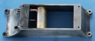

Graham - photos below of the casting.  I don't think that by the time I've cleaned it up there will be enough material left for the lug?

I just fought my way through the cobwebs to the back of the shed the Amanco is in and was amazed to see how much bigger the tank was than I remembered!  Perhaps one for the RLE wouldn't be far out at 4" diameter by around 1.5" high.  Food for thought.

Your carburettor casting is a very poor “ pull “ from another, definitely not one supplied by me. I do have a few spares, with the now famous, special coating. :)
Jason, not beans but .... A “ Three Nuns “ tobacco tin was first used. The present tank fitted to my R.L.E. was purpose made from Zinc plated Steel and sits neatly between the mounting timbers.
That 50 gram tin held enough fuel for several hours of running!!
I’ll try and take some pictures later.

This is the horizontal tank I showed earlier painted up to look like Galv, this has a foot valve at the bottom of the vertical pipe so fuel does not drain back.
Also something a bit larger than a backy tin, this is a cut down 2.5lts paint tin.
