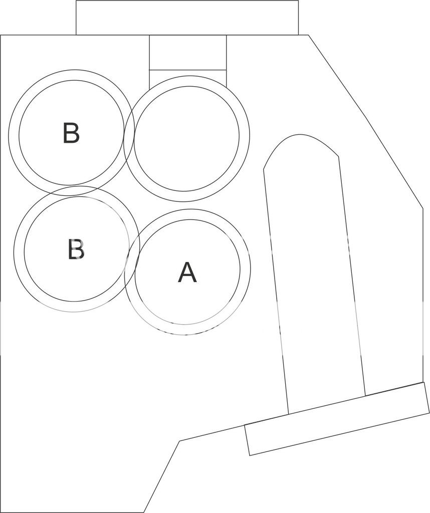

I think the 4 gear type is looking favourite. Have a look at my crude drawing
Am I correct in saying that the handle would be attached/keyed to roller 'A'.  Rollers 'B' are fixed position idlers. The 4th gear would be fixed/keyed to the upper moveable/pinch roller. I am assuming that the upper roller gear stays in mesh when the upper roller is adjusted up and down, within limits.
Just trying to get my head around this :thinking:
Rich

« Reply #27 on: January 23, 2016, 07:58:26 PM »
Sounds about right to me.

Hi
The somewhat oversized drawing? has gears of 1.5" diameter. Thats just a guess at the moment as I haven't sorted through the available materials department yet so I don't know what size the rolls will be and their spacing.
But a question about gears if I may. I have just spoken to my mate Julian and he has 3 involute gear cutters.
They are:  16 DP    21-25
               16 DP    35-54
               20 DP    35-54
I know nothing of gear cutting as yet but would any of those 3 put me in the ball park?
Rich
  • Posts: 9466
Re: Bending rolls
« Reply #29 on: January 24, 2016, 04:13:24 PM »
I would stick with the larger size teeth as they will stay in mesh for longer before they start jumping so thats the 16DP.
If the centre to centre distance of two gears is 1.5" then you will need 24T gears but if you only find 1.5" material to cut them from the ctr distance will have to be 1.375" with 22T
A quick guide to what you can cut can be found on HPC's site, this PDF lists all the 16DP sizes
http://www.hpcgears.com/pdf_c33/23.120-23.125.pdf
