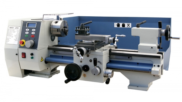

I would consider one of the Little Machine Shop HiTorque mini-lathes, such as this for $1250:
http://www.littlemachineshop.com/products/product_view.php?ProductID=5200&category=
Or their 8.5"x20" for $1800:
http://www.littlemachineshop.com/products/product_view.php?ProductID=3540&category=
You might be able to have them bring one to next year's Cabin Fever and you can save shipping and maybe get a discount as well. They were passing out cards for 15% off for exhibitors, but good only on Sunday. They seem like good people and probably will stand by their products in terms of warranty and service.

The Little Machine Shop Mini and others like it might be OK, I'd have to visit one and play to see how it feels.
