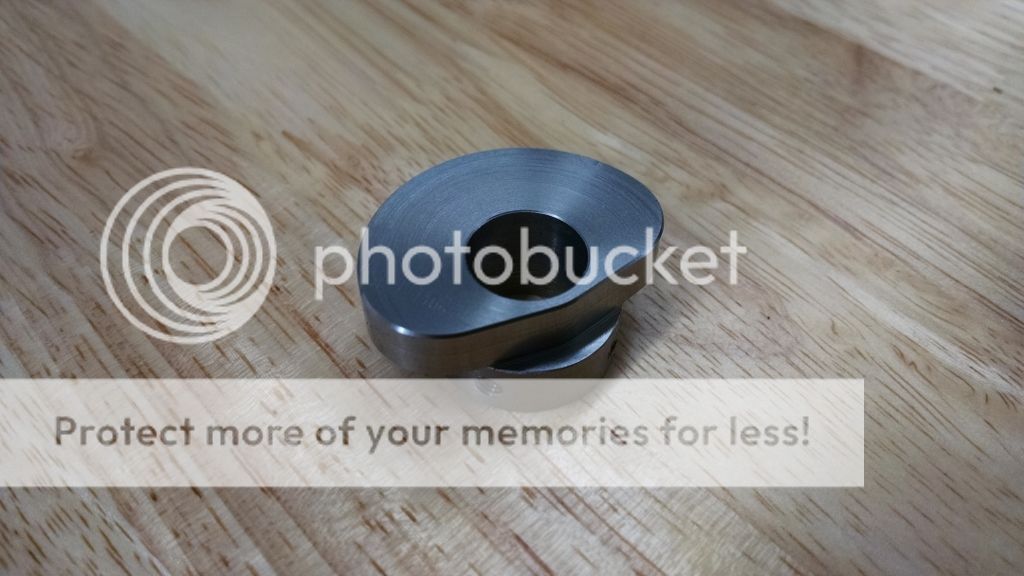

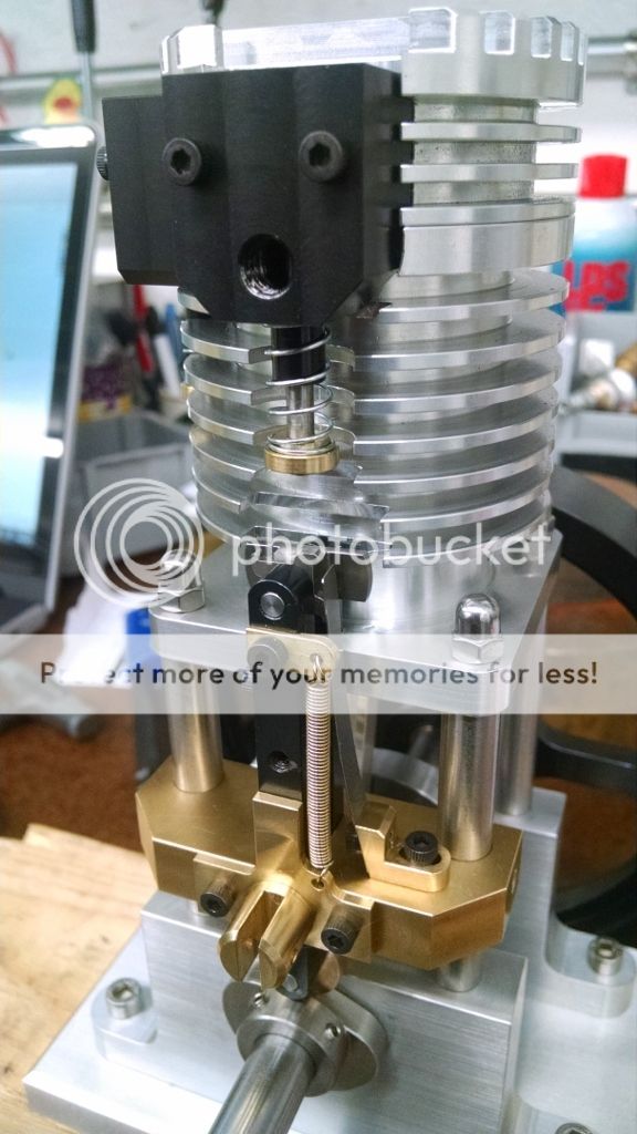

When I was redrawing the engine in CAD, I wasn't paying attention, and changed the amount of lift on the cam, as I thought it wouldn't need it. Well, what I didn't realize, was that the amount of travel on the push rod was needed to properly turn the indexer. I found out very quickly when I put the parts together though, as the valve was actuated just fine, but the indexer didn't turn over. So back to the drawing board, to make sure the travel is adjusted and the timing is still where it needs to be. It's not a hard of a fix, but my ego did take a hit...  :hammerbash:
Anyway, I'm over it now, and a new cam is made.   :facepalm:
The valve train assembled
A short video to demonstrate the indexer at work...

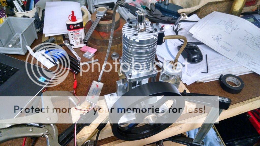

Ladies and Gentlemen, we have a runner!  :cartwheel:
I just couldn't resist to put it together and test it out... It's all temporary. The hall sensor is just taped and clamped in place. The Fuel tank/Carb is borrowed from an other engine. No governor.
It was hard to film with one hand and operating the engine with the other. Also, you can see the mess on my workbench...  ;)
It was just a short test run. It feels good to know that the engine runs before we continue with the governor and fuel tank. Still lot of work to do, stay tune for more...  :DrinkPint:
