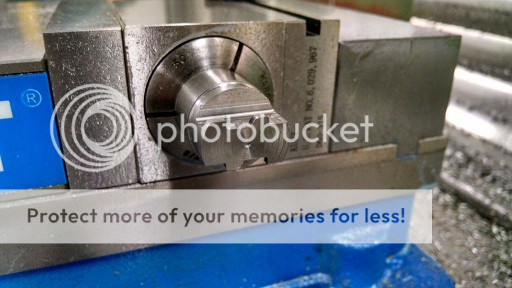

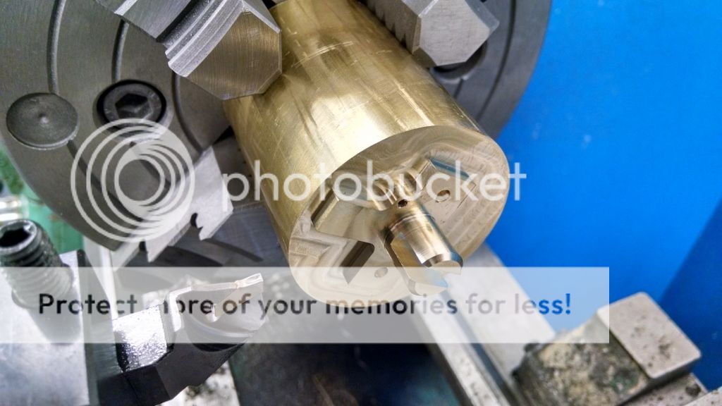

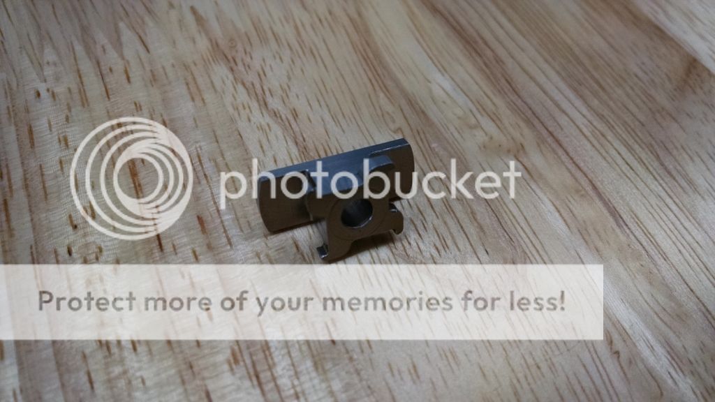

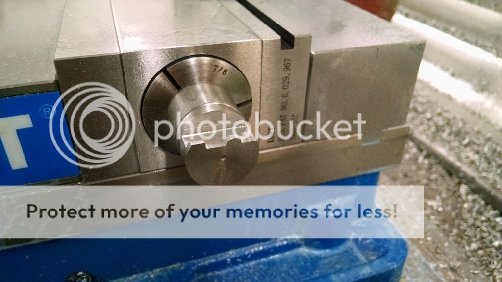

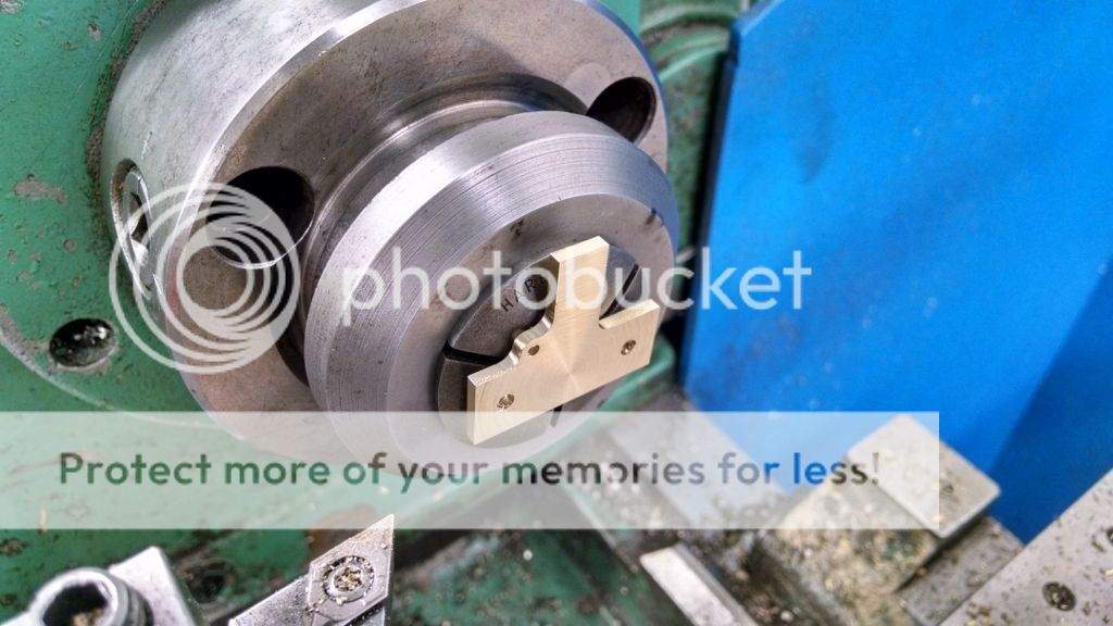

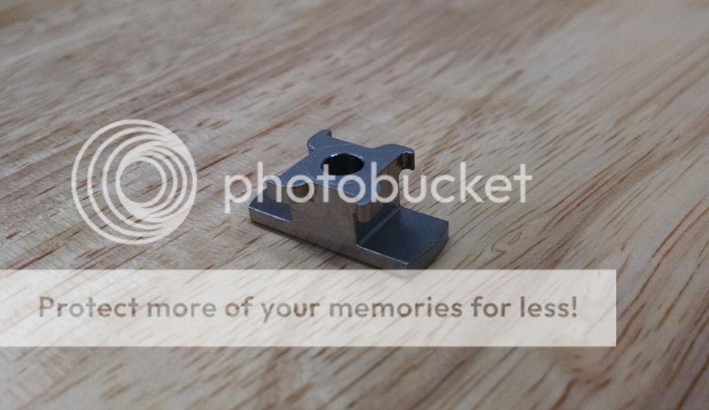

The fiddly bits continue with the indexer.
Using a collet block to index the indexer...  :ROFL:
Material is 303 Stainless
Back on the lathe to part off
Action shot...  8)
Finished part

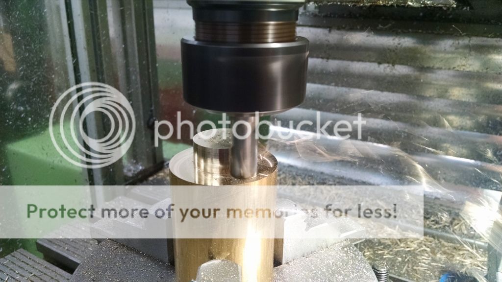

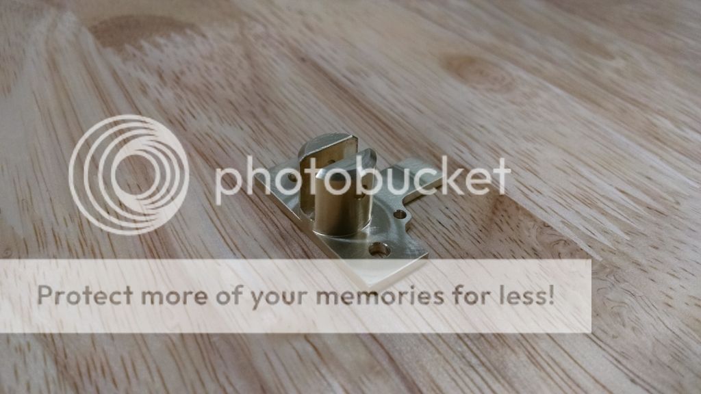

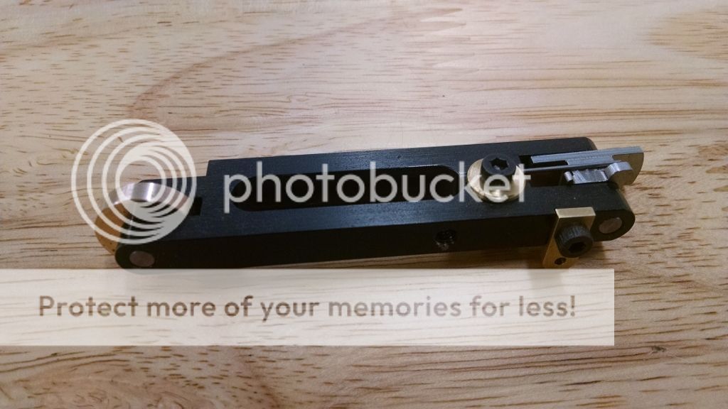

The Toggle Bracket is the pivot for the latch of the governor, and also part that holds the push rod in place. I'm holding off with governor parts until after a successful test run.
I didn't have a better fitting piece of brass stock, so I had to machine quite a lot off...

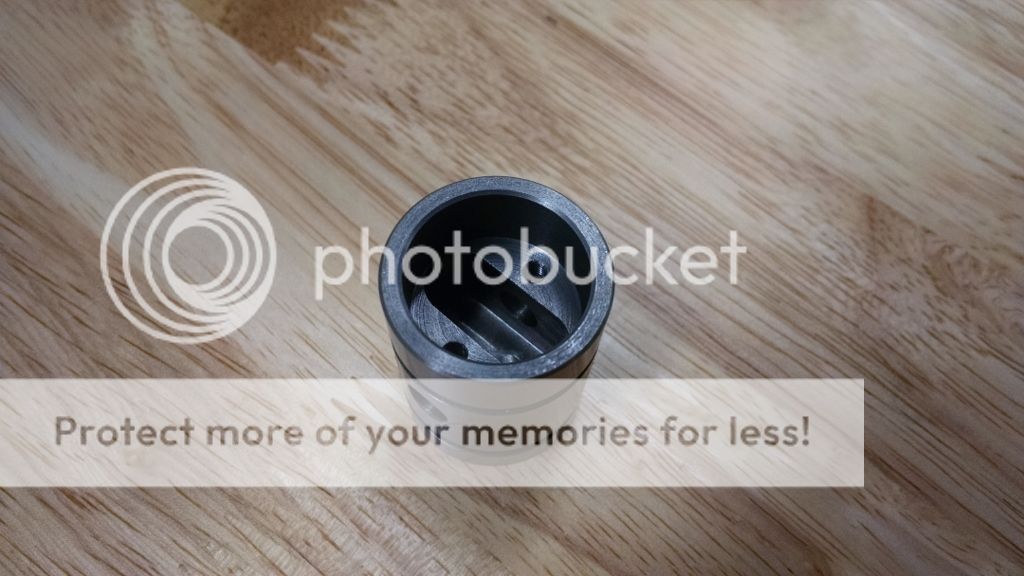

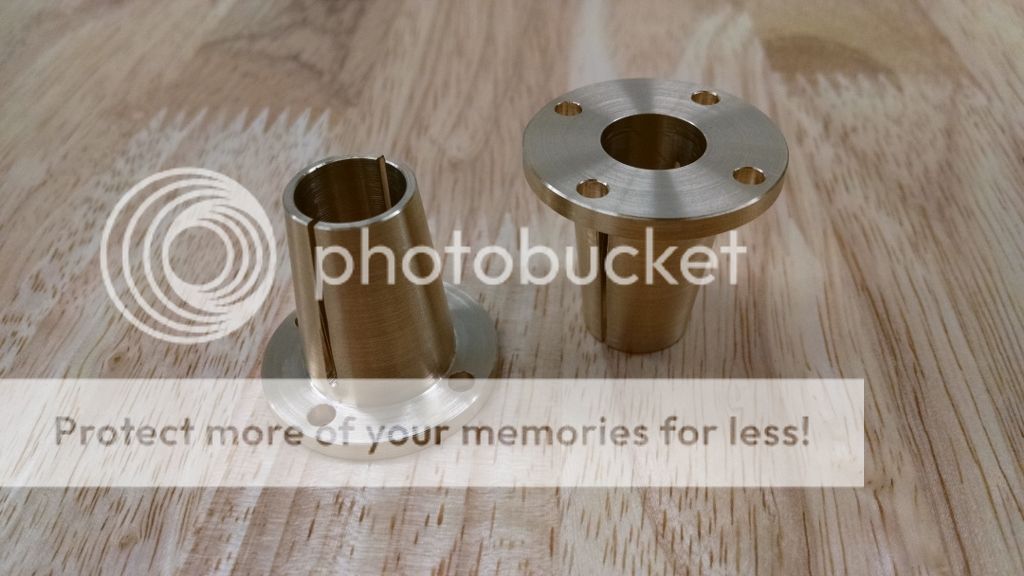

Today's installment is the cast iron piston and the tapered bushings to mount the flywheels. The rather large ring groove in the piston is for a O-ring.
We are getting close to start assembly...

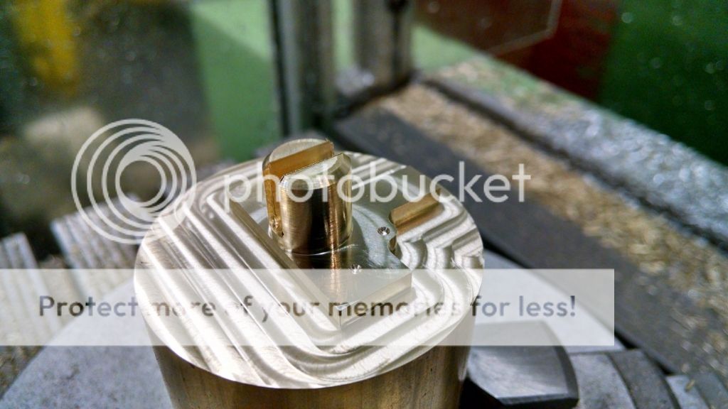

« Reply #88 on: February 09, 2016, 05:17:13 PM »
Yogi:
Very nice pictures and wonderful parts. I also like the brass and black oxide contrast.
In cutting the indexer there are a couple of arcs. How did you cut these, are they profiles or? They seem very smooth even when in the vice so likely not file work. Inquiring minds...
Thanks.
Hugh
Hugh
Offline yogi
  • Posts: 450
  • Duncannon, PA USA
    • Yogi's Workshop
Re: Yogi's take on a Duclos Gearless
« Reply #89 on: February 09, 2016, 10:41:07 PM »
Thanks for the compliments guys!   :cheers:
Hugh, yes, the radii are milled using a 1/8 diameter endmill with a small corner radius, in a surfacing operation. Because they area to be milled is so small, I used a very small step over, and it didn't need any finishing work afterwards. I was contemplating on just filing the radii when I started with the indexer, but then went for the milling ops. I'm glad I did, as it turned out nice...  ;)
