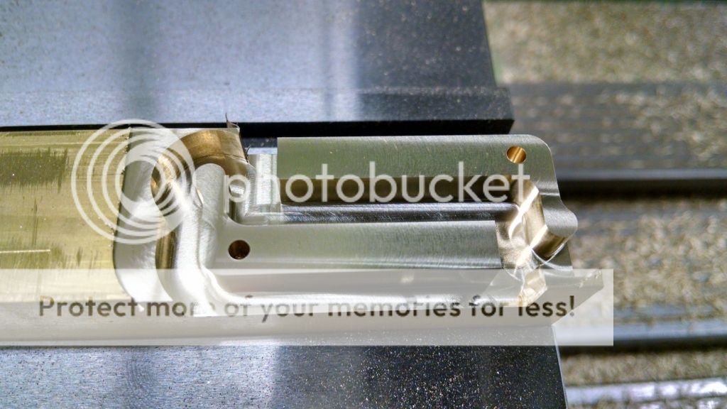

The governor weight arms are next.

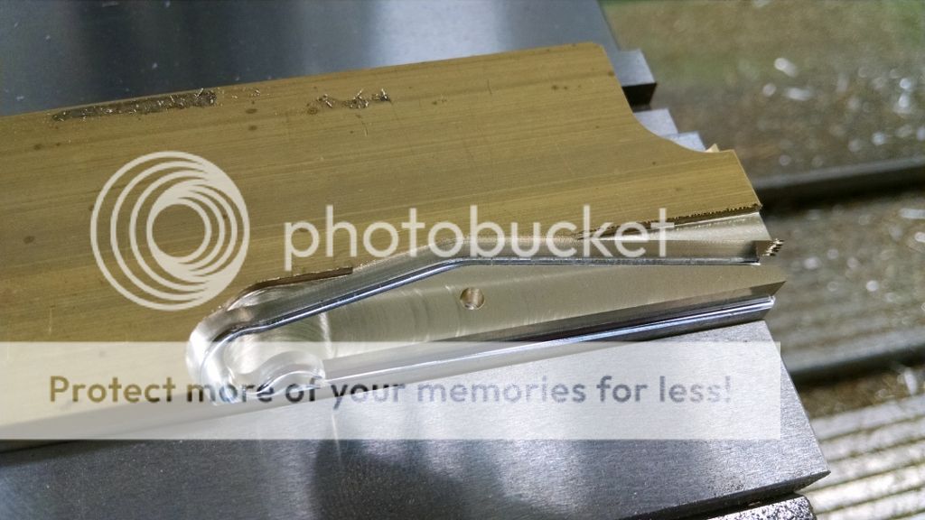

First, I machined the finished contour. Milling a bit deeper than the thickness of the finished part, to allow for the second side to be finished later.
Unfortunately I didn't have fitting brass stock and ended up wasting a lot of material when I machined the back side off. I have some brass on order, but I just couldn't wait to get back to making parts again. Anyway, not the end of the world, even though I really hate wasting material!  :disappointed:

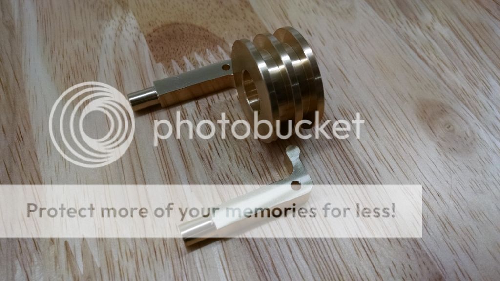

After cutting the two pieces free, I finished the second side to the final thickness.

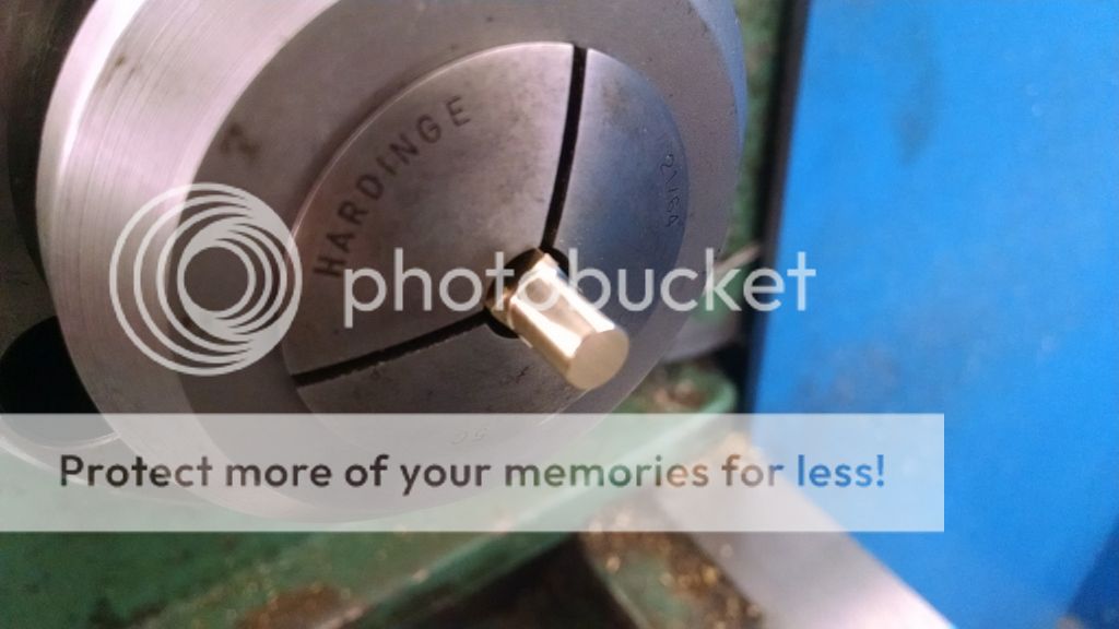

The last operation was to cut a round mounting boss, where the wights will be mounted on.
I clamped the square part very gently in a round collet.  That's not ideal, but as long as none of the edges end up in the slots of the collet, and the collet doesn't get cranked down to hard, it works alright. A square collet would be preferred here, but unfortunately, I don't have one.
The finished parts:
I also turned the governor spood:
And the parts together:

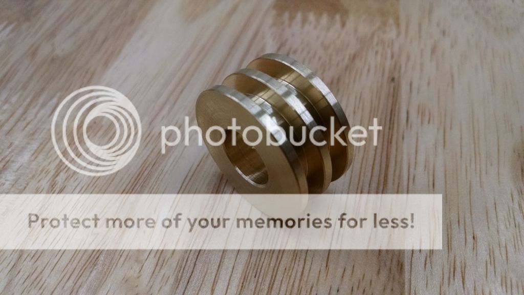

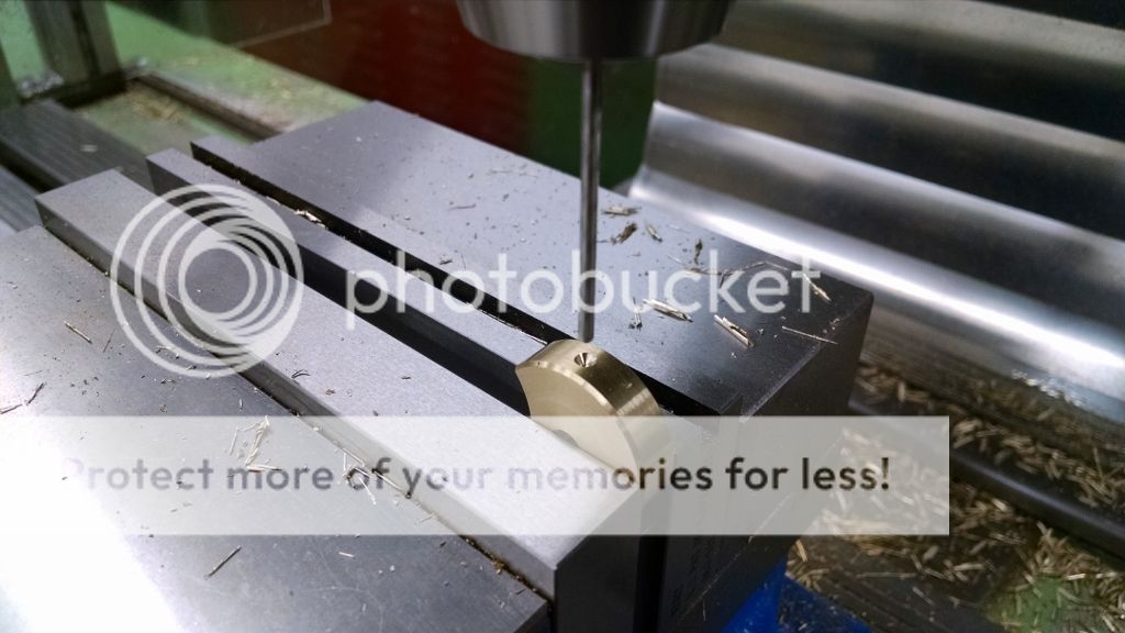

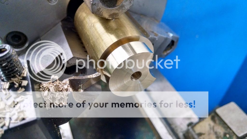

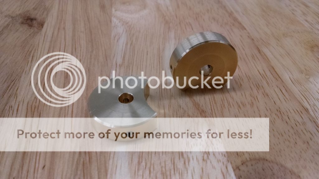

I have a couple more pieces for the governor made.

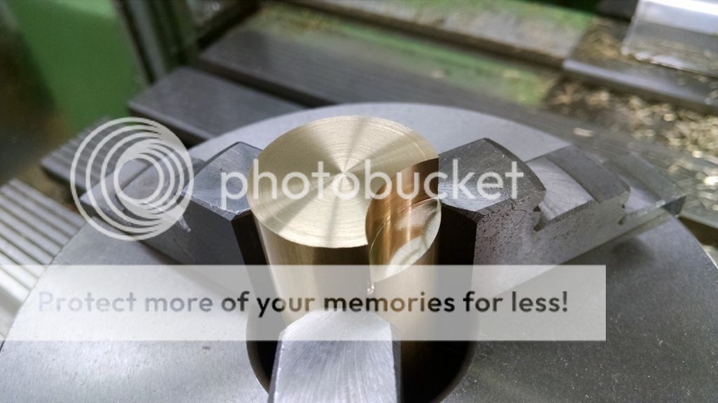

The wights have a recess to fit around the hub of the flywheel.
The first operation was to mill the recess with the same radius as the hub on the mill.
Then, I moved over to the lathe and finished it to size and parted it off.
Last, drilled and tapped the holes for the set screws. This will also provide a mounting location for springs.
The finished weights:

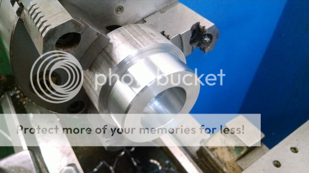

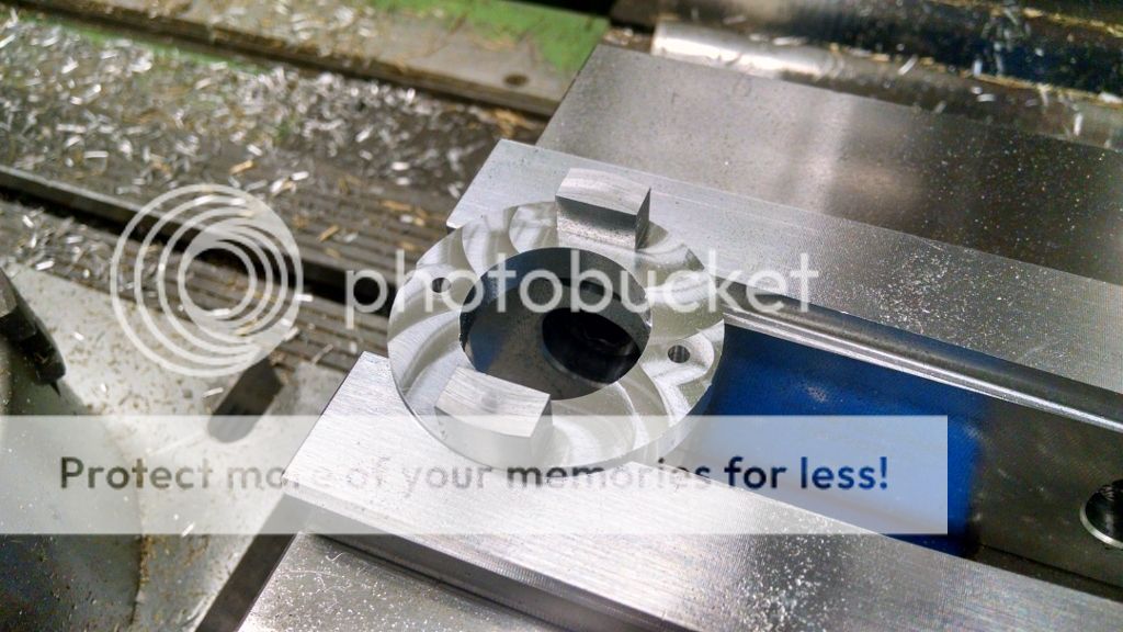

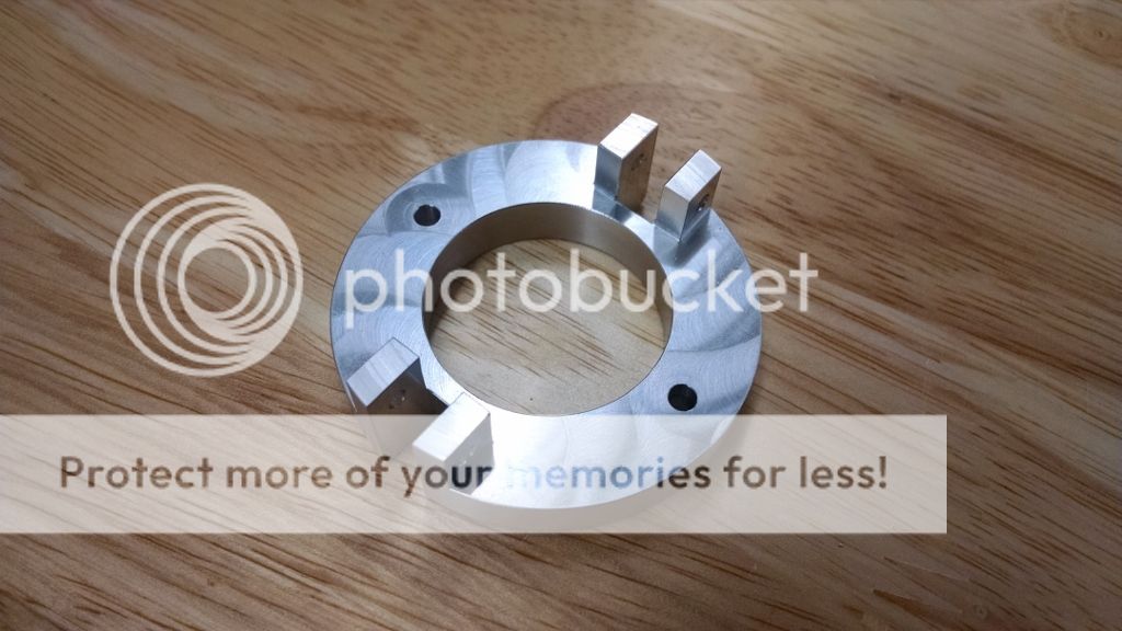

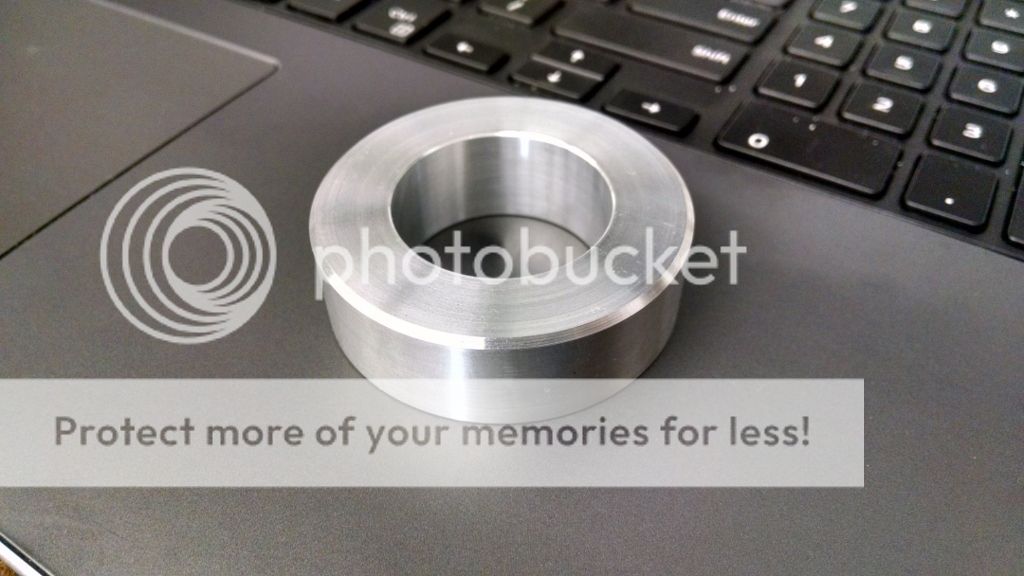

Next, I made the bracket with the pivot for the arms.
I started on the lathe, turning a ring.
Using the trusty soft jaws, the ring is chucked up in the vise for milling. Have I mentioned, I love my soft jaws?  :Love:
Unfortunately, I forgot to take a picture when I milled the slots for the arms. Sorry guys!  :ShakeHead:
And the finished bracket:

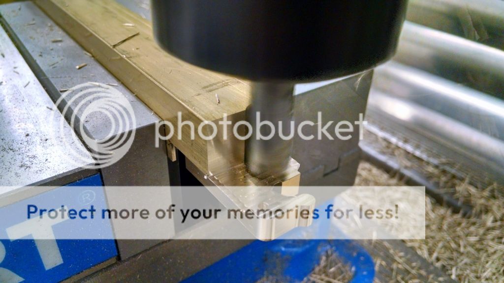

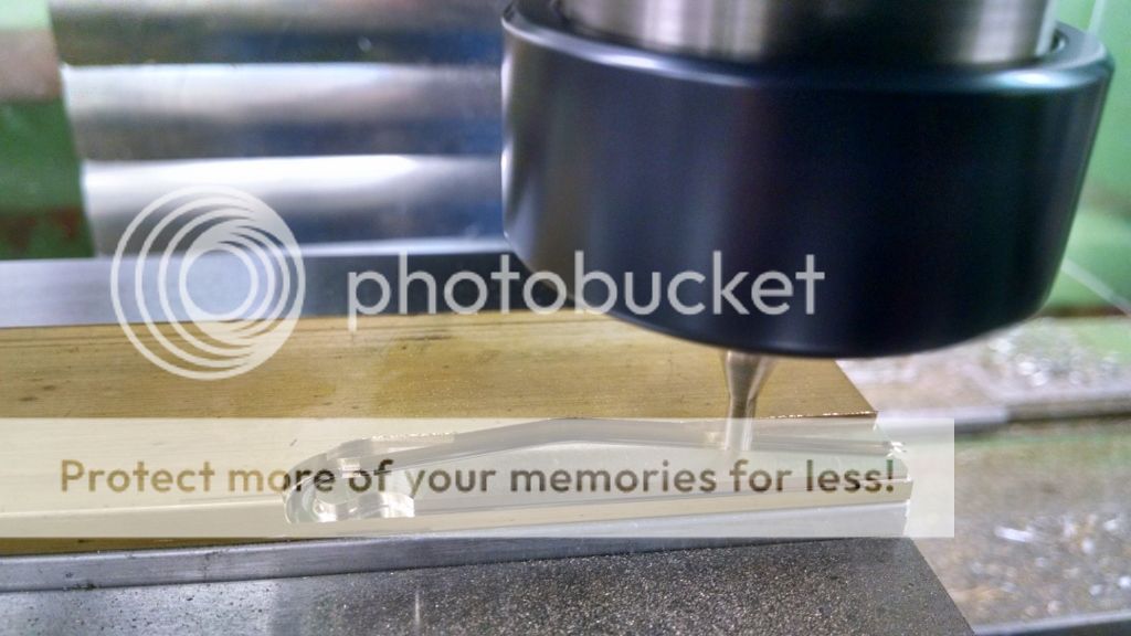

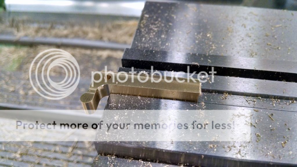

The last part for the governor is the latch.
I milled it out of a brass bar, that was just about the right thickness. It only needed a light surface cut to bring down to the correct dimension. To hold the work, I used CA glue to stick the brass to a piece of aluminum, which I then clamped in the vise. The contour is milled using light cuts, to not put on too much load on the bond. It worked very well, and I think I could have done a bit deeper cuts, as the glue held really well, but I just didn't want to take any chances. After I was done, a bit of heat to release the glue and separate the parts.

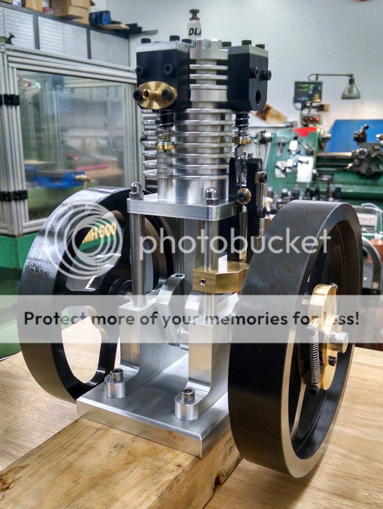

The governor finished assembled. There are probably some adjustments and tuning needed, but we'll have to do that with the engine running, so we'll get to that later.
