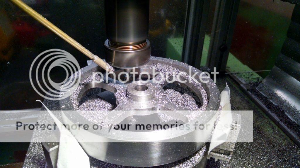

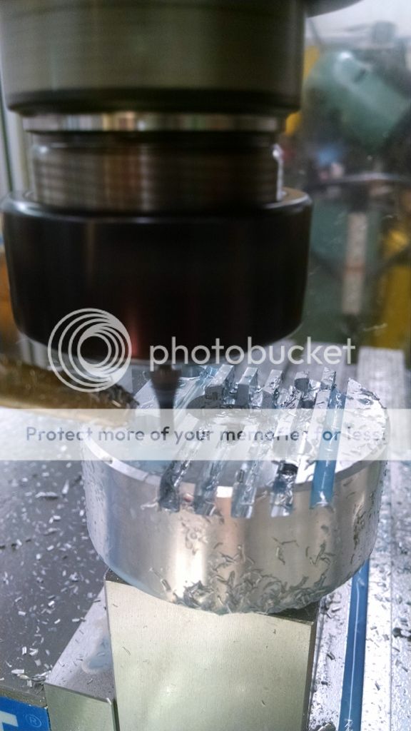

Up next, the cylinder head.
The parts haven't been deburred yet, when I took the pictures.... Lots of edges to deburr...   ;)

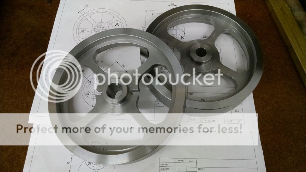

Flywheels are almost done. Just a few tapped holes left...

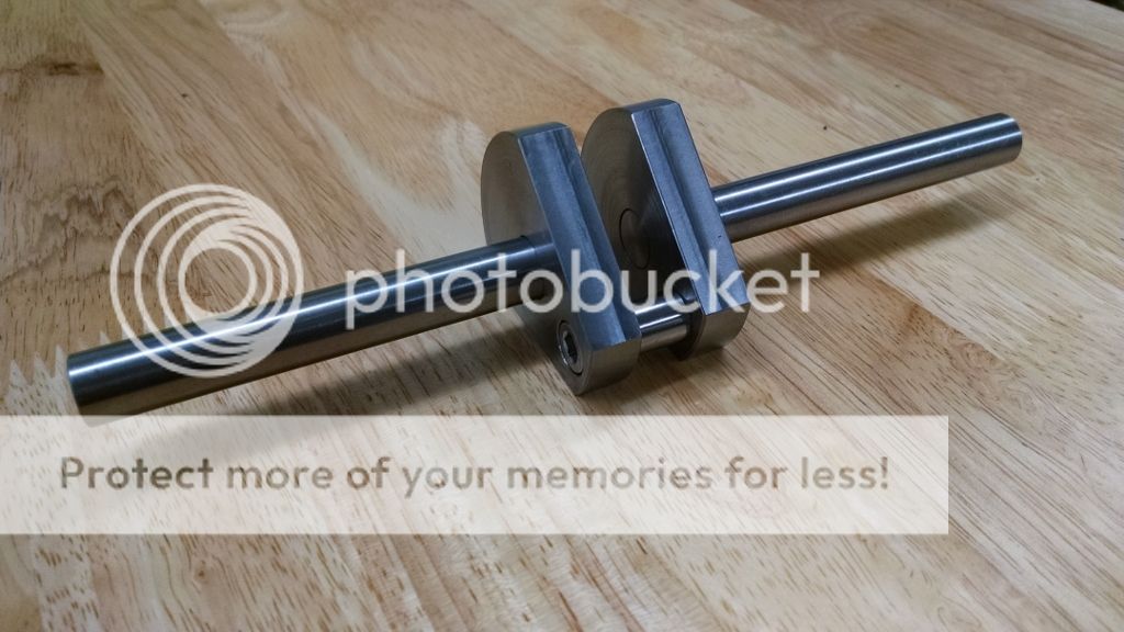

Up next, we have the crank shaft.
Its the built up variety. The thing to note about this crank shaft is the crank pin, which is a needle bearing inner ring. Needle bearing inner rings are hard and precision ground, making an ideal crank pin.
It being a built up crank shaft, the big end bearing will be a needle bearing. I don't have any pictures of the machining, but here a shot of the test fit.
We'll come back to it in more detail after the connecting rod is done and we'll do the final assembly.
