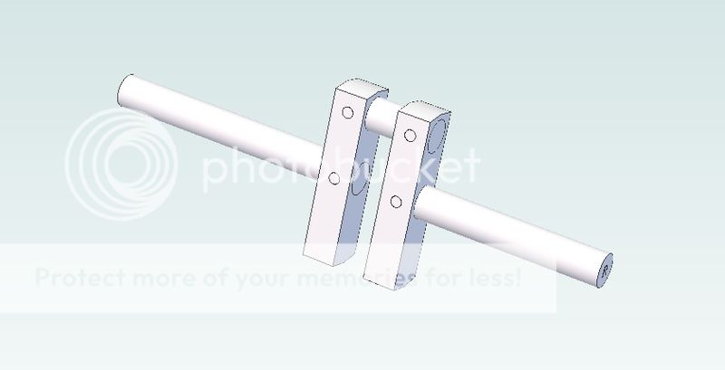

When I built my Upshur a few years ago I made the crankshaft on my mini lathe out of a solid piece of steel.  It turned out OK (no pun intended), but I still have nightmares from those interrupted cuts.  For this little engine I decided to try a built-up crankshaft.
I used 3/16" drill rod for the shafts and 1018 steel for the webs.  The left side is a little longer than the right to acommodate the hit & miss governor.  I'll use Loctite at the joints and 1/16" drill-rod pins through the shafts to make sure everything stays together.
I machined the webs to size and drilled and reamed the shaft holes.  Then I pre-drilled holes for the 1/16" pins.
I slipped the shafts through the webs with some Loctite at the joints and some 3/16" drill-rod spacers between the webs to keep things in place while the Loctite cured (not shown).  I then removed the spacers and drilled through the shafts and inserted the pins with more Loctite.
I used a hacksaw to cut through the main shaft.  The green tape is just there to keep some scrap sheet metal in place to protect my vise.
Does this type/shape of crank web offer any advantages/disadvantages over the  traditional rounded shape? Any balancing issues? I need to make a crank for a steam engine, and don't have the correct sized metal to make as per plan. I can make one like this.

Chuck in East TN, I'm afraid I'm not qualified to give you a good answer as to advantages or disadvantages of this type of crank web.  I chose the rectangular webs because that's what I was familiar with and had material on hand to make them that way.  As far as I know I have no real balance issues, the main shaft is centered in the webs, and the addition of the crank pin at one end only moved the center of mass away from the axis by about 0.012 inches, and it's adding only a few thousandths of an ounce.  I figured it wouldn't be a problem for a low-performance, low-speed little engine like this one, so I didn't add any counterweight to the other end, or try to account for the connecting rod weight, etc.  I have seen a lot of larger engines with circular crankshafts shaped for better balancing like you mention.  Maybe some of the more knowledgeable engine builders on the forum can give us more info.  Sorry I can't be more help for your situation.

Chucketn--As long as it is a "low speed" steam engine I don't think you will notice any real difference. What is "low speed"??---Probably anything under 300 RPM.---Brian
