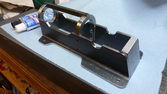

Frame fabrication continues.

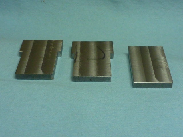

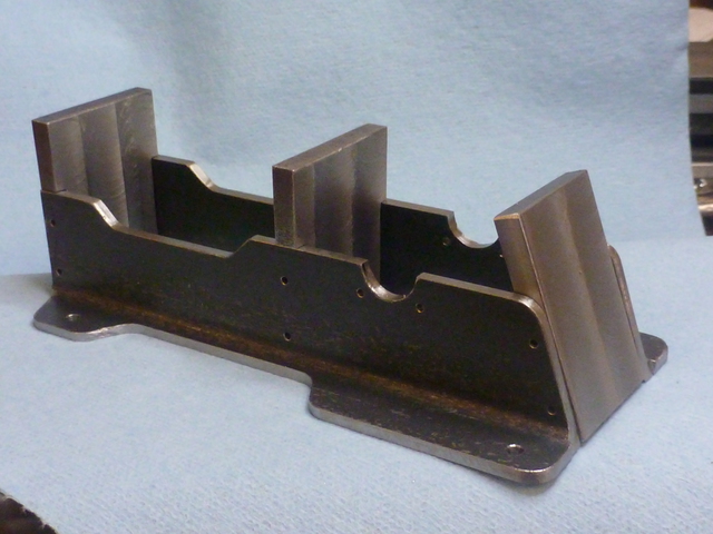

Three frame cross-pieces were sawn from a chunk of cold-rolled steel and milled to 1/4" thickness. All work to this point was done manually with the Bridgeport. The next shot shows the raw cross pieces roughly in position in relation to the side pieces.

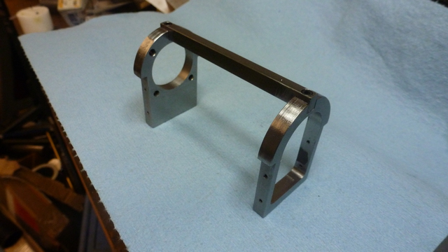

It often happens that I get "into the zone" and forget completely about the camera. Such was the case when I shaped the front and mid cross pieces with a series of CNC operations. The large hole and the four cylinder mounting holes in the front piece were drilled and bored at the Bridgeport before the outside profile was done by CNC. The inside of the middle cross piece was CNC'd out.
The cross pieces were drilled and tapped for the 0-80 cap screws that will hold the frame together. The rear cross-piece still needs some sawing and shaping.
The pivots where the Robert's mechanism mounts to the front and mid cross pieces need to be accurately aligned with respect to each other. To maintain alignment while the frame is assembled, I connected the cross pieces with one long bar. Later, after the frame has been finally glued and screwed together, the pivot holes will drilled, and the middle of the bar will be sawn away.

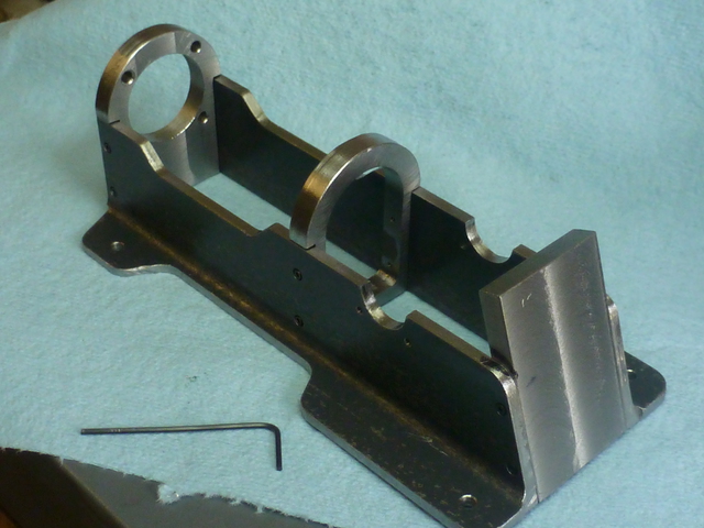

Here's the frame fabrication after epoxy was applied and the screws tightened up. I'm sure JB Weld would have worked fine in this application, but I wanted to try a Loctite product "Epoxy Weld", which seems to work fine.

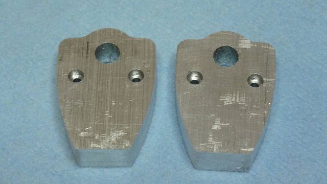

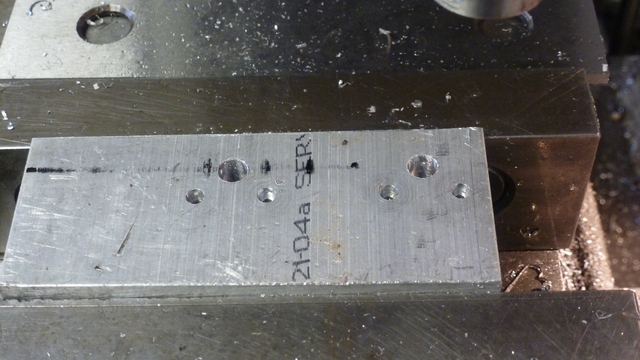

The crankshaft will ride in plain aluminum bearings which are part of the fabricated frame. At the Bridgeport, a chunk of aluminum stock was drilled with countersunk holes for mounting to the frame, and also undersized holes for the crankshaft.

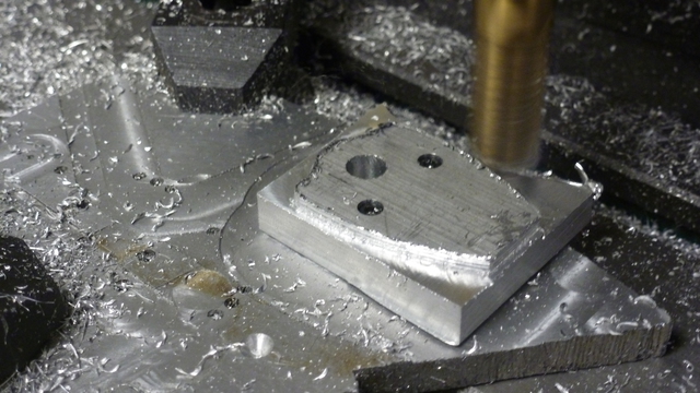

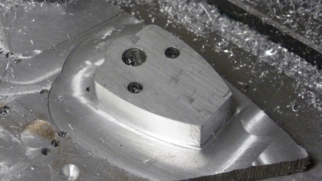

At the CNC mill, the first bearing block was screwed to a sacrificial plate which had been drilled and tapped to match the frame mount holes. A series of roughing outline passes proceeded, followed by a finishing pass at full depth.
The second bearing block blank (which was separated from the first by the roughing passes above) was attached to the same tapped tooling plate holes and the identical programs run again.

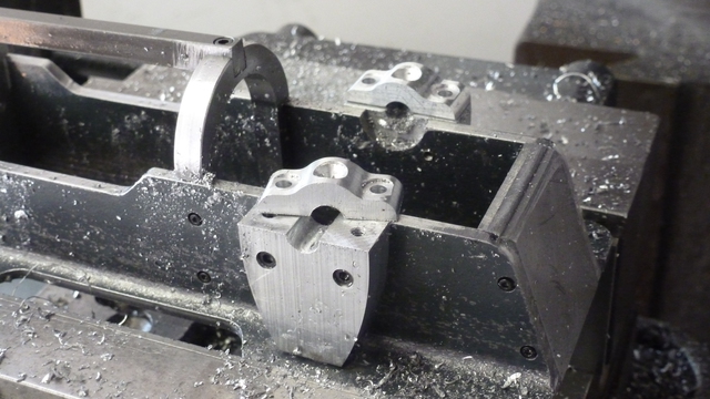

Here are the bearing block pieces ready for mounting, and then glued and screwed to the frame sides.
Now the bearing caps could be sawed off at the Bridgeport. Here I realized that pre-drilling the crankshaft bores was unnecessary and silly, but not a show stopper. Life goes on.

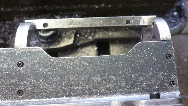

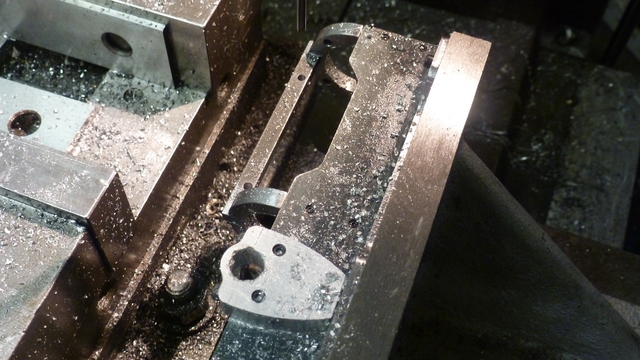

With the bearing caps now screwed on tightly, and the frame mounted on an angle plate, I drilled and reamed the crankshaft bearings.

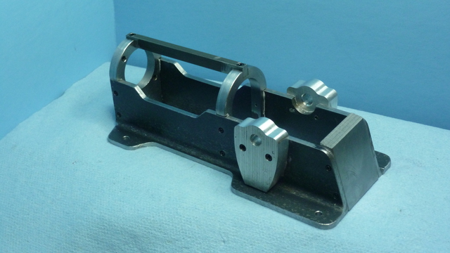

In the same angle plate setup, I drilled the pivot holes for the Roberts linkage and also side-milled the front plate where the cylinder will mount. These crucial elements will now hopefully be square to each other.
The linkage pivots were supposed to be centered on the bar, but you can see they ended up low. The holes are located properly relative to the crankshaft though, so somehow the bar ended up a little high. Not perfect, but again not enough to stop the show.
