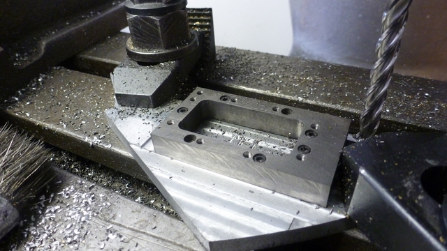

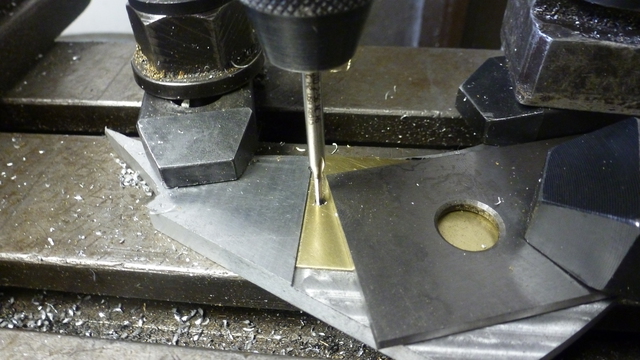

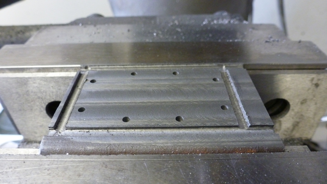

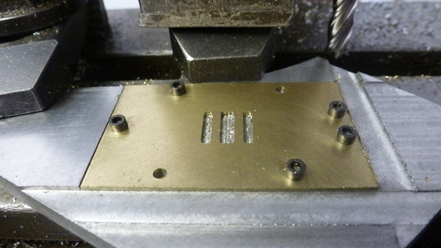

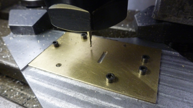

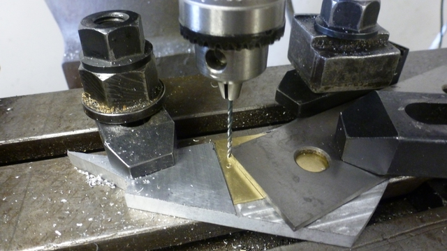

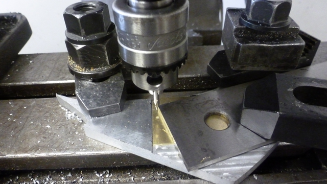

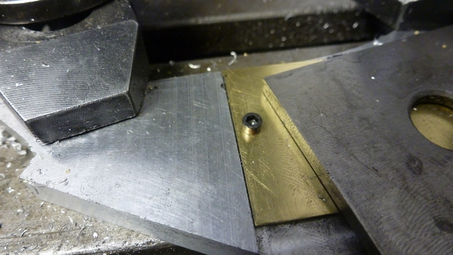

You may remember that the cylinder passages are terminated in drilled holes in a flat valve face. on the cylinder. I now had to make a port plate for that face to provide the actual ports that the valve will operate against. The part is simple enough, but the placement of the port slots is critical, and the thin (1/32") brass used requires care in clamping. I started by clamping a scrap of tooling plate to the mill bed and milling a recess to locate the plate.
Note that by running the corner of the recess off the edge of the tooling plate, I eliminated the necessity of milling a square inside corner. The brass plate had been squared up on the sides which meet the sides of the recess. The other 2 sides are cut oversize and will be milled off later in this setup.
The locator recess allows me to move a single clamp around as needed to access the perimeter of the plate. I used a parallel to spread the clamping force.

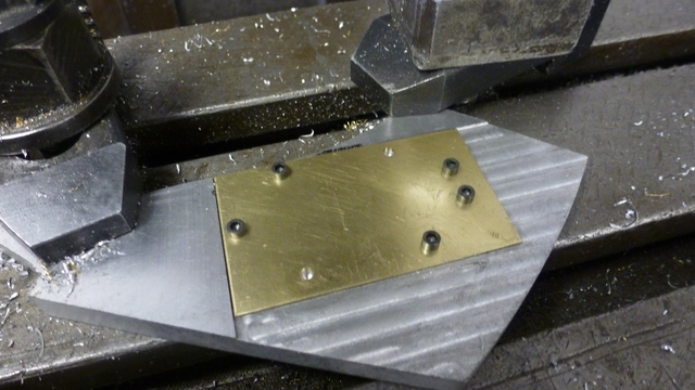

I first drilled for 4-40 threads, then drilled only through the brass for 4-40 screw clearance, then tapped 4-40 into the tooling plate. A clamping screw could then be placed.

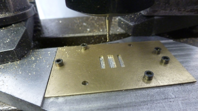

By moving the clamp around and repeating the process, I drilled all mounting holes and provided for enough clamping screws to proceed with cutting the port slots.
Cutting the port slots.
Then I milled the two unfinished edges to size.
The cast iron steam chest is a part which has not been documented here. I made it one day while "in the zone" and in the shop without a camera. I had left the outside edges unfinished. How convenient that I now had this ready fixture with the correct holes tapped for clamping to finish the job.
One thing to notice about the otherwise nice steam chest is that there is an unintended center drill in the upper left corner. Harmless enough, and it will be hidden by the cover, but another mindless and maddening mistake. The steam chest still needs the male portion of the packing gland turned on the right end as pictured. It also needs the steam inlet port drilled and tapped.

wouldn't it have been easier to drill through holes in the steam chest and use one set of bolts, sorry screws, from the cover to the cylinder instead of a two stage attachment?

Hi Steve,
That would have been easier to build, but I want to be able to take the cover off without disturbing the placement of the steam chest. I'll want to time the eccentric, for instance, by removing the cover. Since the valve rod goes through a hole in the chest, I want the chest to stay put once I have aligned it, to prevent jamming of the rod. That is at least my reasoning.

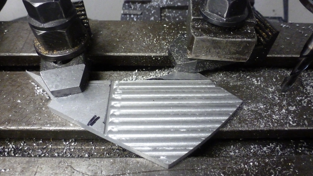

I managed to make the steam chest cover from scrap cast iron I sawed off to make the cylinder. Here you see one side of the scrap plate milled flat and drilled for screws. I outlined the outside dimensions of the cover with a 1/8 inch endmill.
I then sawed near the milled lines leaving some for cleanup. Finally, back at the mill I cleaned up the other side, and cleaned up the saw lines at each edge using the previously milled outline as witness.

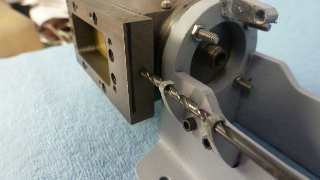

I mounted the chest on the cylinder with the brass port plate, and with the cylinder mounted on the frame, I could then use a drill bit through the valve rod guide to mark the exact location for the valve rod hole in the chest.

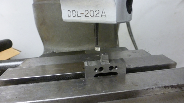

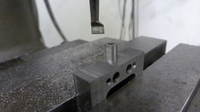

With the rod location marked, I centered the mill's DRO on the mark and drilled the rod clearance hole. I then cut away excess material around the packing gland boss.
I used an inward-facing tool in the boring head to cut the boss round concentric with the drilled hole. The boss was threaded for the packing nut using a die holder in the same setup.
