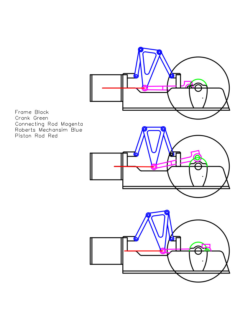

The subject of this build is a kind of novelty engine. I don't know of any similar full-scale engine, and I can't think of any reason why one would (or should) have existed.
"Robby" resembles a conventional horizontal mill engine, but instead of a crosshead and guide, he features a straight-line motion to guide the joint where the connecting rod and piston rod meet.
The use of the straight-line motion was the usual practice in the days of beam engines, and in those days the mechanism most commonly used was Watt's linkage (an invention of which James Watt was rightly proud).
The linkage used here is known as the Robert's mechanism, and is chosen because it is different from the usual Watt's mechanism. Thus Robby's name.
I hope to build an engine that will be somewhat entertaining to watch, and might evoke conversation. In other words, an engine tailor-made to show at model engineering expositions.
The following sketchy drawing is a side view of the engine with the crank in 3 different positions to show the general motion of the Roberts mechanism (in blue). Note how the joint at the bottom of the triangular link guides the end of the piston rod in an approximately straight line.

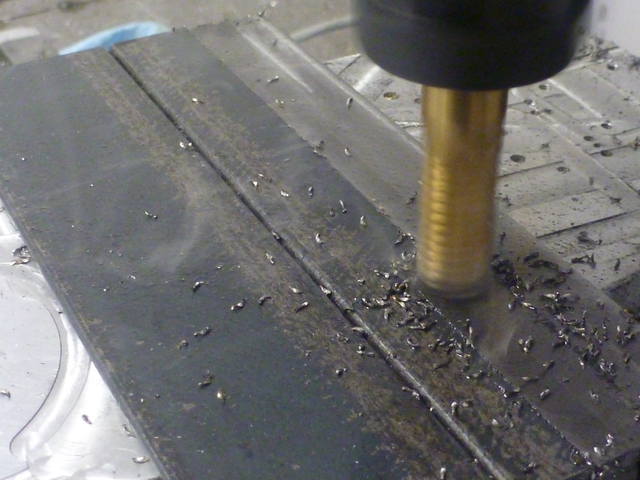

The engine frame is fabricated. The sides from hot-rolled angle stock, cross pieces from cold-rolled steel, and bearing blocks from aluminum.
The constituent parts will be epoxied and screwed together. The screw heads will be inset and covered over with epoxy to attempt the appearance of a one-piece frame casting.

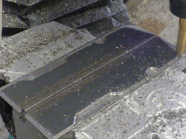

First two lengths of angle stock were placed back-to-back in the CNC mill vice, and the angle legs which will form the frame base were faced off. I used bits of sacrificial aluminum to maintain a separation between the work and the vise.

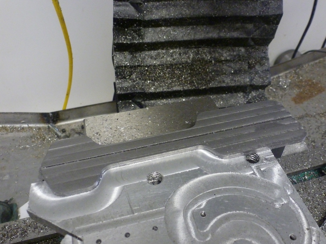

The base portions of the two frame sides were profiled by CNC. Here is a preview screen shown by the LinuxCNC control software. Before setting the machine loose to do what it would, caution was in abundance, I studied the screen for a while to verify that the cut paths were what I expected.

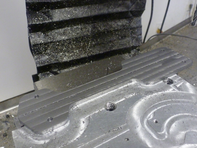

Roughing of the profile proceeded in several shallow passes, leaving stock for a full-deoth finishing pass.
The roughing passes complete.
A finishing pass at full depth was done with a smaller endmill.
With the finishing pass complete, base mounting holes were drilled. The second photo shows the two frame halves at this point.

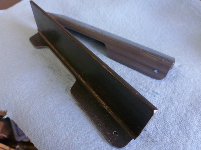

The completely profiled base legs were then clamped back-to-back in the vise, and profiling of the frame sides was commenced.
Roughing first:
After a finishing pass, both sides are shown profiled. Note also that holes have been drilled for cross-pieces to join the sides, The photo does not show well that the holes are counter-bored so that the joining cap screw heads can be hidden.
