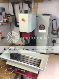

« Reply #26 on: August 02, 2015, 11:39:19 AM »
Here are a couple of pic
at the left is the pipes fore the one shot lube system
note the rt is a 100 mm one
engine room
note the holes are the ser. no.  I have blanked it because you can use it to reg on the support rite
The WS is a mess please excuse a new toy comes in and they make a mess
if you look the front of the thing is over the bench but a heavy steel angle is to be bolted on to provide support although the thing is very rear end heavy weight wise its 80 Kg
« Last Edit: August 02, 2015, 11:43:11 AM by Stuart »
