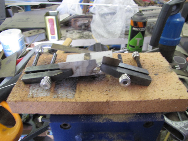

 Having made the engine mounting & it's feet, they needed to get soldered together. No soft solder for this one, silver solder is needed for a high-strength joint.
 With the back edges of the feet a bit round from bending and difficult to keep square, I decided to use a piece of aluminium angle to keep everything together and nice and square, and to let the silver solder flow onto the "round" part to make the mounting nice and flat. It looked so good all set up and fluxed, ready for soldering:
 Used my oxy-butane kit to heat up one side; flux bubbled, flowed & I needed "just" a bit more heat for the solder.... then the ally called it quits:
 Sorry; poor photo; I was just a tad annoyed. Might have worked with thicker aluminium, might not...
 So I left everything, including myself, to cool down, cleaned the parts up again, and used bits & bobs to hold things in place and re-did the job:
 Dumped the mounting in citric acid for 1/2 hour - came out OK; I overdid the silver solder on the one foot, as it moved while doing it. I'll clean the excess off later and neaten up the mounting:
