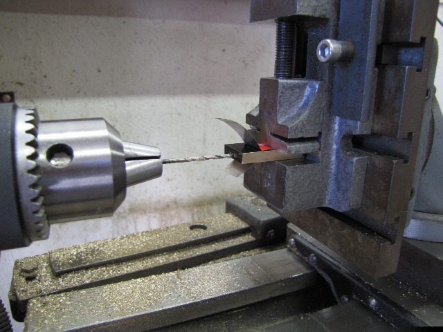

 Some quality time with the measuring instruments followed, and then a lot of hole-drilling. Part way through chain drilling for the cut-outs, the heat generated started to melt the superglue and the one end of the plates wanted to come apart, so I had to clamp the plates on that side. I let things cool down and drilled the last couple if holes. More filing still required:
 Next up was a lot more filing. It was 34 degrees here today, so it was hot job to do the filing, and once done, I called it a day. End of day's work - not much for all the time spent! - Frame sides done, and some 6mm angle:

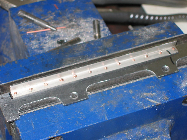

 I have never in my life done riveting, except for pop-rivets. Searching around locally, I could not find suitable ones for the project, so some improvisation was needed.
 After some testing, I came up with a method that seems to work OK. A piece of 1.5mm copper wire, a pin with a hole drilled in for a short length, and a pin with one end turned down to get in the tight areas, and the point dimpled with a drill to help form rivet heads (sorry for out of focus):
 First off, I insert the wire through the plates and into the hole in the pin clamped level with the top of the vise:
 Then clip the wire off a short length above the plate:
 Hammer it down with the dimpled pin:
 The half-formed rivet already stays in place and holds the plates together, but pulls easily out of the bottom pin, so I just did all the rivets on one side (the inside where the "mess" I made will not be as visible  :paranoia: :
 Then turned the whole assembly around - here you can see the other sides of the rivets showing:
 I then clipped all the rivets evenly to about 1mm length with a side-cutter and used the dimpled pin to form the rivet heads. By having the excess to an even length, a fairly uniform row of rivet heads were formed on the "presentation" side. End of work today showing one side plate's "inside", the other the presentation side:

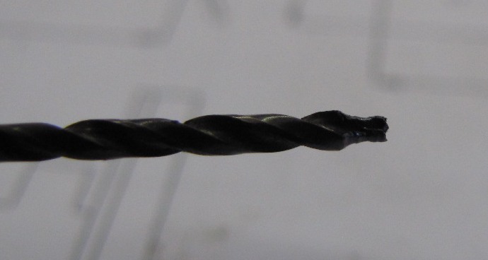

 Yesterday evening, I finished the front and rear frame plates. Just more sawing & filing & paint removal & hole drilling, so not a lot missed without having a camera.
 I made one build "error" so far; I didn't drill & thread the angle pieces that would make the front & rear frame plates bolt to the side plates before riveting the angles to the side plates... Drilling & tapping the holes were now pretty difficult. To do this, I used some threaded rod through the holes for the wheel bearings to set the side frames to the correct width apart. A strongish magnet helped to keep the end plates in place so that I could clamp them up:
 As I had to manage the entire frame, and had to drill on the ends, I decided that it might be easier to just clamp the whole assembly in the bench vice, and drill the 1.6mm holes with the Dremel. BIG mistake. My 20 year old Dremel does not have speed control and runs at 15000 rpm (I think), and on the second hole, I didn't dive in positively enough, and this happened to the 1.6mm drill bit because of friction:
 This also work-hardened the hole in question a LOT!
 After that, I "fudged up" a way to hold the assembly in the drill press. I couldn't properly clamp it, so held it by hand with the toolmaker's clamps resting and providing some support in the ring normally used to secure the drill table. Forgot to take a photo of that setup; if anyone's interested I can take a "staged" one at some point. Fortunately, I had a couple more 1.6mm drill bits to finish the job. The work-hardened hole blunted another one...
 Tapping the holes was fun. All went well, except for the work-hardened hole... I broke a tap for the first time in my life; so destiny has finally caught up with me; it was bound to happen at some point:
 Fortunately the hole was nearly done and the broken bit came out easily with the automatic center punch. I just _very_ carefully used the plug tap to finish the hole; lots of to-ing and fro-ing, and lots of lube.
(2 1/2 years later, this is still the only tap I ever broke :agree: :) - I hope that doesn't jinx me now :facepalm: )

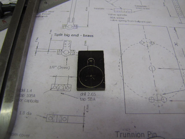

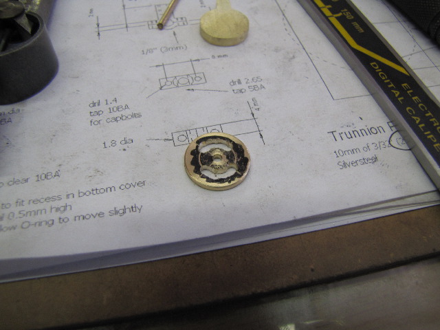

First up, cut a piece of brass flat bar and marked out the top section of the reversing spool valve:
 Hacksawing to rough shape - a lot of filing followed, but I did not take a photo of the end result:
 Some brass turned to diameter & laid out for the bottom section of the spool valve. I used a 1mm center drill to just dimple the front of the stock to get the center point, then compasses to mark out the radius. A light scribe with the cutting tool tip (has to be dead on center) by cranking the cross slide marks the first cross line, then, taking advantage of the myford's flat ways and a square, rotate the chuck with the line vertically square and mark again with the cross slide:
 Then drill the 2mm center hole, and part off using the shank of a broken 1.6mm drill bit in the tail stock to catch the workpiece:
 Made a little jig for the drill press; just some offcut mild steel slightly wider than my toolmaker's clamp; drilled a 2mm hole part-way through it & stuck a bit of 2mm brazing rod in the hole & clamped in the drill vice. The spool bottom's center goes over the pin, and I clamp it with the toolmaker's clamp. A 2mm center drill is put to use to drill curve approximations in the workpiece:
 In use:
 And done; a little filing required still... at the top of the photo is a partial piece of the top of the valve after filing that I forgot to photograph earlier:
 Next up, I turned the end of a bit of ~5mm aluminium down to 2mm for a tight fit for the spool valve's top and bottom parts. This is for alignment while soldering them together, without getting everything stuck too much to the pin. A trial check before soldering:
 Some 0.5mm solder rings & pieces put on the top part - if you look carefully, you might also see 6 light punch marks around the perimeter to keep "just" a little clearance for the solder to flow between the 2 parts:
 Other part was put back on top, and I just heated the whole lot with a butane torch. When the solder started flowing, I pressed the parts together with a heavy piece of mild steel placed on top, and let the lot cool. End result (too much solder  :-[ ):
 I then spent some time with a scribe & drilling bits in a hand-held chuck to clean out the excess solder manually.
 Next up, it was on to the big ends. Some brass bar - long enough to make both big ends centered in the 4-jaw and turned down on one side; I then drilled & tapped the end M3 for the 3mm stainless steel connecting rod.
 Lazy rotter that I am, I then just fit the collet chuck & reversed the part for doing the other end. This could easily spell disaster, but my cutting tool is nice and sharp, so no problems. Best would have been to use the 4-jaw again and just spend the time to center everything... :
 Next up was drilling 1.4mm holes for threading for the big end bolts. The Myford's a bit slow for drilling these holes, and the pedestal drill, while capable of reaching the speed needed, just not accurate enough. What to do? I have drilled a couple of thousand of holes in PCBs with my Dremel and it's small press; not entirely accurate either, but might just do the job. So I mounted the parts in the myford's milling vice and gave things a go with the Dremel in it's stand:
 Worked a charm  :)
 I used a slitting saw to slice off the end caps of the big ends; much less work than trying to saw & file to size:
 I had to spend a couple of minutes searching for the first one slit off through the swarf behind the lathe  :-[ ... - the second one was prevented getting flung away by stopping _just_ short of it coming off, manually breaking it off & filing away the left-overs.
 Rob (Thanks Mate!!!  :NotWorthy: ) sent me some 10BA taps. These are worth more than gold to me, so I first (crudely, but effectively) made a tapping guide and tap holder to tap the big ends from HRS I have lying around. Clamped the workpieces in the Myford's milling vice and went for it, with very nice results. First photo shows the setup, guide & holder. Next is a close-up of the result:
 Finally, the results of today's work... Not much to show, but most satisfying  :)
