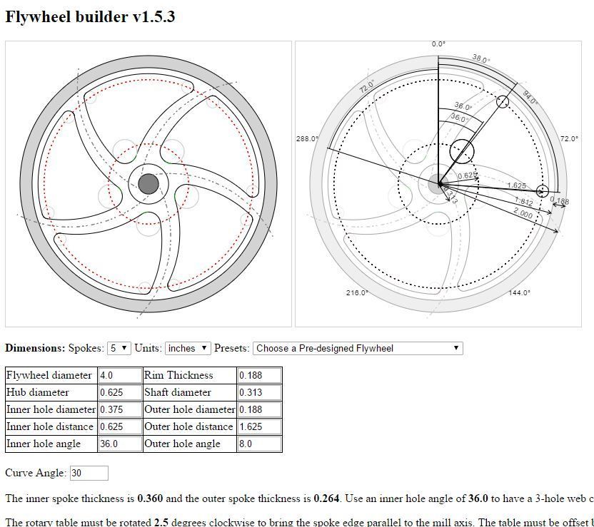

I'm mulling around trying to think of where I should go with this.  I know Marv has a website with a pile of software, and there are no doubt others.  When I was creating the flywheel for my pottymill horizontal engine I got particularly interested in software to assist designing flywheels.  And, as I'm into software for a living, but only get to do architecture work these days, I took the opportunity to write a little fun code :).
All I've got so far is a tool for flywheels.  Nowhere near what Marv has.  I decided I wanted it to be a bit interactive, though, and I wanted it to be graphical.  That is, I really wanted to be able to visualize what I was about to create without having to go to the drafting board to draw it up.  That's how this got started.  Add to that was the fact I didn't really want to write a full app, but I did want it to be usable offline.  So I cooked it up as a standalone web page with javascript.  I'm actually quite amazed at how well it works.  The web has come a long way since I did a pile of work with it in the mid 90's.
Ok, enough talk.  Here is a screen snap of what it looks like so you don't need to actually run it:
Right now you have to pick the number of spokes from the little pulldown box (I offer 1(!) to 9), and you need to type numbers in the little boxes to adjust things.  The flywheel instantly redraws when you tab out of a box.  I'd like to make everything drag/drop, and I'll do that, but right now I want it to produce the "right stuff" for machining a flywheel.  I'll add the snaz later.
I've only tested it in the chrome web browser (both Windows and Android work fine).  It works with Internet Explorer 10, but the dotted lines will be solid (from what I read this is fixed in IE11 which I don't currently have).  Haven't tried Firefox, Safari, or other browsers.
Also note that it'll let you type nearly anything and create flywheels that don't make sense.  At the moment I find that rather amusing, but perhaps at some point I should at least highlight that an error exists.
Anyone dare to try it?  I don't have a website to stick it (too bad, that would be easy), but I will attach it here.  Just download and open it in the browser (i.e. drag/drop it onto your browser and it will open).  Internet Explorer will ask if it's ok to run.  For any software folks out there, feel free to browse the code and make suggestions.  It's smaller than you think.  For everyone else, I'm really looking to see if this is useful to anyone, and what you'd really want to see it do.
Todd
P.S. if you want to try this on your Android phone or tablet, the URL will be something like file:///mnt/sdcard/Download/FlywheelBuilder.html  It's more tricky to open since you don't have drag/drop.  I'd expect it to work on an iphone, too, but have no clue how it handles security (i.e. is it ok to run javascript from a downloaded file?)

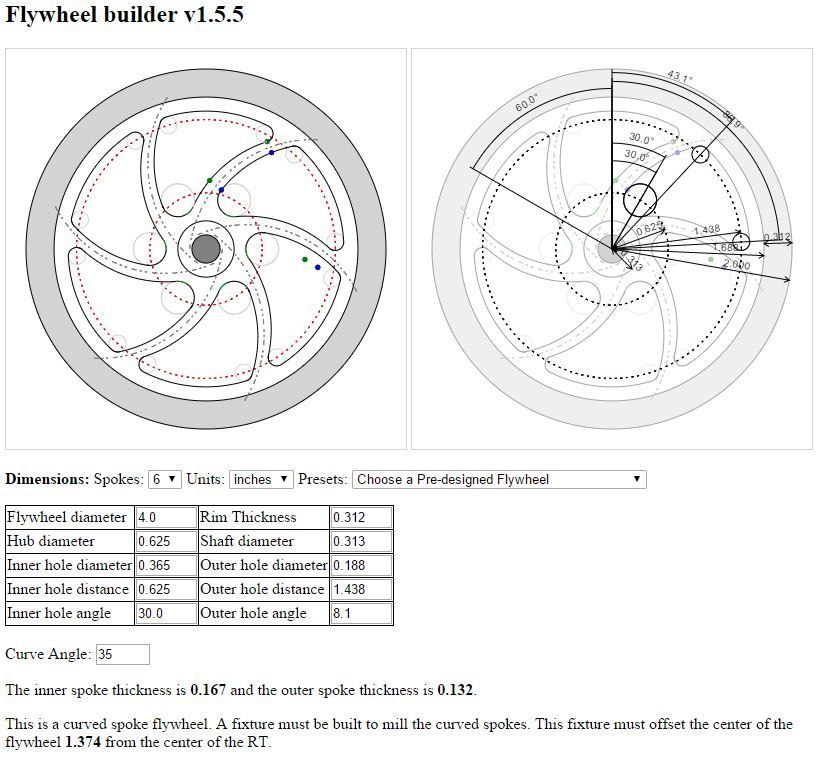

Wow, thanks for the quick feedback!   Good to know it's already working in some browsers, though I need to figure out what's happening on that ipad.  I wonder if it isn't opening in a full web browser (whatever that might mean).
I hadn't thought about producing scale printouts, though I have been careful to try to keep it on a single page so you can print it and bring all the numbers into the shop.  It's possible I could create a "Printer Friendly Version" button that produces that printable version.
I had thought about DXF and a friend already suggested it might produce G-code if it had a little more data about the z-dimension.  I don't think those are crazy ideas...they'd just take time as I don't know either format.
What about the data its producing?  Maybe I should carefully write instructions as to how it is machined using this data.   I have pictures in my pottymill engine build log, but it didn't refer to this sheet.  That might scare something out.  I don't recall needing anything that wasn't on the sheet.
I do want to add some interactive features so you can drag things around.  I also want to add dimensioning lines in the picture, though I might have it draw a second picture so it doesn't get too busy with numbers (or a button to hide/unhide the dimension lines).
The big kahuna feature I want to add is the ability to do curved spokes.  Does anyone have experience with this?  I think I can figure out the math, but am wondering what really needs to be adjustable.  At the moment I'm imagining it holds the hub still while you twist the rim and it curves the spokes to make it fit.  But this may mean I need to allow more flexibility with the hole sizes.  If I recall, Marv's FLYWHEEL assumes 3 holes, and I already expanded that to 4.  I only allow two hole sizes, though, and this may need to be expanded to allow specification of each hole size for all four holes in the web.  That's getting complicated for a user to understand.
Todd

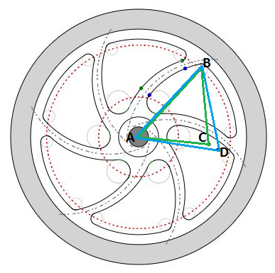

Todd,
A convenient mathematical approach to defining curves of the type seen in curved-spoke flywheels is to use three point Bezier curves.  Such an approach allows one to smoothly and continuously alter the shape of the spoke through an infinite range.
However, the real task with such spokes is to define where to drill the holes that define them and provide the user with a simple machining schedule to use in producing them.
Another program feature that may be of use to some users would be an approximate estimate of the moment of inertia of the flywheel using a unity density for the material.  This would allow users to compare the moments of two designs of interest.  Not a biggy but something to think about in the shower.

I was initially thinking Bezier curves, but I'm unsure how practical they would be to machine.  You've clearly done some human assisted machining in the past, and perhaps schedules of cuts would do the trick.  But I was thinking my first crack at it might be a bit of a cheat and I'd instead produce two arcs to connect the holes.  That means it would be limited as to what it could produce, but they might still look good enough that you wouldn't think twice unless you were trying to match some photo.
