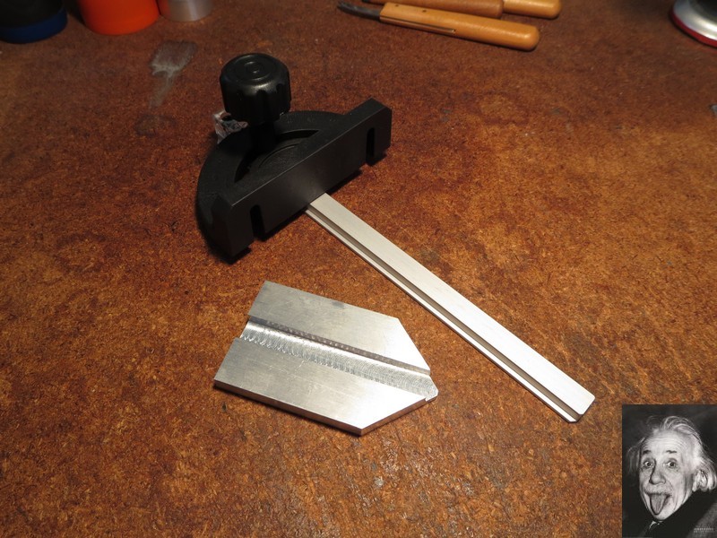

although I like my large bench drill, but because most of the parts I make are small I find the slots in the table too wide for my needs. So like most people I dare say, I take to bolting parts to various sub plates / angle plates etc. but what I really want is one fixture that could replace the various angle iron / scrap blocks that I've accumulated and are now lurking somewhere in the shed.
I decided that what I wanted was something that would allow me to drill cross holes reasonably accurately in round bar , could hold round bar (or conrods) vertically and give me decent vertical  and horizontal clamping surfaces. I also wanted to make it out of some of the larger pieces of flat bar I had.
this is what I eventually made (you can see the original mk 1 version to the left of the table)
made out of 8mm flat bar (except of coarse the wide side which is 20mm) purely because I already had enough of the stuff, the only thing I had to buy was the cutter for the vee grooves.
heres how I cut the long vee on the table top. not a job the peatol was designed for!
the base was clamped to an angle plate while the edge rested on two pieces of flat bar to raise it to the desired height. Then it was a case of feed in about 25mm , unclamp, move along etc. A slow job. The base is 150mm long.
Incidentally, the cutter is a 120* multi flute counter sink. And yes I did have to first cut a groove with a 1/16 slot drill to allow it to cut.
I chose 120* over 90* because it allowed me to cut a wider groove than what a 90* cutter would. (don't forget the plates only 8mm thick)
here's the top. I was surprised not to see more chatter marks, most of which where easily removed with a few strokes of a flat file
