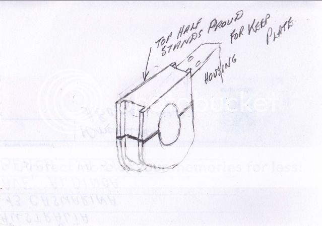

This weekend I have been working around the Double Tandem Compound?s crank:
The original design for the crank top plate was a simple piece of 1/16? steel drilled for the studs and tapped for an oil pot. However the depth of the bearings was 5/64? shallower than the cut out shown on the crank supports on the drawings, leaving fresh air above the bearings :facepalm:. So my initial redesign of this plate looked to take up the air gap. But it still didn?t look right so when it came to the painting I decided to modify it further using a couple of off cuts of gunmetal that had come to me in a pile of ?come in handies?:

Offline Maryak
  • Posts: 1818
Re: Double Tandem Compound Horizontal Mill engine.
« Reply #25 on: August 20, 2012, 09:05:12 AM »
Hi Jo,
Its coming along very nicely  :NotWorthy:
Normally with this type of bearing, the top half brass stands proud of the housing and a substantial flat keep plate is employed.
viz:
Hope it's useful.
Best Regards
« Reply #26 on: August 20, 2012, 09:17:48 AM »
Totally agree Bob :ThumbsUp:,
I intend on adding a 1mm shim below the bearing to make sure that the cover does indeed press down of the bearings.
