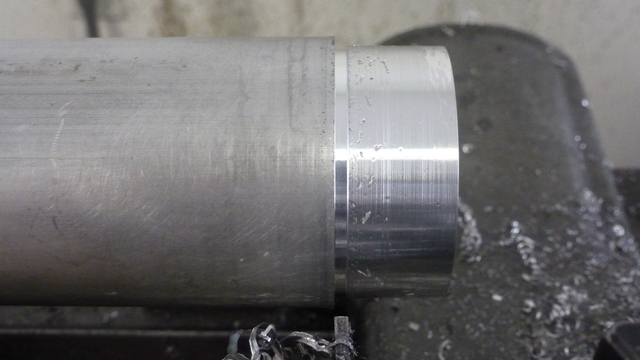

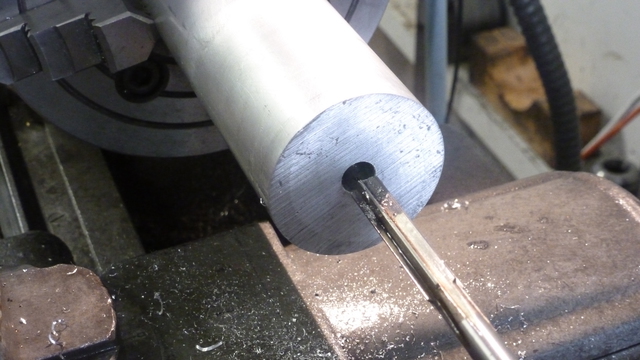

Starting with a length of 2" aluminum stock, I drilled and reamed for the lead screw shaft. All done with a considerable length extended past the chuck to avoid wasting stock.

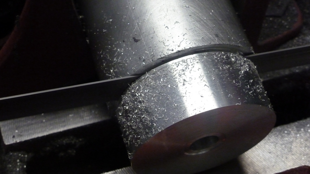

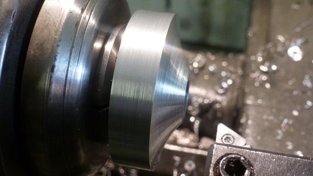

I faced the end and turned down some diameter, though far from the final dimension, then began a parting operation which quickly led to chatter because of the long extension.
No matter, as I simply took it to the bandsaw to complete the cutoff. The initial lathe cutoff groove provided a good guide for the blade.

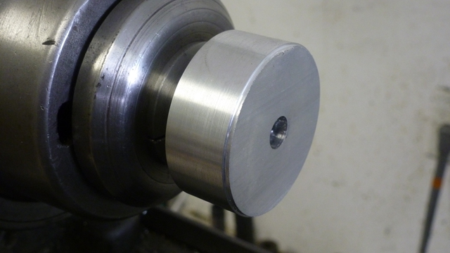

Now mounted on a purchased mandrel, it's back to the lathe in a collet where both ends end the diameter are finished square.

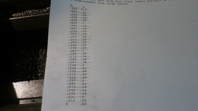

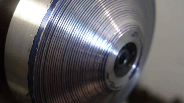

I had drawn a curve in CAD to somewhat replicate the dial on my cross-slide.  This dial is basically a scaled-down version of that one. I picked off steps from the CAD drawing a created a step-off chart for machining the curve.  Steps are in decreasing radii of .02 inches. here's the rough-machined curve and a shot of the chart with each step penciled out as I had finished it.

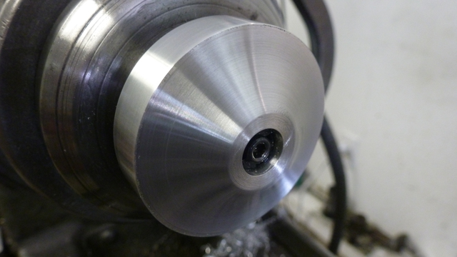

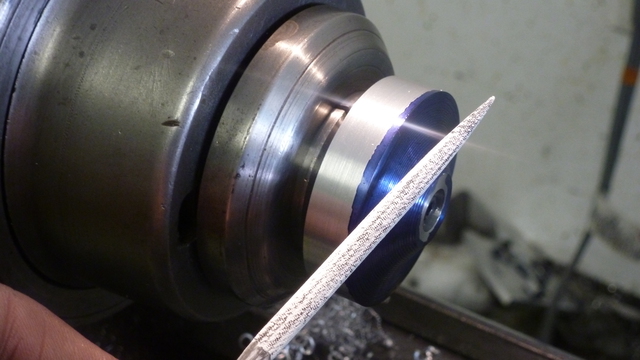

I blued up the steps as a visual aid in filing the curve smooth.  I'd read somewhere that filling a file with blackboard chalk would help prevent it filling with aluminum as filed. The chalked file is shown. The jury is out on the success of this attempt. In fact that file still has some aluminum embedded that I've not been able to get out.
Here I'm half way through the filing operation. This shows how the bluing assists in monitoring progress.

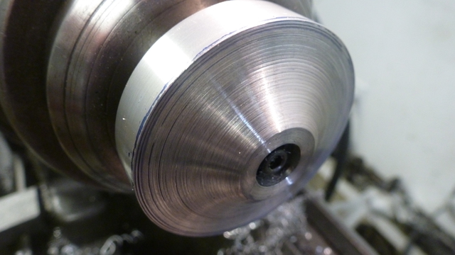

Here I've finished filing.
And here's after application of a couple of grades of sandpaper.

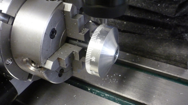

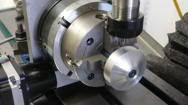

And now to an exercise of the new 4th axis I've added to my CNC machine.  It's a Sherline "CNC ready" rotary table which needed just the addition of the stepping motor. I had anticipated this when configuring the machine, so my electronics were already 4th axis capable. I've got an engraving tool with a 60 degree included angle point in the spindle
The photo's a little glaring, but here's a progress shot. This was not the first time the program had been run. I ran a test piece about 3 times to "dial' it in (the pun just occurred as I wrote).
Jumping straight ahead, some coloring has been applied to the engraving, and it's been drilled and tapped for a purchased thumb screw
Had to do over again, I'd use an engraving tool with a smaller included angle, so the engravings would be finer.

Re the aluminum "pills" sticking in the file...
Take a small piece of scrap brass sheet and push it's edge along the file teeth in the direction the teeth slant.  Very quickly you'll wear teeth into the brass that exactly match the pitch of the file teeth.  The brass teeth will dislodge any aluminum that's managed to bond itself to the file.
If you have un-reloadable rifle cartridge cases you can flatten the business end and use it as your custom file scraper.  The body of the cartridge then forms a nice handle.

On the subject of chalking files to avoid pinning...
I've seen the old-timers write that one must use "railroad chalk" (their term, not mine) rather than the more common blackboard or "sidewalk" chalk.
Now, I have no idea what "railroad chalk" is; my guess is it is used to write destinations on the outside of freight cars.  Or maybe the hobos who ride the rails use it to indicate which houses will provide a free meal.
The stuff I use is about one inch diameter and seems soft compared to blackboard chalk but, hey, I'm no chalk connoisseur.  It sort of works but, like Guy Lautard and some others, a thick coating of oil seems to work better.  My idea is that, hey, it's a cutting tool and we use cutting oil when we use cutting tools on the lathe so...

Marv, I had heard the trick with brass, but probably didn't understand it. I tried just filing a piece of scrap brass afterward with little joy. I'll read what you wrote over and try again.
I was picturing myself doing it and didn't think to make the description sufficiently clear.
Hold the brass sheet at an angle of about 45 degrees to horizontal and push its edge along the teeth in the direction the teeth run, i.e., NOT perpendicular to their edges as in normal filing but rather parallel to the edges.  Because the brass is soft and the file teeth are dead hard, the teeth will quickly wear their profile into the brass and the edge of the brass will begin to look like a saw blade with teeth whose pitch perfectly matches the pitch of the file teeth.
