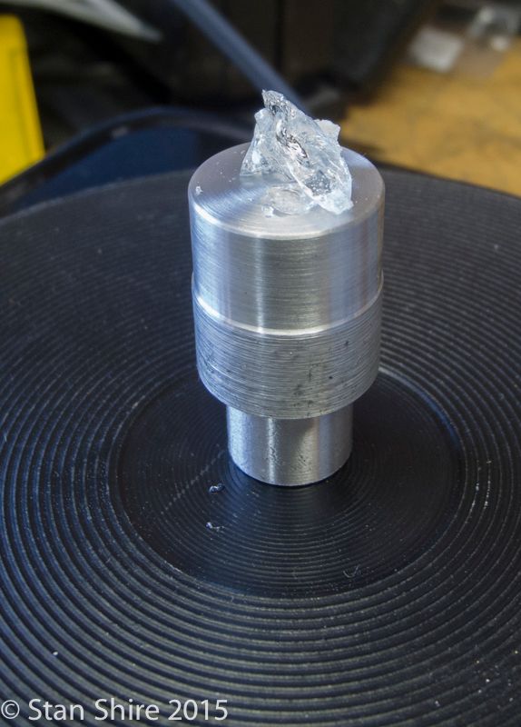

It’s always useful to look at some applications in other fields to see if they might be useful for our engines. Sometimes, a small part is “unholdable” except by some adhesive. I admit, I’m a glue-aholic. I love VHB tape, Super Glue, all varieties of Loctite and chewing gum.
Last week I was watching Tom Lipton’s weekly offering on YouTube when he showed an adhesive used in laboratories, silicon chip fabrication and other tech areas. He attached a penny to a round blank, chucked it up in the lathe and proceeded to face it down to almost nothing.
The stuff is called “Crystalbond 509.” There are other formulations, but the 509 is the strongest.
Here’s my recreation of Tom’s experiment.
Here it is in person. Hard as glass at room temp.
After chipping off some small chunks.
A piece of 6061 on a hotplate with a few chips on top
When the aluminum reaches 250º F., the Crystalbond melts.
A penny.
Pressed into the melted Crystalbond. The instructions suggest building up a fillet around the edge. I had enough CB that it formed a fillet.
Next, the instructions specify a 20 to 30 minute cool down.
Then, mounted on the lathe.
A light facing cut. Carbide insert; 1000 RPM.
There was no indication of movement or loosening so I went for a .020 cut.
After a few face cuts and the copper cladding was gone, it became difficult to tell if I was cutting the penny or had gone into the aluminum. I stopped.
A quick hit with a heat gun and the CB melted and a cleanup in Acetone (recommended solvent) removed any traces.

I can also see this for milling thin parts, etc.

Lets take out the Magic:
Crystal Bond 'appears' to be a normal thermoplastic adhesive. It may have a high shear strength but so do other non thermo-plastic adhesives like CA or Expoxy. Both CA and Expoxy can be "debonded" by the application of heat or the correct solvent!

« Reply #13 on: February 21, 2015, 10:59:19 PM »
Agree, but...
Epoxy is not a viable option. Too difficult to release and remove. I've had marginal success with CA. I think the advantage with CB is that an uneven surface (like the penny) is fully supported.
I'm sure that this isn't the only thing that will work here. Just one more option.
