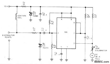

This design should be able to function as a tach, spark generator, or both. It will be digital, but it is easy enough to add a filtered PWM output that can drive an analog meter, if desired. A fully analog tachometer operated from the points or cam position sensor is fairly easy to build, using a frequency-to-voltage converter.
Here is an inexpensive (under $2) IC that can be used as a tachometer as well as many other applications, and some circuit diagrams are supplied:
http://www.ti.com/lit/ds/symlink/lm2907-n.pdf
http://www.mouser.com/Search/Refine.aspx?Keyword=LM2907
Microchip has a more expensive ($8) device (TC9400) that can do both F-V and V-F conversions:
http://ww1.microchip.com/downloads/en/AppNotes/00795a.pdf
http://www.mouser.com/Search/Refine.aspx?Keyword=TC9400
Here is a simple circuit using a common 555 timer:
http://www.seekic.com/circuit_diagram/Automotive_Circuit/DISTRIBUTOR_POINT_TACHOMETER.html
Here's a compilation of many links for tachometers:
http://www.discovercircuits.com/T/tachometers.htm
Here's a very simple circuit using just one transistor:
http://josepino.com/circuits/?tachometer-circuit
HTH. Enjoy!
PS: Here is a sample of a digital version using a PIC18F452:
http://www.pyroelectro.com/tutorials/digital_tachometer_rpm/schematic.html
The choice of processor is rather arbitrary and only 12 I/O lines are needed, mostly to drive the LCD display. I plan to use a module that accepts the three I2C lines from the PIC so only one more is needed for measurement. I may also add a Bluetooth module to the RX/TX lines so that a handheld device or laptop can read and log the RPM data, and possibly also adjust timing parameters and other things.
