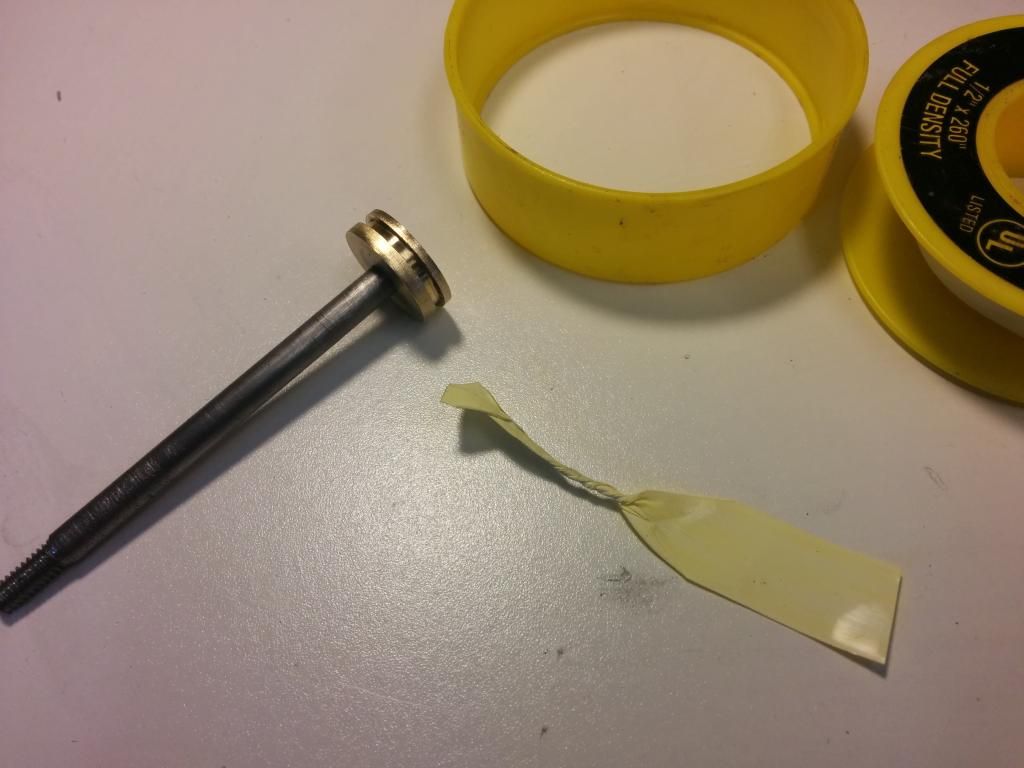

Vince, Stew,
Thanks for the advice on the packing.  I tried out some PTFE tape and it seems to work great.  I have plenty of this stuff in the shop and chose to use some that is intended for gas lines since I don't ordinarily use the stuff anyway.  As you can see, it was trivial to form it into a rope.
It seems to work as smooth as the graphite, and was much less fussy to put in.  Of course less graphite may have been less fussy, too.  My graphite was stranded, and I think I could peel off a few strands to make it thinner.  It's messy, though, with all that graphite.  The gas line PTFE seems thinker than the usual stuff I've used for water pipes.  I may try the latter also when it comes time to tune up the engine, but I think what I've got will work as-is.
Todd

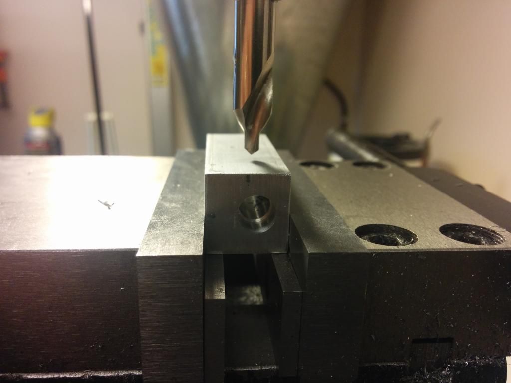

Next was time to drill the ports.  I placed the part in the mill with the valve passage down low.  This is the side that mates with the cylinder, and it makes sense the passage is further away so the mechanism clears the cylinder as it does its work.  I centered the part on the Y axis, located the end with the 7mm recess hole (the "working" end), and then located down X to the right position.  Fortunately, I had jotted down my conversions when I made the cylinder so I knew that this hole should be 0.625" from this end, and the next hole is 0.472" down the X axis.  I've been jotting these numbers, and even my conversions to full dial rotations plus extra ticks (remember I don't have a DRO), and that helped a lot here.
Here I skipped some photos to show the second port.  Note that the printing on the metal mates with the cylinder for orientation for future photos.
And here it is lined up with the cylinder.  Looks like a match!   Note that I picked a slightly large starter drill, which is why the holes in the valve chest look like that.  I decided it was close enough, and the next size smaller is quite a bit smaller.  It still constricts to 3mm (a #31 drill) for what that's worth.
Next I rotated the chest, keeping the working end to the right as in the previous photo.  I'll be drilling exhaust ports next.  These are spaced wider than the ports into the cylinder.
I ALMOST screwed up!  I left the part centered but at the last moment realized that the valve passage is now closer to the fixed jaw of the vice.  Doh!  Fortunately I looked down the end and noticed this.  Here I am locating the center which is 6.35mm from the fixed-jaw edge (rather than 8mm on center) and this is followed by a pic that shows it corrected.  These holes are 4mm so I used a #21 drill bit.

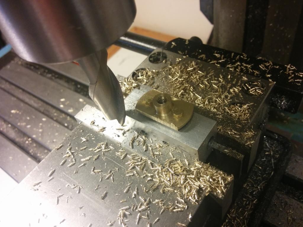

The Air Connection
This part looks very similar to the valve rod guide, and I made it pretty much the same.  Here's the plan for it.
I decided I'd make the part as shown, but I'd also drill and tap it for 10-32 threads so I could add this fitting that I've used with my previous three engines.  The passage through this fitting is a bit larger than 2.3mm so I hope it will deliver enough air.  It's very convenient with the quick disconnect feature.
I didn't happen to have any brass bar stock 1 inch wide, but I did have some 1 inch rod so I started with that.   I faced it, turned it down to the 8mm outside diameter which is a purely decorative measurement, drilled it through with a #39 drill for the 2.5mm hole, and then tapped it for 10-32 threads.
I tested the quick disconnect fitting and it worked fine.
I parted it off, then flipped it around and turned down the protrusion that fits into the valve chest.  It needed a little cleanup, which it got.  For the cleanup, I applied some layout dye because I had already gotten a nice fit and I wanted to see easily if I was skimming off any additional material.  I didn't bother trying to get a crisp shoulder.  Instead, I decided to apply a slight chamfer to the valve chest to make clearance for it (not shown).
The fit was good.
Next I moved it to the mill and centered the chuck on it by chucking the fitting.
Then I drilled and threaded the mounting holes.  I decided to use 3-48 "bolts" for this.  I threaded entirely by hand as I did with the valve rod guide even though these threads were slightly bigger.
Now I could screw it down with a temp screw.  Previously I held it by hand, though it was snug in the valve chest, but now I couldn't let it move.
I drilled and tapped the other side, and then tried the real bolts.  Looked good, though isn't the right shape yet.
I found a washer that fit underneath.  I'll used this to space it away from the valve chest and milled away a bunch of the material.  I didn't get fancy and try to mill diagonals, though, although I suppose I could have tried.
I machined a filing button to fit over the 8mm diameter side.  Since this side is tapped, I'll simply attach it with a 10-32 screw.  Well, a nice plan, but I found my screws were all relatively long so I had to get creative with a pile of washers.  It worked ok.
I made a single filing button for one of the other holes.  There wasn't room on the top side for it, so I attached it on the back side.  The screw head still interfered with the large filing button, so I had to turn a little relief it that button.  I gave this little button threads as the 3-48 nuts I had on hand were larger than the button.
With buttons on one side only, and different sides at that, I had to file carefully.  They didn't turn, nor were they hardened.  So I started filing.  Here's one side rough filed.  It only took 10 minutes...maybe less.
And here's the other side.  I see I got a little too aggressive on the first side, but it wasn't too bad.
Here's it's done, though it needs a little cleanup.  The "bad spot" is on the right low side.  It jumps out at me, unfortunately.
But it looks pretty damn good installed on the valve chest :).
Another part checked off the list.  Thanks for looking in!

Attaching the Valve Chest to the Cylinder
I wrapped up last night drilling the valve chest for attachment to the cylinder.   There's good news and there's bad news.  This post is the good news part.
The valve chest is attached with 8 screws in a 2-row of 4 screw layout.  I didn't want to mess this up.  I also wanted a reliable process for position and depth since I don't have a DRO.  In particular, my mill is HORRIBLE for Z depth, so I need to resort to a DI always.  I thought I'd try to setup some stops for reasonable consistency and no fuss readings.  The process went well.  Here's what I did.
I first devised a means to clamp the valve chest and cylinder together.  This looked like it would work.  I had paper on the left side which is hard to see in this photo.  Is paper needed on both sides?
I disassembled the clamp, painted the top of the valve chest with layout dye and scratched in the layout with my caliper, then clamped it up again.  I haven't been doing layouts like this lately, but since I'm using dials and these parts have a lot of work in them, I thought it best as extra assist against screwups.
I planned to use 2-56 screws that are 3/4" long.  That means they'll only grip with 1/8" into the cylinder.  I decided to drill 3/8" into the cylinder in case I wanted to go with slightly longer screws.  That means using a #50 drill for the hole all the way into the cylinder, and then opening it up with a clearance hole with a #43 drill only in the valve chest.  I'd need to switch drill bits, so if I'm using a stop I'd need a way to replace a bit reasonably accurately.  I found a length of aluminum rod to use for this purpose as shown in the picture.
Next, I brought down the drill with the mill powered off so it just touched the cylinder.  Note that I've removed the valve chest.  This is the depth of the valve chest and is where I want to stop the larger #43 drill.  In the following photo I show that I set the stop with a block of 3/8" aluminum.  The working theory is that if I drill to the aluminum block I will drill completely through the valve chest and reach the top of the cylinder.  If I remove the aluminum block I will drill 3/8" deep into the cylinder.
Now I need to locate the position of the first bolt.  I wrote relative distances, including turns of the dials, on a nearby piece of paper.  Trying to reduce the screwups.  Fortunately, even with the stop in place I was able to reach the top of the valve chest in order to use the starter drill shown.   Lucky me.
It was a matter of repeating 8 times:  a) locate to position along X with Y locked;  b) use starter drill;  c) insert #50 drill using aluminum rod spacer with mill head completely raised; d) drill to full stop depth (into cylinder); e) insert #43 drill using aluminum rod spacer with mill head completely raised; f) drill to depth using extra spacer block.   It was step f that had me worried.  But somehow I never forgot that extra spacer block.
I repeated this for the first series of holes down the X axis and kept the Y locked.
Then I had to crank it back and account for backlash.  Remember I'm using dials.  I lowered the drill into the first hole with the mill powered off to double check. It was aligned.
It occurred to me before I started moving down X that I needed to adjust for backlash again because I was changing direction.  I lowered the bit back into the newly drilled hole and turned the dial to get rid of it and reset to zero.  All was well and I finished the second row of holes.  Maybe it would have been best to do the second row of holes in reverse.  The layout lines where helpful to give me confidence I was hitting the right spots.
With all the holes drilled, I removed the clamp and valve chest and tapped all the holes by hand.  This was actually very easy.  There is very little resistance to a 2-56 tap in aluminum.  I had to be careful not to strip any threads I created.  While I was at it, I measured the hole depths and they varied by only 6 thousandths.  I was surprised by that.
I'll switch to hex head bolts, but for now I screwed it on with these screws.
