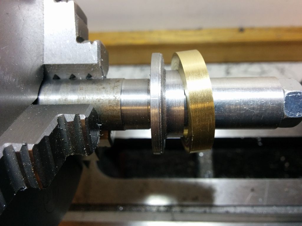

The Eccentric
This looked like a particularly fun part to make, and this turned out to be true.   I didn't get a nice consecutive set of hours in the shop, but with a little time here and there over the past few days I managed to get it done.
Its design is a sandwich, much like an Oreo cookie where the "good stuff" is a ring that is able to wobble back and forth without spinning while the outer parts of the cookie are attached to the shaft.  I was thinking it would look particularly snazzy if the ring was made of brass, so this is where I started the journey.
This bit of brass is a little too large, but was close enough.  I had parted it from the flywheel during my pipsqueak engine of a few months back.  That seems so long ago now.  I faced it and drilled a 5/16 inch hole to fit the arbor that I used for turning the flywheel.  The inside of the ring will be bored out later.
On the arbor I was able to turn it down to 30mm diameter.  The thicknesses and diameters aren't that important, but I stuck to the original dimensions anyway.  I didn't want to find I was wrong about this the hard way.
While still on the arbor, I cleaned up the sides and narrowed it to 6mm.  While doing this that darn brass managed to grab and gouge a little.  Grrr.  But still, it will be sandwiched so I decided not to worry about that too much.  I only needed to clean up the sides for part of the diameter because I'll be boring it out to 20mm inside.
After drilling to 9/16 inch (my largest bit) I switched to a boring bar and finished it to approximately 20mm.  I simply used a ruler for most of the measurements, but then switched to a caliper as I neared the end.  I still haven't purchased any tools to measure an inside bore like this.  But this is why I turned the ring first -- I will turn the next part to fit the ring.
And here's the ring.
Now for the outside parts.  The next part will be turned to 30mm diameter also and turned down to fit the ring I just made.  It's CRS (bright) steel that started as 1.25 inch diameter.  I ended up placing it in the inner part of the outer jaws (how else do you say that?).  I probably could have used inner jaws and spaced it out, but this setup was nice and solid -- though I had to worry about those outer jaws spinning around.  I faced it on both sides and got it to final thickness of 8mm.
Again, I drilled 5/16 inch to fit the arbor.  The arbor was a useful thing to make for this project!  I turned it down to 30mm diameter.
Next I turned down 6mm of the thickness.  The goal was to get a nice slip fit for the brass ring I made earlier.  I measured until I got close to 20mm, and then I started using the ring to test as I took off 5 thousandths at a time.
Here I was very close as the ring almost fits.  One more pass.
I got a fit.  Now I needed to clean up the shoulder as it was pretty sloppy.  That's shown in the second photo.
Then I took it off the arbor, chucked it, and bored it to 16mm.  Again, I drilled to 9/16 inch and finished with the boring bar.
And here is the pair.
I'll finish logging this one in another post.   The other half of the cookie fits inside this 16mm bore and has the offset for mounting on the shaft.
Thanks for looking in!

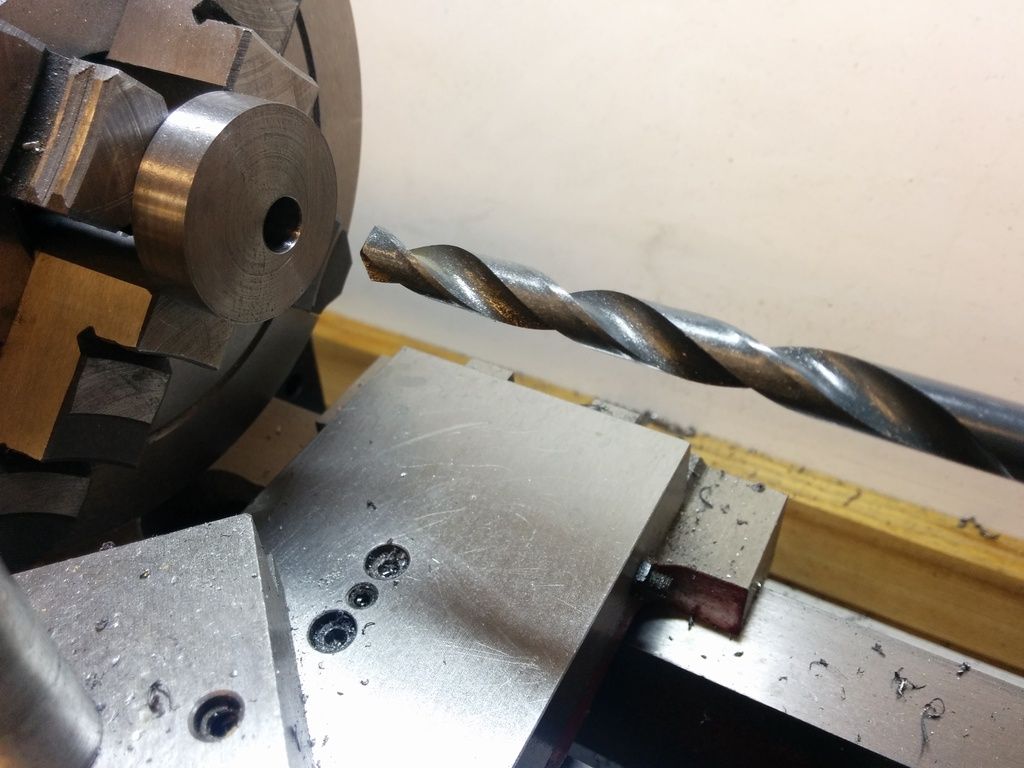

In the last post I was building the eccentric which is an Oreo cookie-like arrangement of three parts that fit together.  The good stuff in the middle is a ring that will be drilled and tapped for the eccentric push rod that operates the valve.  In that last post I made the ring out of brass, for the sex appeal of course, and made the simple side of bright steel.   Here I make the other side which includes the eccentric offset.
As with the other side, I started with a hunk of 1.25 inch CRS (bright) steel.  This one is a bit longer as the finished part will be 15mm thick.  I faced both sides roughly and then needed to chuck it with enough material exposed to turn down an 8mm section.  Perhaps I should have used a longer length and parted it off, but instead I decided to give this a try.  I had to space it out and keep it square so I used (literally) my square and couple parallels as reasonably accurate spacers.  Of course I had the power off while getting it setup!  I was a little concerned about the short grip, but I was able to really tighten it down because the other end will be turned and any marks will be long gone before I'm done.
As before I turned it down, but this time was shooting for 16mm to fit the other CRS part I made earlier.  I was careful not to overshoot this time.  I stopped as it got real close to fitting (the second photo).
Now I had to go real slow.  I followed a process I've used a few times on this engine.  First turn a portion of the length down an extra thousandth and test for a fit.  If it didn't fit, I'd finish the pass and repeat.  Eventually the other part fits the portion and I know the rest (about 2/3rd of the length) is one thousandth over.   Unlike the brass ring which was ok to be a sloppy slip fit, I really wanted this part to be a press fit with the other part.   Worse case if I screwed up I could glue it up with loctite, but my goal was to press.  And I didn't want to press too thick a fit because the material needs to go somewhere and I didn't want the brass ring, which fits between these two parts, to seize up in the space.  So it was careful work here.
As I've often done on this engine, I finished up the shoulder with my parting tool.  It was ok to run a little extra deep because the inside of this part won't be seen.  I probably should grind an HSS cutter for this work...but the parting tool worked ok.
Looking A-OK.  But I can't press it now, of course.
Now I flipped it around to do the eccentric part.  The first step, though, is to turn the diameter to 30mm to match the other half of the Oreo cookie.  We wouldn't want the sides to mismatch, would we?  I used my 3-jaw for this since there is no offset, and of course the 3-jaw chuck was already in the lathe.
It's time for the eccentric turning and I had to switch to my 4-jaw chuck.  It's a 5 inch chuck and a little big for this lathe, but working good so far.  I centered it first, and then I pushed it for a 3.5mm offset.  That's 138 thousandths of an inch, so my dial indicator ended up at a full turn and 38 thousandths extra (second photo).
Next I drilled for the 5/16 inch shaft I'm using.  I thought drilling was best as a start so I can easily see it was offset the way it should be.  The shaft actually measures at about 0.306 rather than 0.313, so I drilled to an N bit and then reamed it to 0.3115.  I figured it wouldn't hurt to be closer in diameter because the 5/16 inch drill bit will probably go oversize.  I'm sure drilling would have been fine.   This was a "what the heck" thing:).
And now I could check the fit using the engine itself.  Power is off of course.
Now I started turning down the outer edge.  It was already located correctly so this was just a matter of dealing with an intermittent cut until I got down to 16mm, which was a fairly arbitrary measurement anyway.  That is, it looks nice.
And here are the three parts now.  The new one on the right should press fit inside the one on the left.
The new part needs a set screw to clamp onto the shaft.  I used a 3/16 inch end mill to make a flat, then drilled and tapped as shown in these photos.  I had to use an undersized starter drill to avoid running into the side of the part.  I tapped it using an 8-32 set screw to match the flywheel.
Before pressing the assembly together, I needed to drill and tap the brass ring to accept the eccentric rod which I haven't created yet.  I decided to go with a 4-40 thread, even though 5-40 would be better.  I don't have 5-40 taps and dies yet.  They don't seem to be very common, though I do plan to buy a set soon.  I plan to use a 1/8 inch rod which would be a perfect fit for a #5.  But 4-40 should work fine.
Now for the big moment.  It's time to press the assembly together.  I used my mill vise and as I turned the vise crank I kept spinning the brass ring around to make sure it stayed loose.  It did.  If it hadn't, my plan was to stop quickly and pull it apart before I was at the point of no return.  Well, that was the plan...no proof it would work.
Perhaps I should have made the spacing between the outsides a little tighter, but I didn't want to trap the brass ring too tight.  And I really think the brass make it look nice.
And here it is installed on the engine.   This baby is wanting to run pretty soon now!
