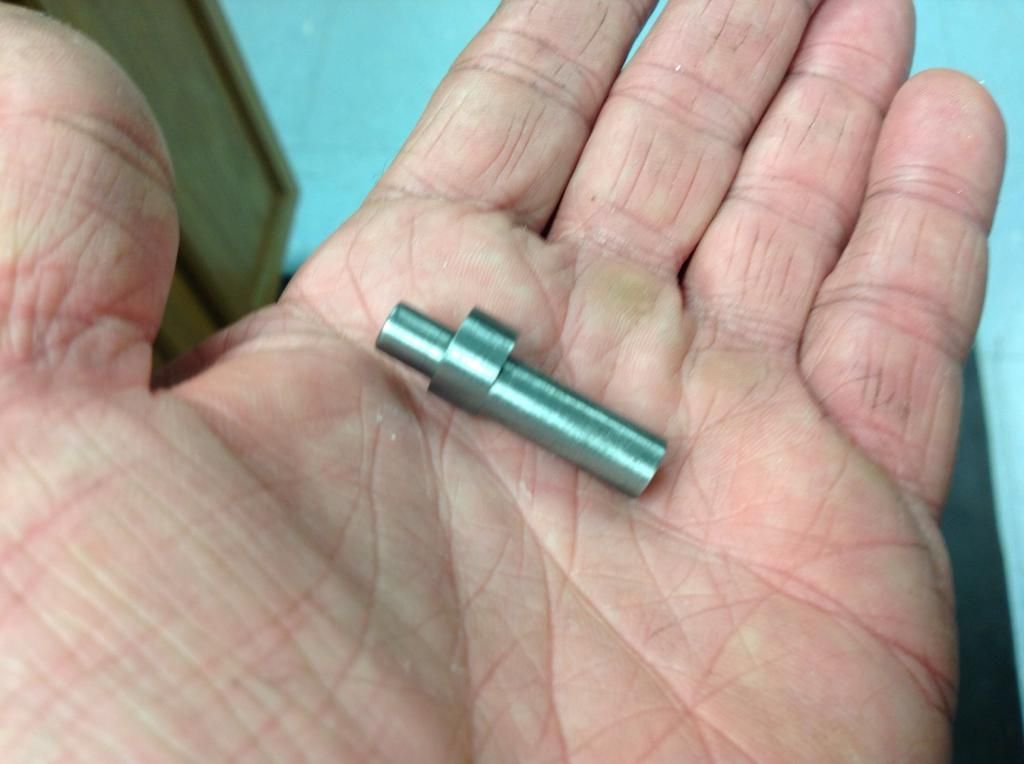

Thanks for all the information guys and for looking in. Phil I don't think I will make the threading clutch because I don't feel that I do that much single point threading to justify the time to build it. Maybe in the future and I do have the plans for it.
On another note I did complete the tool. Most of the parts left were basic turning except the eccentric for the cam. I set it up in the four jaw Chuck and offset it .125" to turn the .3125" diameter shaft. Setting up in the photo.
The cram shaft completed. One side has .25 shaft and .3125 on the opposite side. I had to case harden the camshaft and the pressure plate
Next are the photos of the tool in use. Works a treat.
The tool completed.
This tool was a very enjoyable project to build and thanks for looking.
