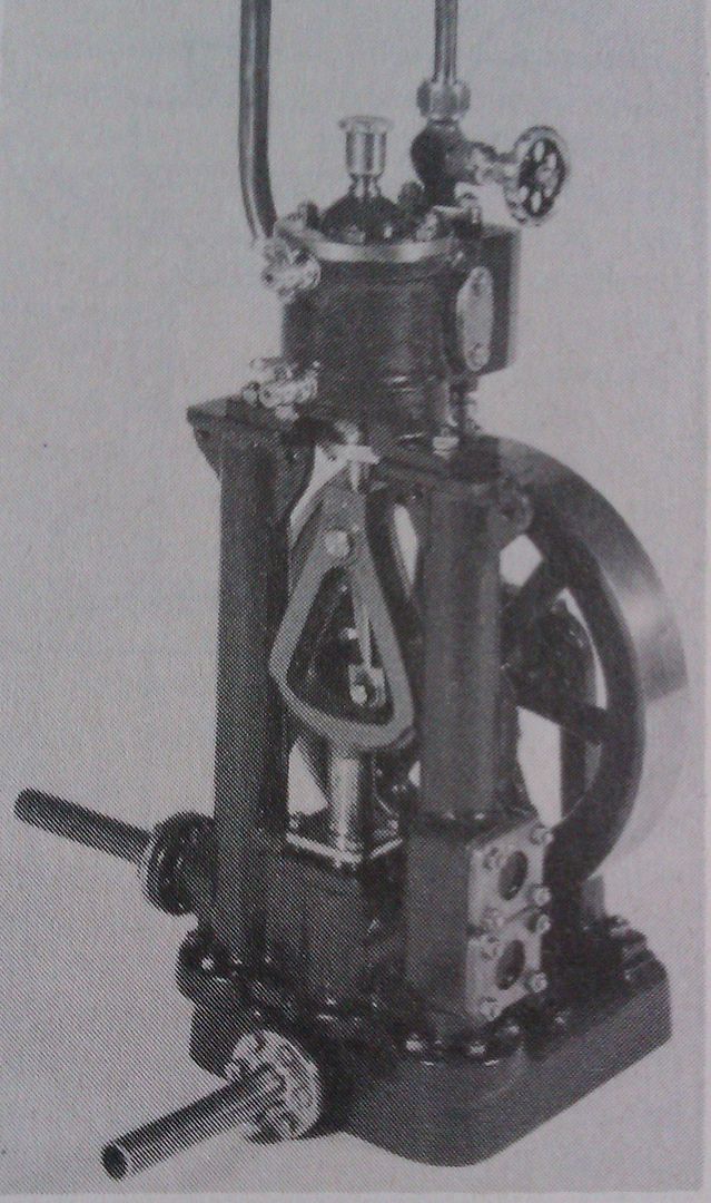

These pumps were made by a company named after the founder John Cameron whose works were in Manchester, England and came in a range of sizes from about 6ft tall to near 20ft. in single, twin and tandem cylinder configurations. They were used as boiler feed pumps and for other general pumping duties. I don't have any good photos of the particular engine that this one is said to be based on but it looks to be in the region of 8ft tall so my model at 16" high puts it at 1/6th scale.
This is a photo of one made from the kit that appeared in Model Engineer magazine when the castings were introduced

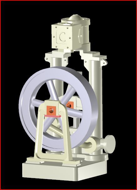

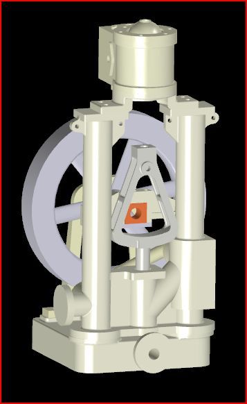

I have redrawn most of the larger parts not just to get the revised sizes but also I find that drawing it out helps me think through how each piece can be fabricated.  I will be using a wide mix of construction methods - welding, silver soldering, cutting from solid and screw& glue to name a few. It is quite a big model but there is no reason to stop anyone following along and making it to the original size which only had a 4" dia flywheel or anything between the two. These are a couple of screen shots of the general arrangement, I have not included some of the smaller parts as they will just be doubled up from the originals.

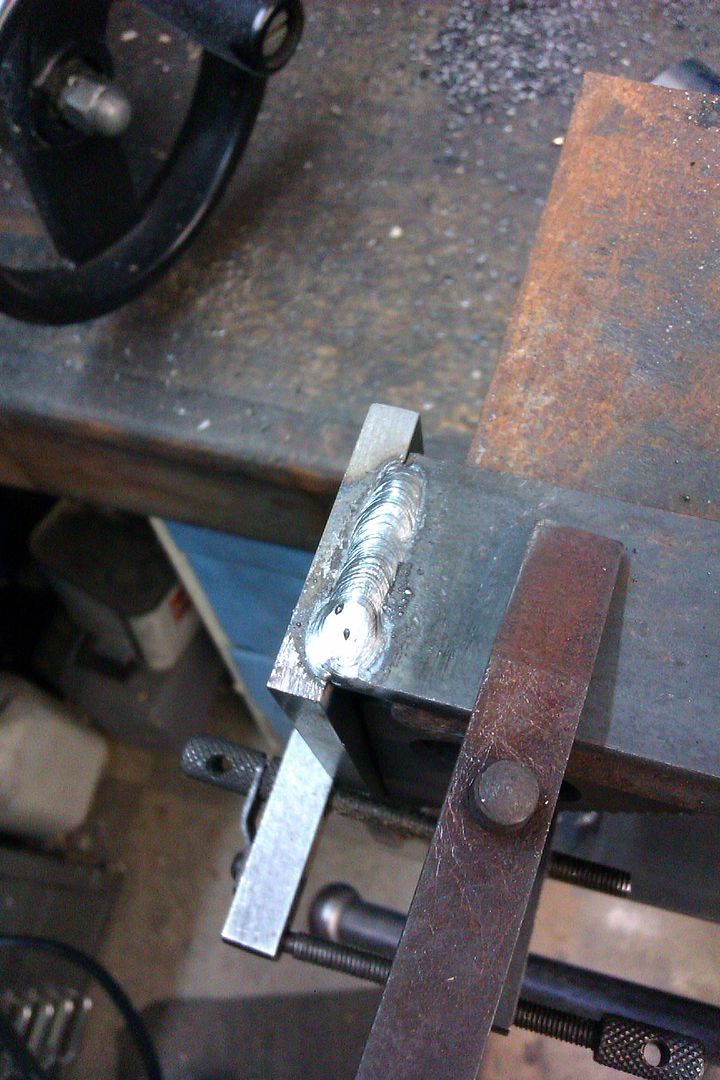

My welding is not brilliant but as my life does not depend on it I'm happy to use it to join parts for models, here the 1/4" back and 3mm sides are being welded.

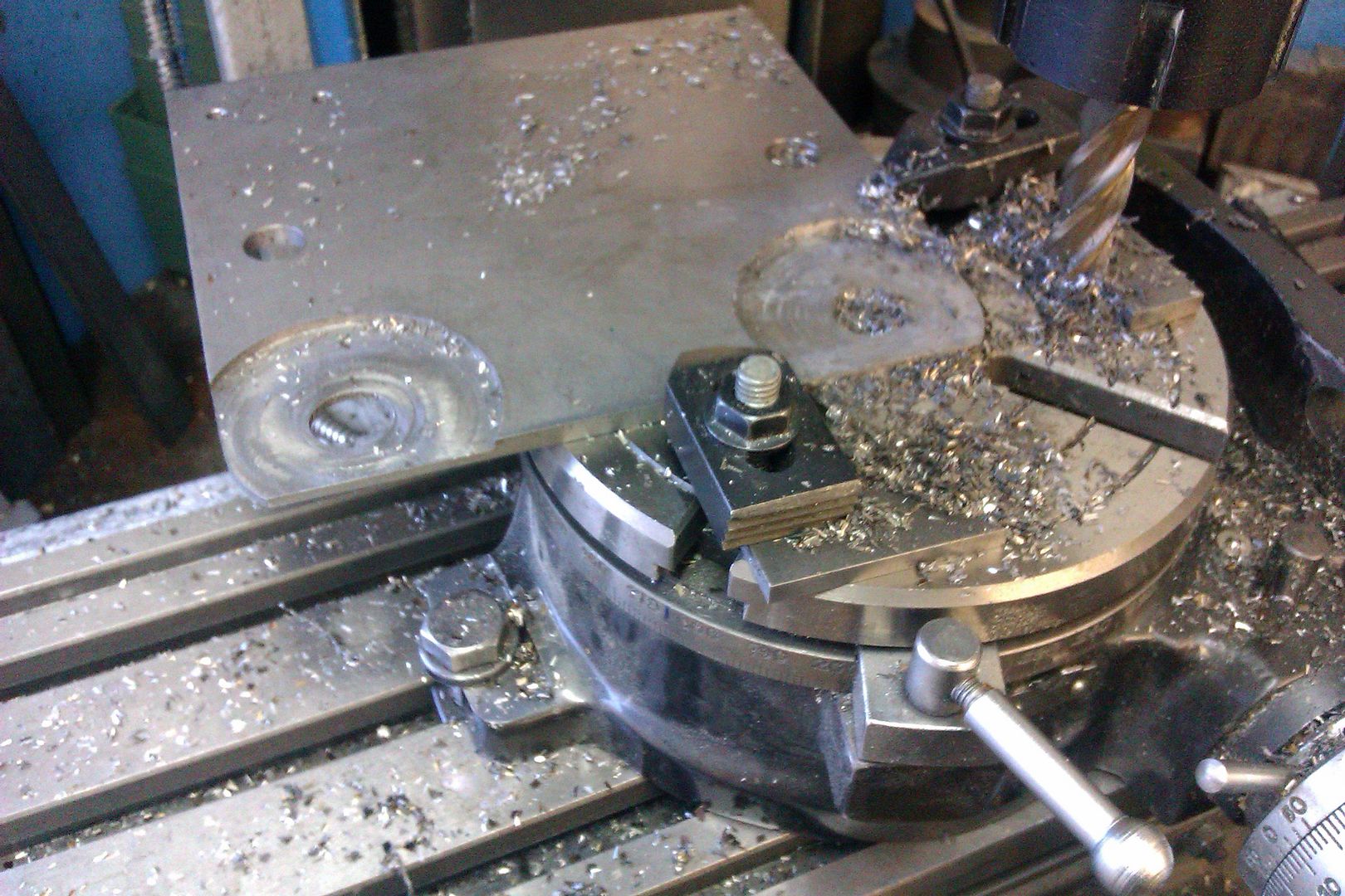

I then put some holes in the top plate to locate the column flanges, mounting bosses and pedestal base bosses
The areas where the column flanges go were also recessed on the rotary table.
The top could now be welded to the sides and the joints tidied up a bit.

OK, I'm on board.  Actually the welds don't look half bad.  Little tip if you want it,  pay closer attention to the edges of the weld puddle and less towards the end of the rod. If you watch the edges of your puddle,  you'll very quickly learn how to manipulate the rod to fill where you want it to without ever looking at the end of the rod.  I like this fab stuff  :ThumbsUp:

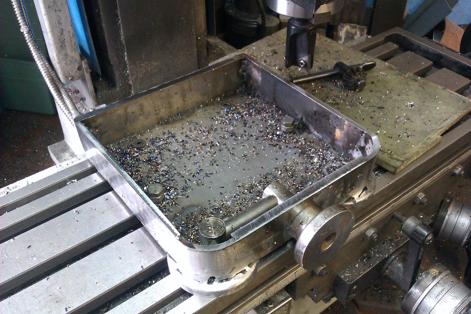

I then gave the top a quick skim to bring all the parts to one level
Then the same to the underside. You can also see how the water gets from the inlet flange to the botton of the column in this shot.
The "casting" was then set true on the mill and the various holes drilled and tapped, mostly 2BA but a couple of 1/4BSF at the rear.
Back onto the angle plates and the inlet flange was skimmed on its face and around the flange
With all the metal work now done a fillet of body filler was added to all the internal corners and rubbed down once hard.
All that then remained was to apply a quick coat of primer to protect the work and also highlight any areas that may want a second fill.
