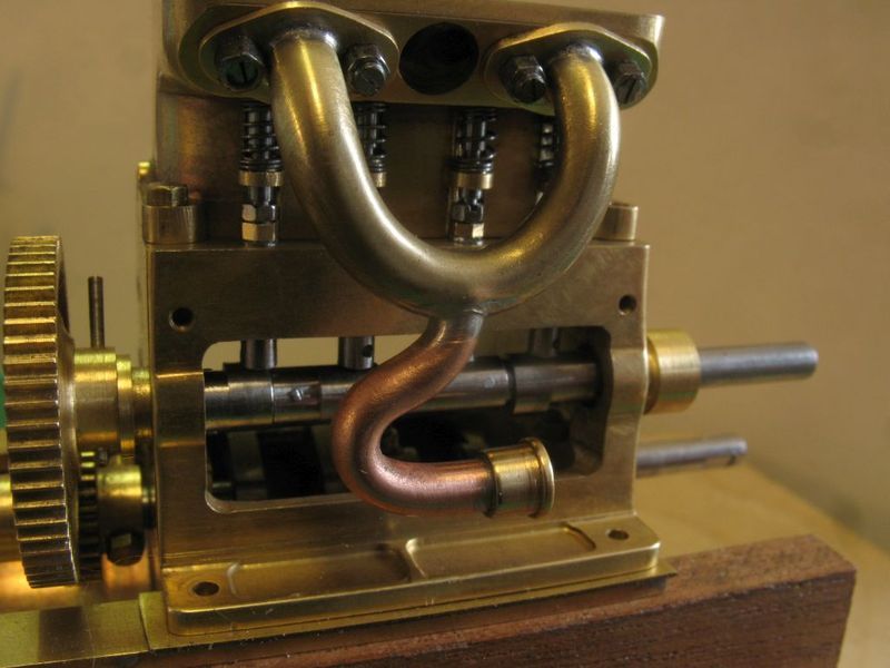

Thanks for the support and for checking out my little engine. I did have to remake the inlet manifold to make it a little shorter to raise the bottom of the loop, so I ended up making new flanges as well. the brass drop to the carb is threaded 6x80

Today I received a great photo from Roger showing me the real configuration of the manifold. i spent most of the morning learning how to bend eve tighter loops in the tubing.
After some time I got it pretty close.
My first go at the new shape looked pretty good
So I went for some lunch and ruminated over it, and redid the bottom part and added the new threaded end. Yesterday I made a #5x 64 tap which I used for the threads in the end ready for the carb.
Now I can get on with the carb.

Dave here is the start of the carb.
The nut on the connection to the manifold will act like a lock nut so that when the carb is wound in then the nut can lock it in the vertical position/

Paul yes it is there are a few bits to add yet, the fuel vapor will flow through the carb from the vapor tank right below under the floor boards, I am hoping to use the carb as the air mix, but I might have to do it differently. and add the air at the tank.
