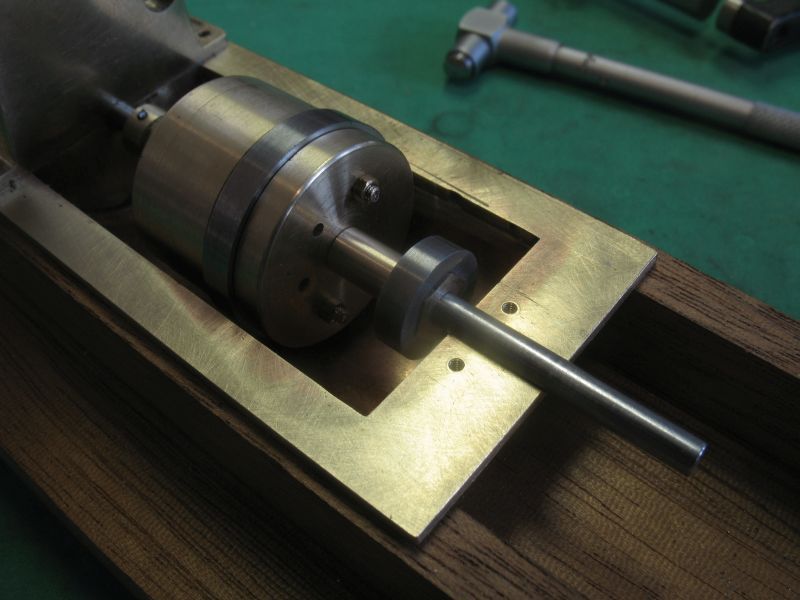

In order for the gearbox to be able to lock so that the prop rotates forward there is a clutch that is splined, I have been wracking my brains working at finding a way to make a small spline. This morning as I woke up it hit me.
Yup the trusty old allen head cap screw has a negative hex to accept the hex key, I matched up a 5/16 cap screw with some 1/4 inch hex brass. the steel collar will revolve in the base of the forward/reverse lever and will move about 1/64 to clamp the prop shaft to the gearbox causing the forward motion. the hex part will be pinned to the prop shaft, and a loose clamping collar will be inserted between the hex collar and the casing of the gearbox, when the lever is pulled back the hex collar will move forward clamping the case and loose collar hence locking the case to the prop-shaft
The revers is accomplished by clamping the gearbox inside a steel band which was made from some steel rings turned up and silver soldered together. As the gearbox is clamped the splined collar also releases the loose clamping collar allowing the gears inside to impart the reverse
When I cut the slot on the top of the band it automatically sprung to a smaller diameter which works in my favour because in order to open the band a wedge has to slide forward, this wedge is connected to the forward reverse lever.

Very nice Mike,
Another source for a small spline is a cheep socket. I was wondering how the controls on the reverse was going to work nifty solution. Did the original reverse gear work with a similar method?
Dan

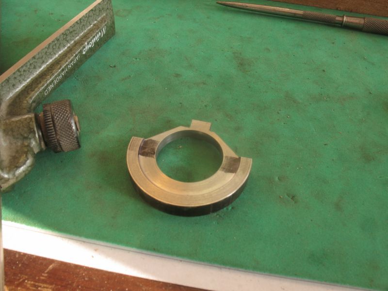

« Reply #25 on: December 17, 2014, 10:15:32 PM »
I realized that the tabs were too narrow to hold the clamp ring so made a new one from a solid ring which required a fair bit of milling and hand filing.
Also made a flywheel from some free machining bar stock.
Getting the clamping to work smoothly has required a lot of fiddling with the diameter and the flexing of the clamp ring.

« Reply #26 on: December 18, 2014, 04:11:01 PM »
I worked on the clutch yesterday, first I made a hex broach to form a 3/16 hex spline in some brass stock the end of the full end broach was reduced so that as the broach was pushed through I could part off the discs.
next a few thin plates of mild steel for the slip rings these were drilled first then parted off the steel discs are .630" x .020" thick the brass ones .345" x .030" thick. the steel discs with be fixed to the gearbox and the brass disc will be fixed to the prop shaft via the hex collar on the shaft the large collar will act as the pushing element
test assembly
