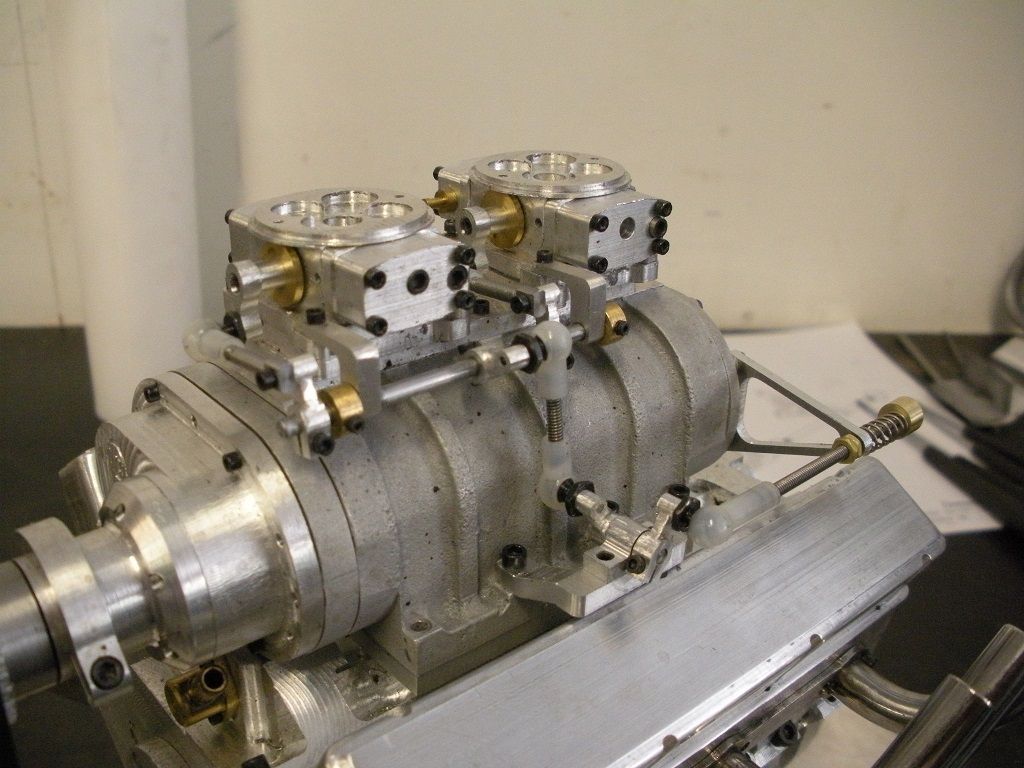

Another one from the same book.
There's no indication in the patent of how the author was going to constrain the push rod while it slide side to side :)
ISTR Chuck(?) had built a model with a similar eccentric face cam ????
Re: Another gear-less cam mechanism
« Reply #12 on: November 23, 2014, 04:22:15 PM »
That is very similar to what is used on the Pacific engine and it's relatives (Union, Regan, Globe, etc.). The difference is there is a shoe that runs in the track, the shoe is on a swing arm that moves the valve lifter over the cam on one revolution and away on the next.
