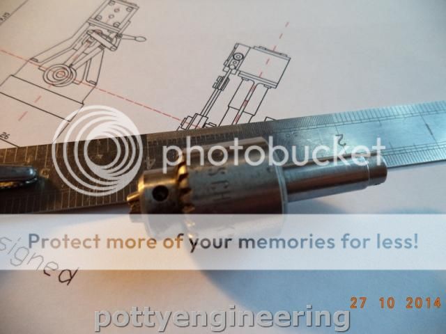

Jo do you me what I call a tapping stand like this.

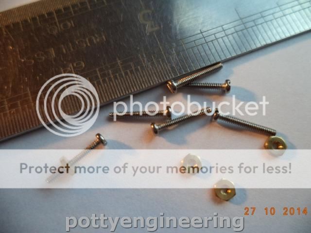

And thanks for the tips about tapping small holes its something I've been concerned about, I took delivery of the bolts and nuts on Saturday and it comes as quite a shock at just how small they are I guess pound for pound they cost as much as gold  :)
I have a small chuck that I will press into use for tapping not to sure how I will use it yet I guess that is something I will experiment with.
I'm waiting delivery of some taps and dies I've ordered a packet of ten taps the price is quite reasonable but I'm not sure on the quality only time will tell on that one. I've also ordered a set of ER16 collets with a straight shank holder as I reason this will give me more visibility when I'm milling with the small cutters.

I do most of my tapping immediately after drilling too.  After all, you'll never achieve better alignment to the hole you just drilled and the mill makes a wonderful, rock-solid, deep-throat UPT.
If you're working with tiny taps consider making free-wheeling guided tap holders like the ones shown on the left in the first picture here...
http://www.modelenginemaker.com/index.php/topic,274.0.html
Note that these, unlike the larger ones on the right, do not have handles.  This provides a good limit on the torque one can apply and the guide rod prevents bending the tap.

Stew, that is the sort of thing  :ThumbsUp: I found the small chuck on the UPT good for the larger taps, with a tee handle fitted.
Against my better judgement the cut down Ellipse pin chuck with an extended shaft and knurled top has proven best for tapping all the way down to 12BA.
The smallest tap holder which is nothing more than a piece of tube with a 10BA screw in the side clamping the tap has not been used yet.
