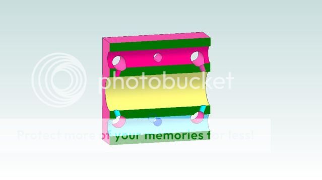

Cap, I've also been harboring some ideas about this one... for quite a while.
Like you, I've also come to the conclusion that for a small one, some of the details will have to be dropped, and an Elmer-like design will work well with barstock.
The porting through the cylinder block could be tricky to figure out.
One option would be to make it from two pieces of brass - so that the steam passages can be milled on top and a block soldered over to cover them again.
Alternatively, one could drill them all and use plugs like Elmer did frequently to seal up the unnecessary holes.  Then the block could be made from a single block of just about any material.
I don't think making the rotary valves will be too much of a problem.
Simplifying the valve gear itself and getting that to work might be the most difficult part; and I'd have to agree that it might be feasible to completely ignore the trips (or just fit optional dummy ones) for a small scale version.
Kind regards, Arnold

This is a section view through the cylinder block
.  It presents no production problems that I can see.  Another option would be to have the main steam and exhaust galleries milled as closed end slots from top and bottom and sealed with a bolt on plate, much like Arnolds idea except the block is only one piece.  That might be better than the drilled galleries that are shown which will have to be sealed at the ends which might interfere with the cylinder heads.
Jerry
