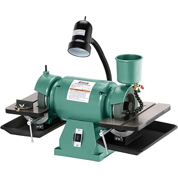

You guys in the USA are lucky, these are freely available over there! I've not seen anything like it over here.  :(
http://www.grizzly.com/products/Heavy-Duty-Tool-Grinder/H7762
Looks ideal to me?  :naughty:

Looking great! I've been threatening to build one but these damn engine builds keep getting in the way.
There is a 5 part YouTube on the HF grinder. Review and mods needed to make it work well.
I tried pasting the link but keep getting an invalid link message.
YouTube search will get you there.
