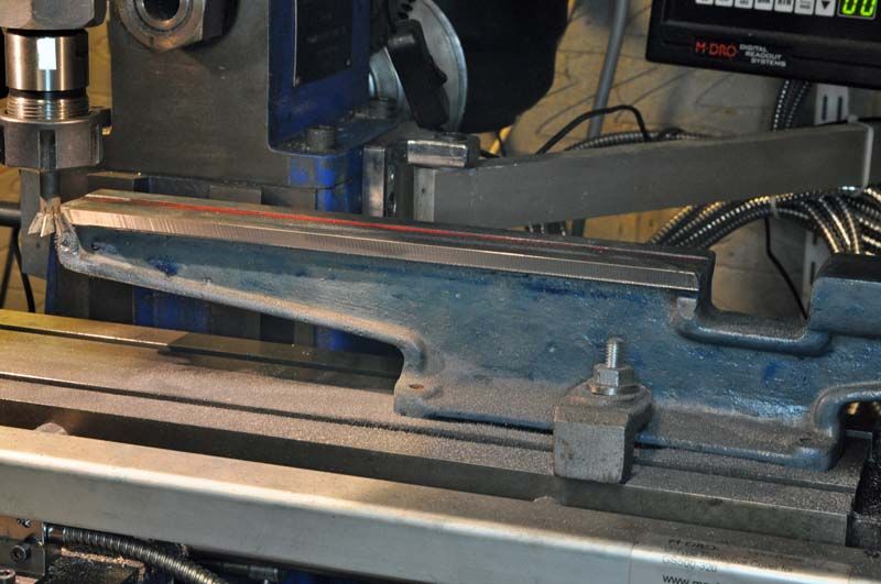

I've not really done much scraping before so this will be a learning experience.  I bought a far eastern scraper some time ago but have singularly failed to get any sort of edge on it to cut cast iron - I suspect it needs re-hardening.  I have a small random assortment of tungsten carbide tips so I put this scraper together:
It's not an ideal shape, I think more curve would be better but it seemed to work OK.  You can also see my surface plate in the picture.  This is planed but not ground.  However, I can't feel the ridges with my finger tips and a DTI registers no peaks or troughs.  Pictures of the scraping will be a bit thin on the ground - there was a lot of blue about which I was reluctant to get all over the camera.
The first task was to get the top of the bed flat.  After about 3 hours I managed this, there was a distinct hump in the middle which I could feel as a tight spot when traversing the saddle.
Next I flattened the nearside V which is the surface that the non gib side of the saddle rubs against.  I have a pair of machined parallels which are 1 x 3/4 x 9".  After testing with blue on the surface plate I found a good edge to use as a straight edge.  (Surprisingly good actually, I could almost lift up the plate with the parallel with a bit of blue between them - well, that's what it felt like anyway).  Another 3 hours or so and I had this:
I found the whole operation pleasantly satisfying, just had to remember not to keep rubbing my nose with blue fingers.
The next operation was to bring the outer V parallel with the inner.  This set up showed that there was a taper of about 0.006" over the length of the bed.  That's a lot of scraping :o . I decided to mill this off.
So, first I set the lathe bed  down on the parallels and machined the feet.
Then turned the bed over and used a dovetail cutter.  The forces are not really working in my favour here - you can see  the chatter marks which aren't quite as bad as they look, it's about 0.0005" between peaks and troughs
The dovetail cutter wasn't quite big enough to give the full depth so I had to remove the ridge with a file.  Alternating between the DTI and the straight edge I manged to get the 2 Vs parallel within 0.0005".
The little saddle was a rather more difficult prospect to scrape and I elected to just touch this up with the dovetail mill
The contact area was much improved (although the blue is a bit thick in this photo)

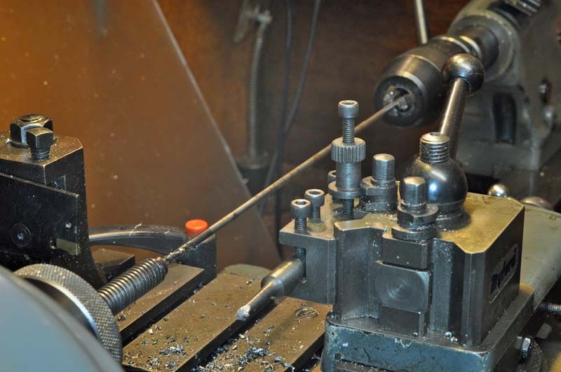

The tailstock was not drilled through which I find a bit surprising since you can't use a knockout bar to remove the tooling.  It's a deep hole and very fortunately I have a 9/64" drill brazed to a rod that's left over from my bagpipe making attempt.  So I drilled as deep as I could with conventional drills and finished off with the special.  I can now use a 1/8" knock out bar.
The tailstock barrel had suffered some damage where the barrel rotation preventing stud had broken away.  JBWeld to the rescue!  I have one piece of PTFE which fortuitously is 1/2" OD.  Nothing sticks to PTFE (well it will but you have to etch with Hydrofluoric Acid)
I also made a couple of better looking hand screws for manipulating the tailstock

The new spindle was mounted in the fixed steady, I'd used a Sharpie to mark where the position of the bearings so that the steady didn't score my freshly lapped surfaces.
I parted off the surplus end, drilled as much of the 9/16" through hole that I could manage from this end and bored the recess for the worm.
It remains to be seen whether the Loctite can cope with the torque of turning the lead screw.
I then remounted the the spindle in the collet and completed the through hole from this end.  I set up the topslide to cut the short 0 MT.  This shows a commercial full 0MT centre held between male and female centres.  Having used the DTI to set the topslide
I bored the taper and finished off with a reamer.
Trial assembly seems OK,
I've now glued in the worm so I'll wait a couple of days for the Loctite to go off before fiddling with it any more.

This turned up in the post today.  I saw it on ebay and couldn't resist.
Looks like somebody has had a go (and failed) at repairing the Tee slot with sifbronze or something similar.  I'm going to have to think about this  :thinking:
Cheers,
Rod

Same as one of mine Rod, good find. I don't know how much use mine will get, but it's certainly nice to add to a well rounded kit.
Perhaps you could mill away the central T cap ( for want of a better description), and screw/glue on a suitable piece of steel.
Cheers, Hugh.

3 screws and 2 pins in a flat piece of steel or Iron...Take a fly cut over the whole face when your done......
Done and dusted.

Screwing and gluing had occurred to me but I hadn't thought of pinning as well.  I guess closely fitted pins will stop any possible rotational movement.  An alternative might be to mill a tenon on the stub of the T and fit this to a slot for the new cross piece.  Or perhaps riveting right through with countersunk holes on both sides might do it.  That way the resultant repair wouldn't be obvious from the top surface after milling the whole lot flat
Thanks for your comments and helping me think about.

Colin - Here's a few more pics, hope you find them of use:
Cheers,
Rod

« Reply #70 on: July 14, 2015, 07:49:19 PM »
Rod,
Many thanks for the photos.  That's given me confirmation of some of the ideas I had in mind.  I'm not sure whether its an optical illusion or not but there looks to be more depth of metal on the saddle compared to the Cowells ME90.  How many adjustment screws are there for the saddle gib.  I was thinking I had three, but it may be the one in the middle is to lock the saddle.  Do you have the third screw or have you removed it and the hole is it covered by your bracket.  I would need to leave a small hole in centre of the bracket for an allen key to lock the saddle.  One advantage of the magnetic read heads is that I would not require the covers over the scales, which might simplify things a little.  Both the scales and read head are fully sealed
The image below shows the brackets I made for the mill.
Hopefully I can make something similar.
Thanks,
Colin
