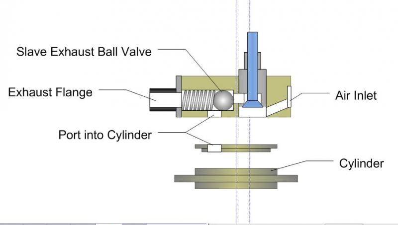

I've been stalled for several weeks on the new cylinder head design, particularly the valve and airflow configuration.  Supplying an overhead valve engine with compressed air is not particularly intuitive.
Here is a drawing of what I wound up with:

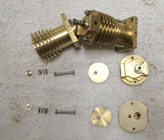

The valve cage was made separately and soldered into a 1/4" hole that goes all the way through the head.  The valve is then inserted into the cage from the bottom.  The spring, and keeper are held in place by an E-Clip.  The problem is that the hole that received the valve cage needs to be sealed on the bottom since this is where the high pressure air is admitted from the intake on the side of the head.  After trying many different approaches, I finally settled on a thin disk that will sit between the cylinder and the head, held in place by the two studs that hold the head onto the cylinder.  Here is a photo of all the different parts:
As a frame of reference, the valve heads are 3/16" diameter and the stems are 3/32" diameter.  The small hole in the disk lines up with the smaller hole in the head.  This is what admits air into the cylinder.  The ball valve is normally held to the right when the intake valve is closed.  This lets air from the cylinder port flow out the exhaust port.  When the inlet valve opens, the high pressure air pushes the ball valve to the left, closing off the exhaust port and letting the high pressure air enter the cylinder and push the piston down.

Chuck, this is quite an impressive facelift for the radial. The separate cam gears should make a nice focal point too with the engine running. I had to stare at the diagram for the valve arrangement for a while before it finally dawned on me how it will work...the diagram is great, its my brain that wasn't in gear :)
