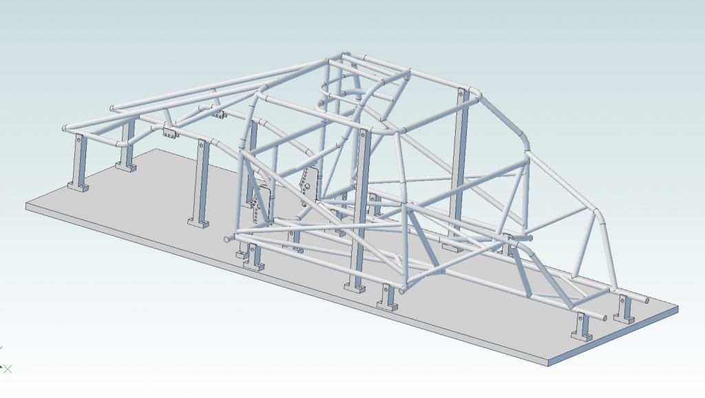

Howdy folks!
It's been many many months that I have had no shop time. That has got to change so I have been making plans for a new project. No matter where you go, or who you show your engines to, the number one question is, "are you going to put it in anything". Well I am. Over the last few months I have been drawing a S&W racing, 68-72 Chevelle chassis in one fifth scale so that the blown Demon will fit into it. I purchased drawings from George for the nine inch ford rear end. The transmission is still up in the air. After I work out the wheelie bar arrangement I plan to move forward on this 2 year project. I plan to make the build thread exclusive to this forum and one other that is RC related. Posting on 5-6 forums gets to be a little too much.
The first move will be to make a fixture on an aluminum plate 12 X 34 inches to fixture the chassis for assembly.
Once the chassis is completed I will need to make a rearend. I have never cut a gear in my life so nothing like jumping in with both feet. The ring gear will be 1.700 inches in diameter with 40 teeth. The final ratio will be 3.75:1

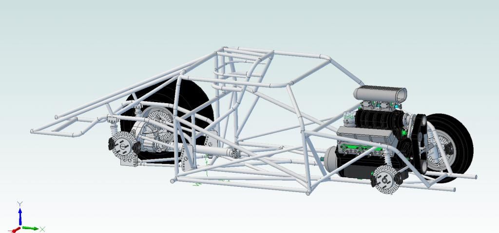

The chassis will be fitted with disk brakes. I have not decided weather they will funtion like the real ones but I might give that a whirl.
The blown Demon will be fitted. I have no plans for a trans. I can make wheels but tires will be another challenge. The body is another problem but who knows.
When I get going on this I'll post up some pictures and give regular reports.

Hi Steve a good start for an impressive project. Looking at your fixture for chassis/frame making l am missing the jigs for the important brackets like rear upper damper fixation. Are they still under construction ? I see all the jigs to guide the tubes, but no jigs for the main suspension or engine mounting points.
