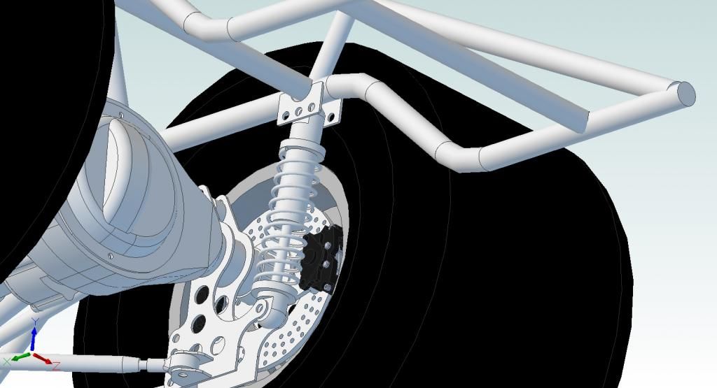

Hi Steve a good start for an impressive project. Looking at your fixture for chassis/frame making l am missing the jigs for the important brackets like rear upper damper fixation. Are they still under construction ? I see all the jigs to guide the tubes, but no jigs for the main suspension or engine mounting points.
rear upper damper fixation?  Are we talking about shock absorbers? If so that is worked out. If not you lost me.
Front suspension is a simple bracket to attach rods with heim joints. Motor mounts and trans mount will be done when I figure out what to do about the trans.

Yes Steve, I have had shock absorber in my mind. It is really a long time ago, when I have welded my last tubular frame for a real race car, but I remember very well, that I have first made all the fixtures for the suspension pick up points and engine and gearbox fixation. Later than some jigs for special tube guiding. But I am only remembering here some good old times. I am sure you will show us here an excellent piece of  craft manship in the near future. I will following along.
I figured it would be easier to just make the parts and install them than draw them. I should have no trouble after the framework is done dropping a few plumb bobs and picking up the points. The center of spindle is on the drawings as well as the center of rear axle.
Rear Shock mounting are ready to go.
